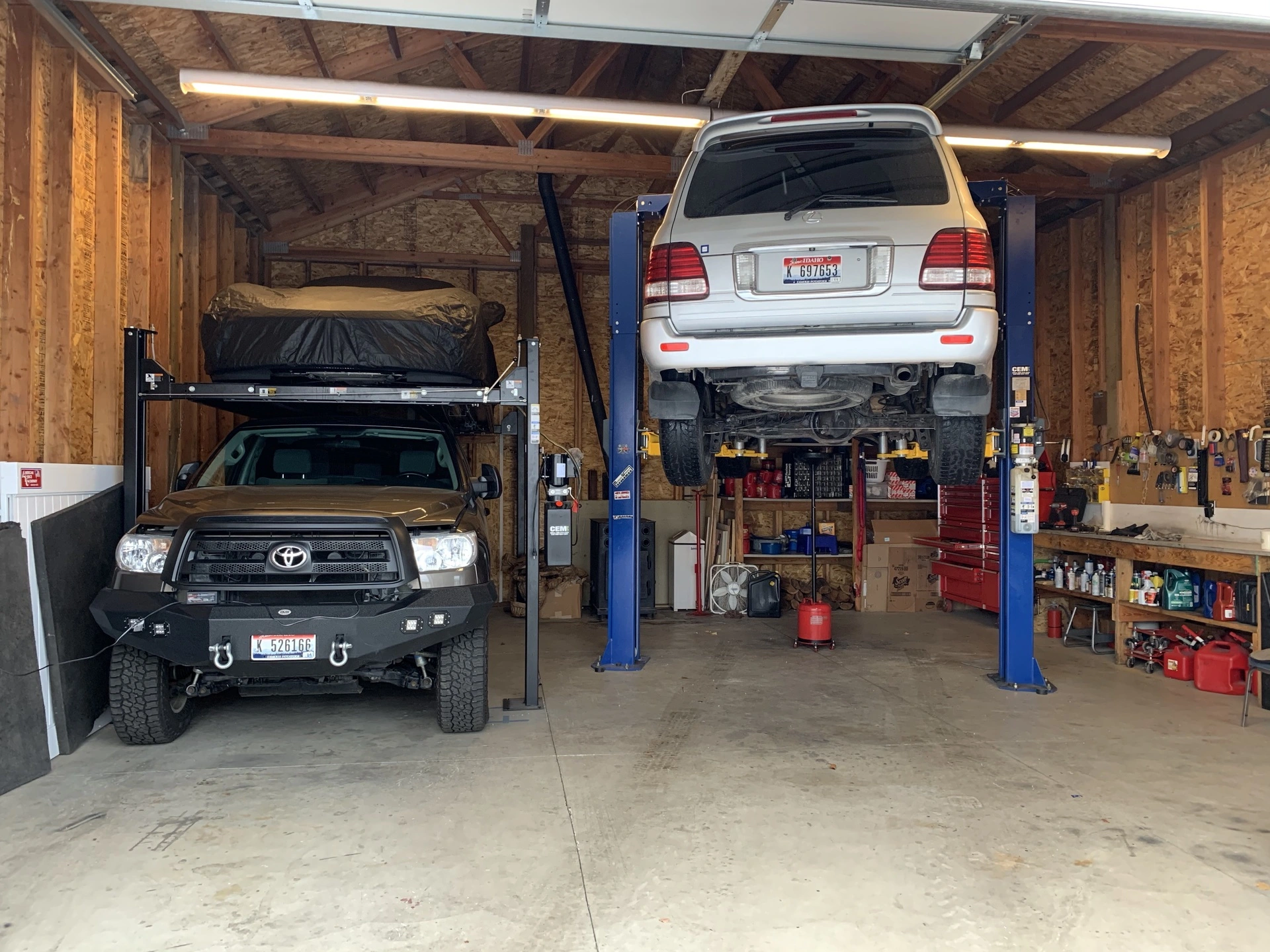

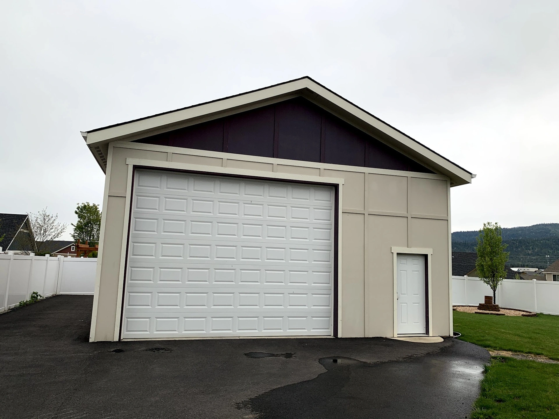

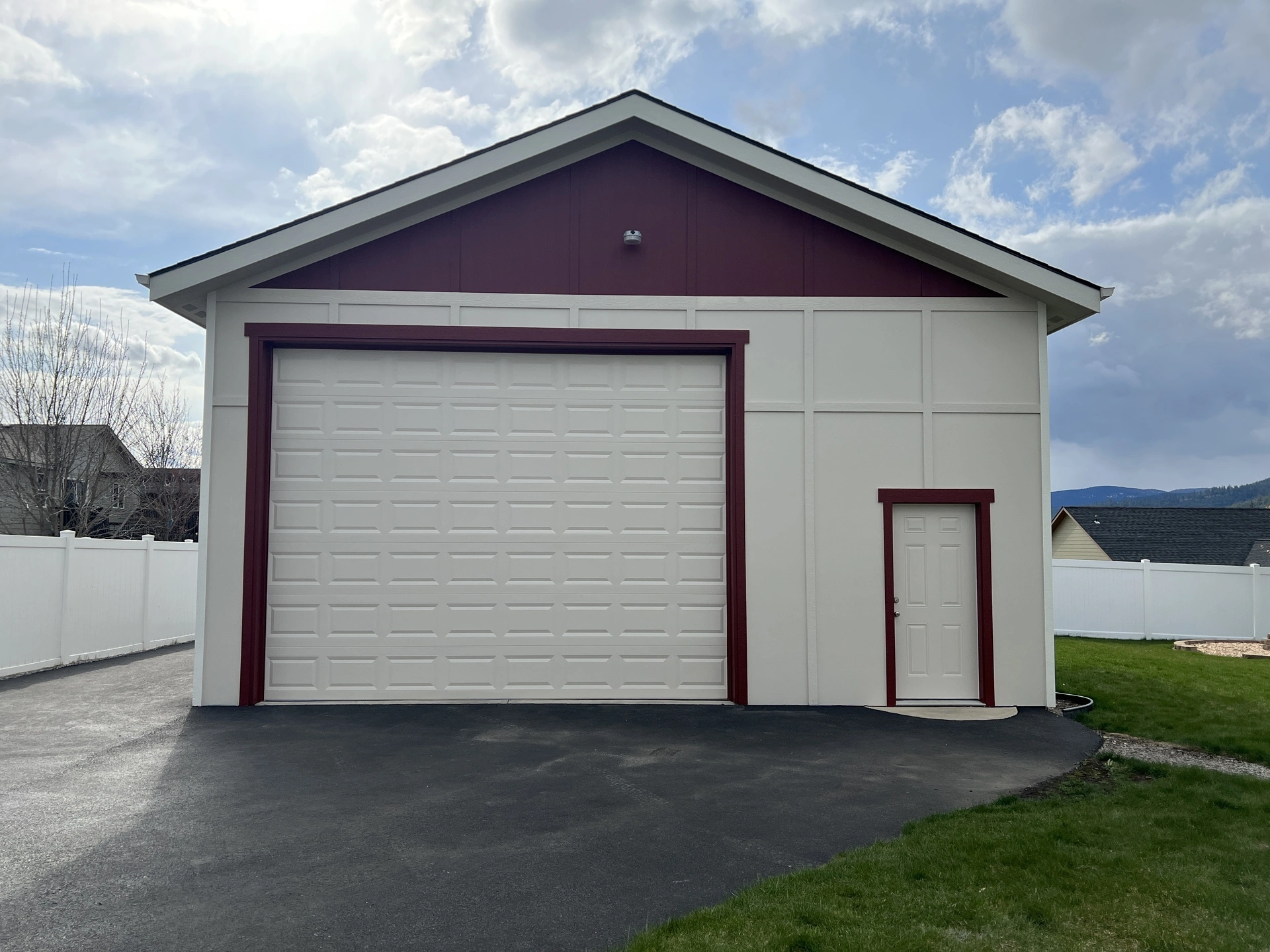

Your walls are 14' high?
yes, that is 12 foot of OSB on the walls. I would do at least 12 foot walls and try to get the taller lifts because not being able to stand up fully under the lift decreases the overall enjoyment and useage.
And more storage, man I miss that Tundra and LX 470

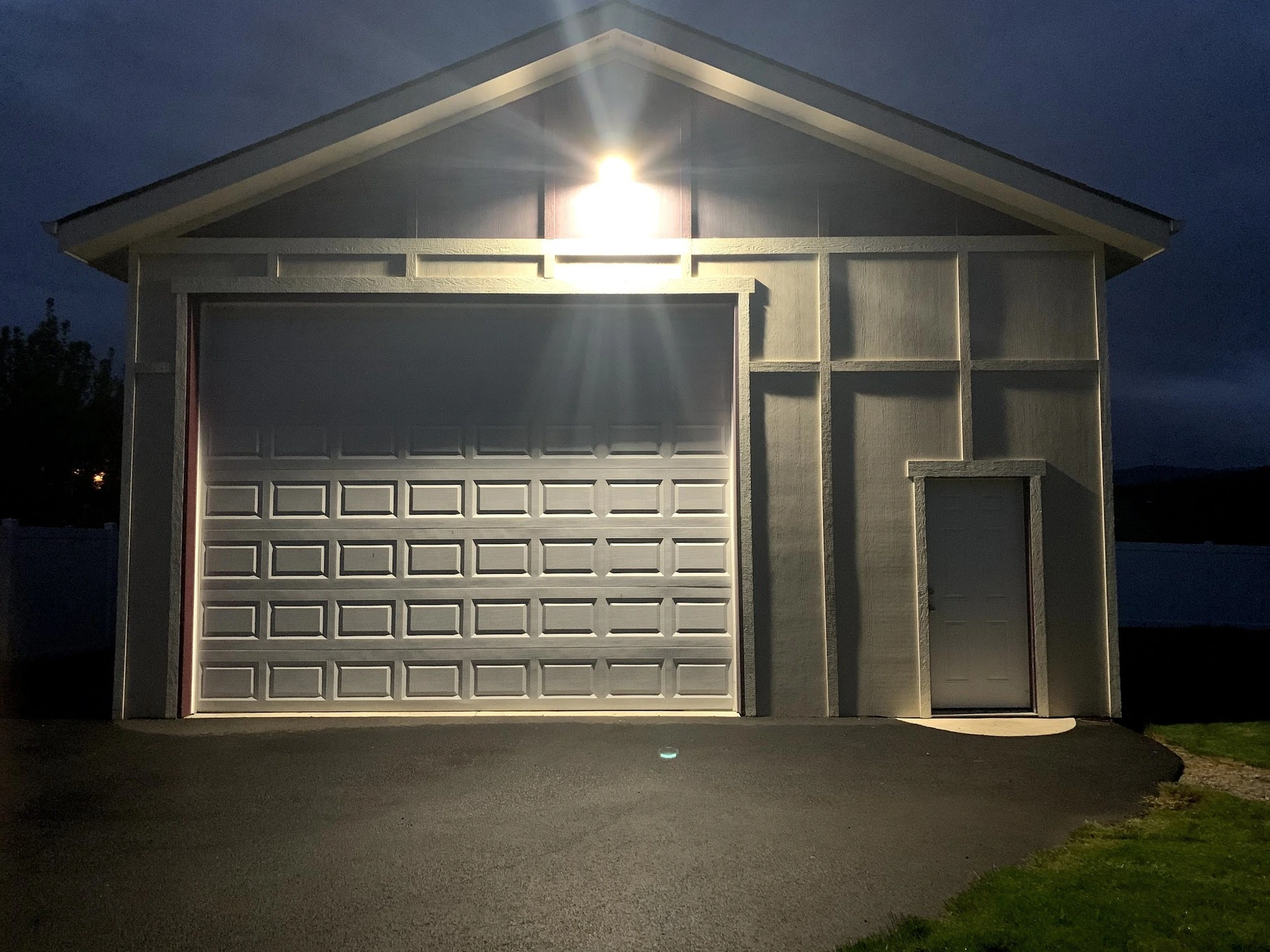

28x30x14 Door is 16x12
I was so proud of installing that light, I hate ladders and funny I NEVER use that damn light

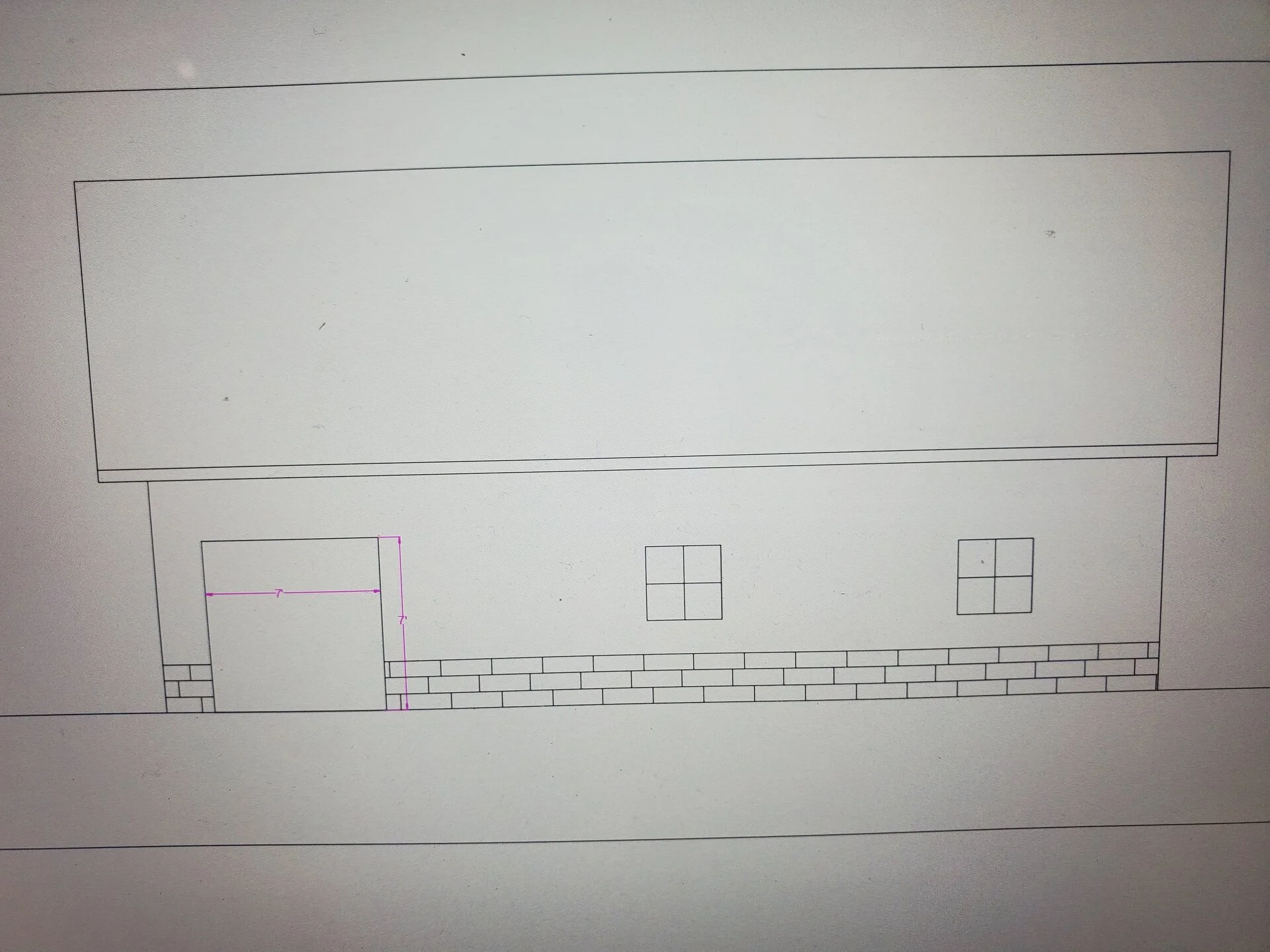

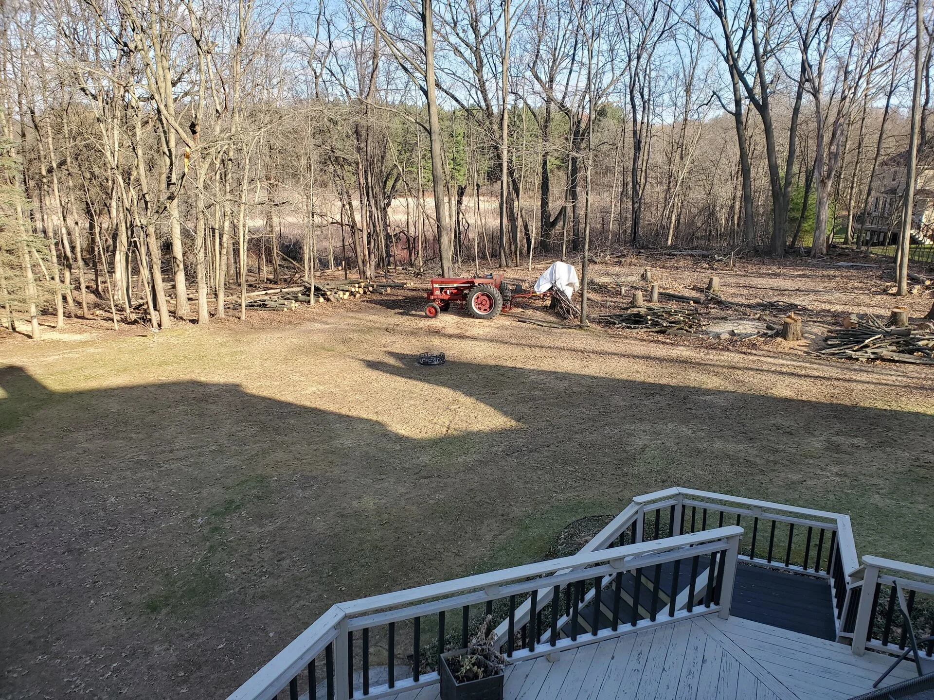

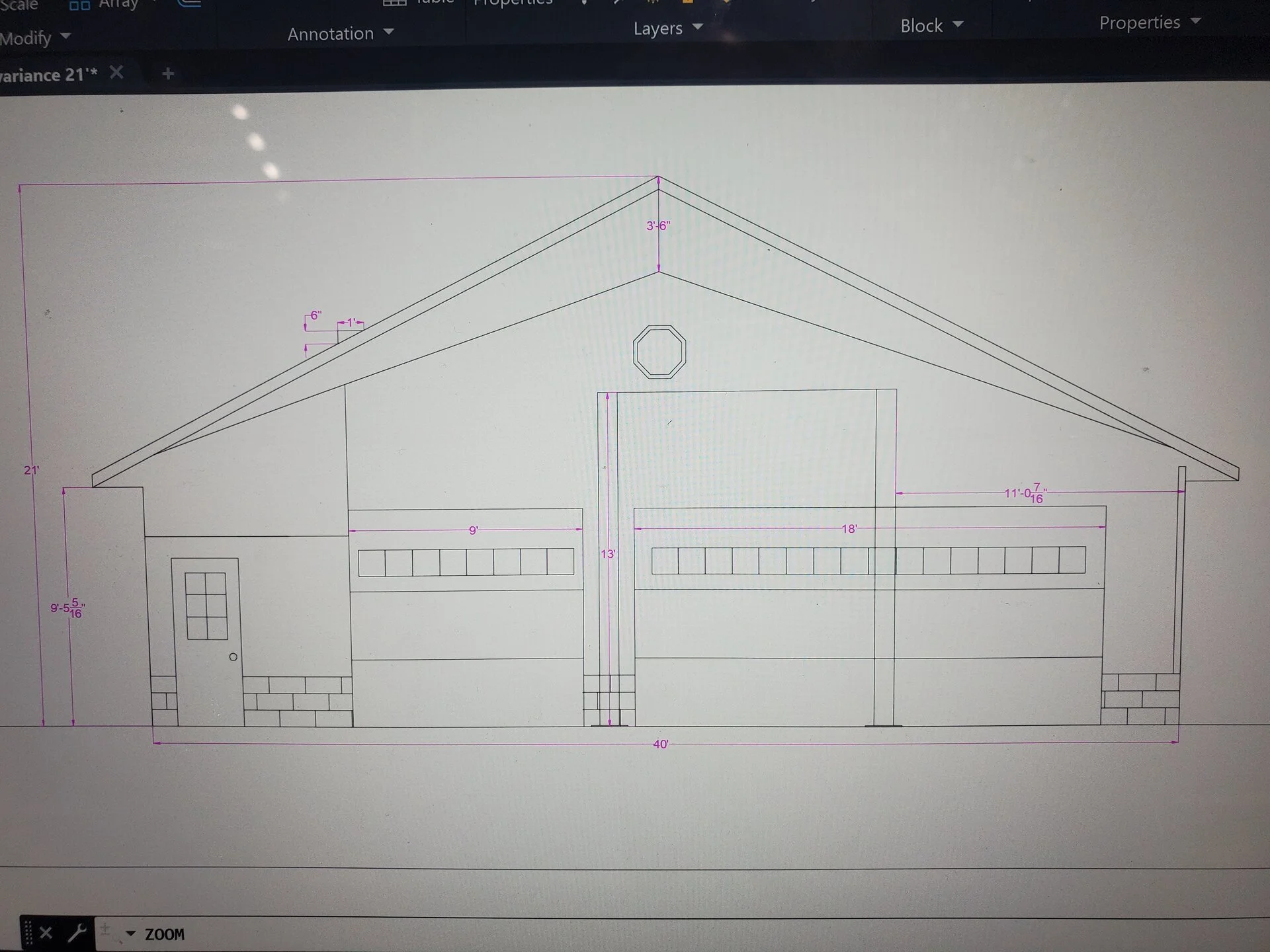

I am building a 40x40. I spent 2 years planning even was on the phone with the township during closing on the house in 2020 to make sure I could build a big garage. I cleared trees last year fall and am planning on breaking ground this summer. This will be scissor trusses, a bathroom, heated floor heat and of course a hoist as you can see in my plans.
