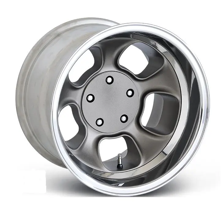

i am planning i think? on gulf stream aqua. i want a classic type wheel. what do you guys think of the et five window, grey center and polished outer rim ?15 by 8s with a fifth mounted on the package
tray in side. i saw a set with the 5 windows polished , and they realy looked good .i was also
think knock offs. i definatly want 245 15 BFGs. i like the ride but black wall out.

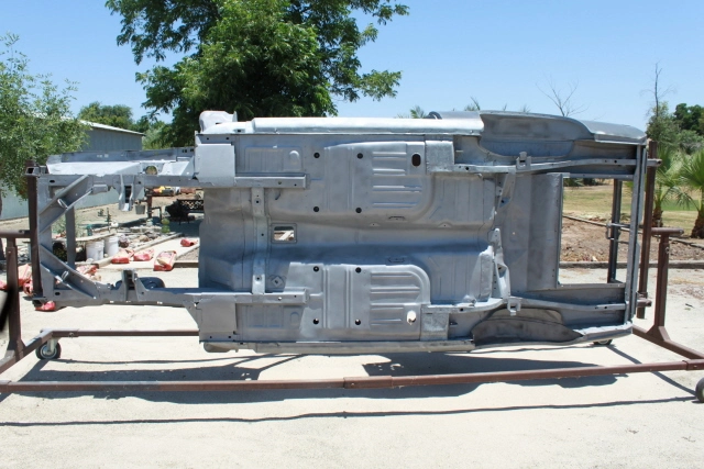

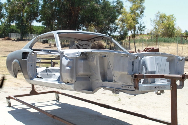

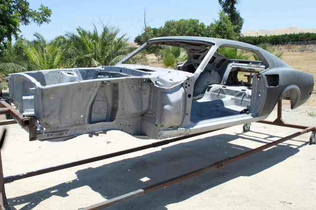

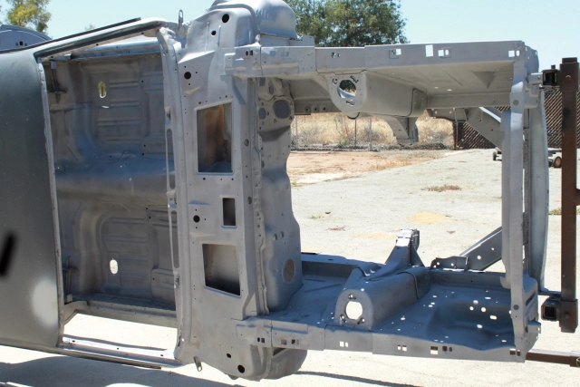

got it blasted today,5 hours ,25 bags of sand and 8 gallons of gass .completly worn
out but it feels good to geter done. didnt blast the roof or quarters as i had paint striped

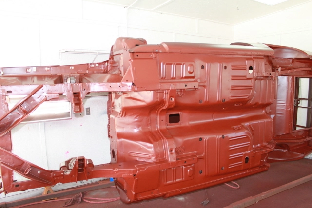

them about 5 months ago and epoxy primed them. hope to epoxy primer tomarrow.
nice car!, but I'm sorry to say I don't care for your wheel choice. I like the 69 shelby replica wheels or just use something like some torque thrust IIs. But hey, that's why they call it YOUR car, you get to pick hehe.

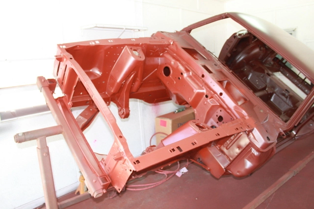

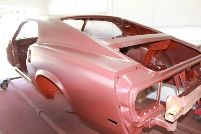

epoxy primed . that is the stickiest stuff i have ever seen! makes a mess out of the paint booth. if you stand in one spot to long your boots will stick to the floor.

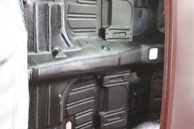

next week i am going to spray the inside floors ,roof and inside the trunk with bed liner.

arizona desert beige or bronze. i have been toying with the idea of totaly blacking it out and i think the et s would go well with the dark centers. the hub caps are optional and i dont realy like them. i was thinking that knockoffs would look good. especialy if i go with black.
my thinking exactly. my 35 ford truck has the TTII"s and they look good for it ,just want somthing a little different .knock offs change the look quite a bit on the ETs. does any one make carbon fiber door sill moldings? like to see somthing like the

To put on replica wheels is nothing new and been done a millon times over.
At $1500 per set, the wheels I suggest have surely NOT "been done a million times over". The 69-70 Shelby-only chromed aluminum composite wheels were one of the most attractive wheels ever installed on any car. Very rarely seen at car shows, certainly rarely seen on anything but real 69-70 Shelbys.
$1500 is not alot for wheels. At the recent Knotts berry Farm show, there was A LOT of Shelby's or replica Shelby's.And they got walked on by.No matter how much money was in the car, people looked and kept on going becasue it was same as the car next it and the next one and the next one.
i sprayed some bed liner today. i just did the floor ,just incase i didnt like the way it looked. i like it! this is from wallmart ,by rustolium and it is a two part material. a full
gallon at around $80 for the kit. i have sprayed much more expensive liner material
and i would say this is as good or beter and sprayed easily with a nice texture, and a lot less expensive to :nice: the trunk inside is next. it wouldnt bother me to leave this exposed.

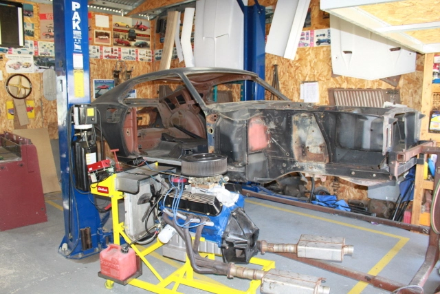

is that a 428 car or did you replace the shock towers?
just added the plates.when i first bought this car, over 20 years ago. i was told it was special orderd dy a drag team here in calif. it was a 351 4v ,close ratio 4 speed ,3.50 detroit locker with comp suspension .however it was 2 1/2 in drum brakes all the way around, no disks. had all the mach 1 interior with no stripes and did not say mach 1 any were on the car .it was lime gold and i was told they orderd 3 of them identical. it does have the duel exhaust reinforcement plates in the rear floor and had the factory duel exhaust. i always caled it a mach 1 but i believe it was a G.T. .the gass cap was missing when i bought it but the outline showed it was a pop open cap. it had the black out hood with no scoop and hood mounted tach .i used to know the team name but i cant remember it. it had the name on it in a race decal, stupid me never took pics of it. sold it after striping it ,thats right i striped it .guess what ? i still have all the origional parts .except the hood mounted tach. oh the car had shelby 500 slot mags, i think i still have somewere around here.
horse sence, did you have to use a fine sand to blast the car? Does the sand blasting remove oil and rubber undercoating well also? I took my car in to media blast and it was turned away because of the rubber undercoating and a little grease/oil.
I may sand blast it on the next rebuild.
Your project looks great by the way, nothing like doing it yourself.
i use 30 grit or finer, but usealy 30 grit. media will not remove tar or undercoat .i usualy scrape that off, its a pain in the butt but not even the sand blaster will revove it. the factory tar around the seams is usualy brittle and will flake off .under coat is totaly differant, nothing will touch it. some times i wind up cleaning it off with a gass soaked rag, dangerouse so be carefull. most calif. cars dont have under coat,thankfully.
do not blast the body panels ,roof ,quarters ,cowl, doors, you get the idea. sand blasting produces heat and it will warp. every thing else gets blasted. paint strip the outer panels. a rotisserie is the way to go .its the easiest way to get the sand out ,keep spinning and vacuming and blowing the rockers and frame rails it will come out. i build my own rotisseries frome hitch and reciever tube. they are very tough. i put the cars on them with front suspension and rear end in place some times. you can rent compressors and blasting pots at your local equipment rentals. i have a 1953 army compressor with a 8 bag presureized blaster, it works great!
Horse sense thanks for the input. I had heard about sand warping panels and originally thought you sand blasted the whole car with good results. My car is a California car but as a teenager, I thought it was a great idea to spray on some auto part store undercoating to make the car quieter and prevent rust.
