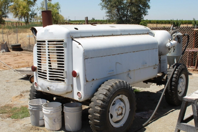

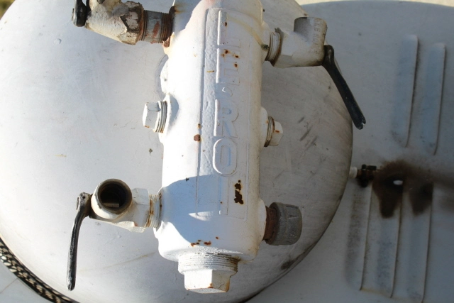

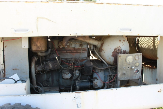

this is little LEROI as we call him ,from the name on the air valves. hes a 1953
US of A army gennerator air compressor unit with a large 4 banger that uses two cylniders to run on and two to pump air, runs 120 psi at 90 psi at the nozzle all day
long,with 50 psi oil pressure. never been dissasembled, yet runs like a top. only thing replaced is 3 fuel pumps, due to todays gass. i paid $2000 for the unit, a 4 bag blaster and an 8 bag blaster, with 60 feet of hose. best money i ever spent ,done about 20 cars so far and hes still going :flag: some day i will have to repaint him the origional army green and put the star back on the doors.

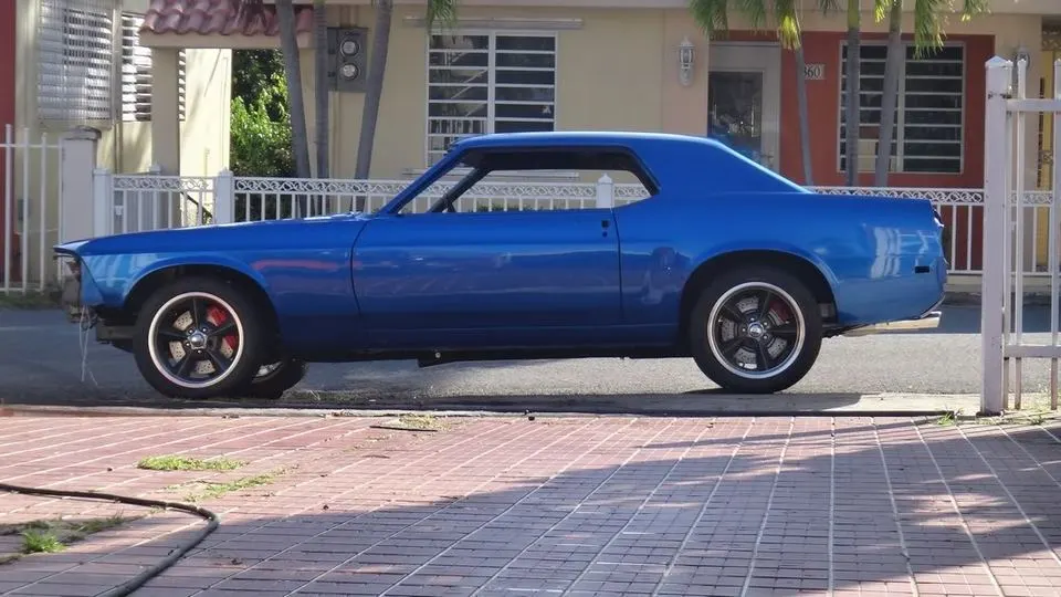

Im new here but in my opinion i'll go with the first wheel, I've seen to many Magnums. What color is going to be the car? I did mine a modern blue (winning blue) that came on the Mazda 3. So I went with modern wheels but inspired on classic ones.
The car is not finished yet. I have a post with more info about the car.
nice, the 69 wheels are a little different than the magnums ,but not what i am looking for. thinking about gulf stream aqua, but with the upper top portion of the car a bronze metalic. saw one on ebay that was black on the bottom and burgandy on the top, kind of liked it. also been thinking about strait black no stripes, but you never know . the last 69 i painted ,i went in to the paint shop to get acapulco blue and came out with flame red. hopfully this time they will keep the paint charts out of view.

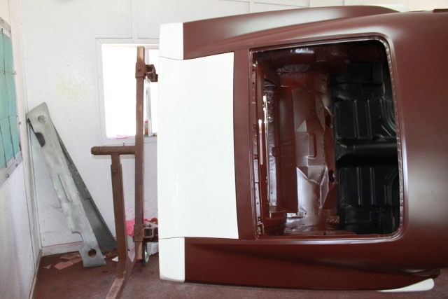

looks like i may get next week off, if i do i am going to start the body work. couldnt take more than a pint of bondo and a couple of hours. i plan on block sanding several times, and its time to fit the fiberglass. body work will be much easier on the rotisserie, i wont have to bend over. it will be much easier to sand.

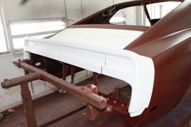

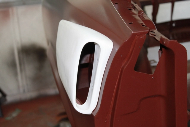

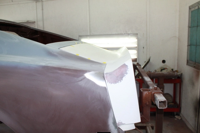

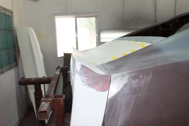

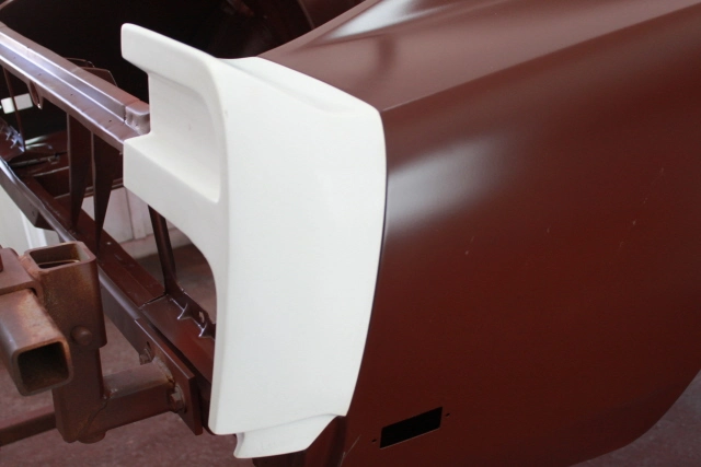

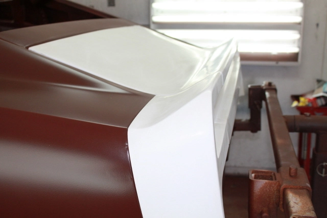

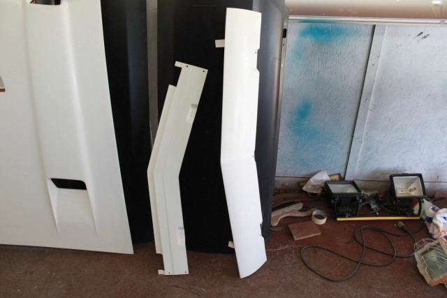

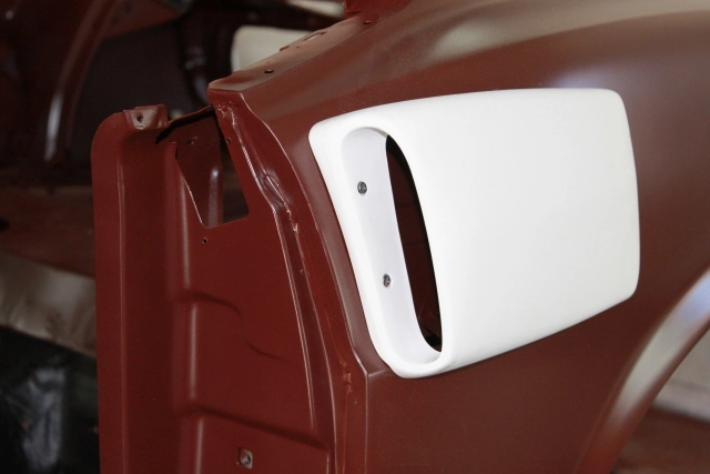

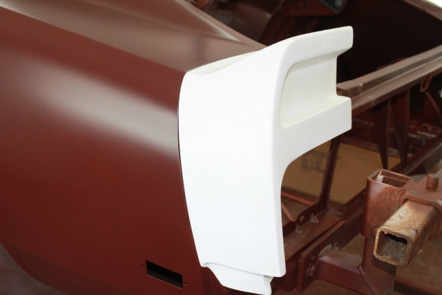

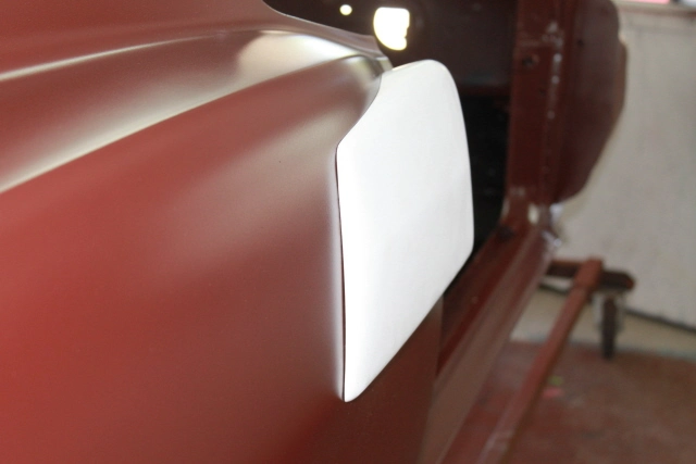

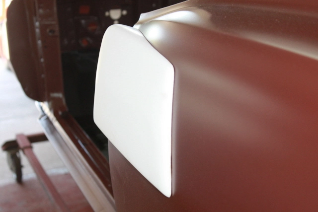

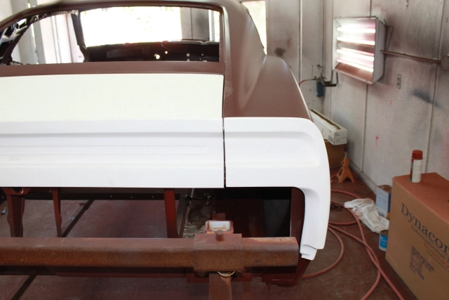

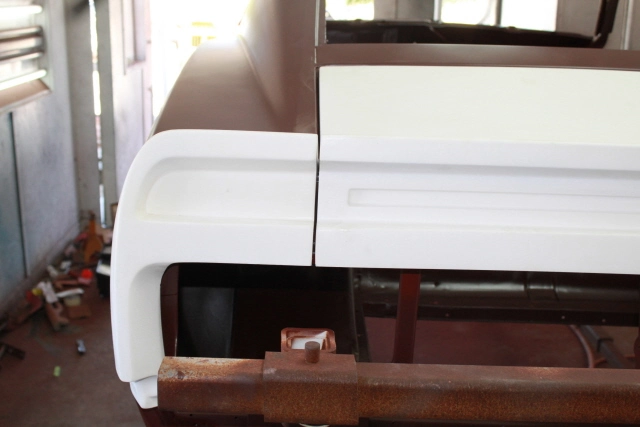

bolted on the end caps and side scoops ,other than needing a little sanding on the edges to make them set flat no surprises here, actualy a good fit. missplaced one of the nut plates for the trunk hinges, soon as i find it i will try the trunk lid. the tail panel wont fit with it on the rotisserie . i have to wait untill is on the ground.

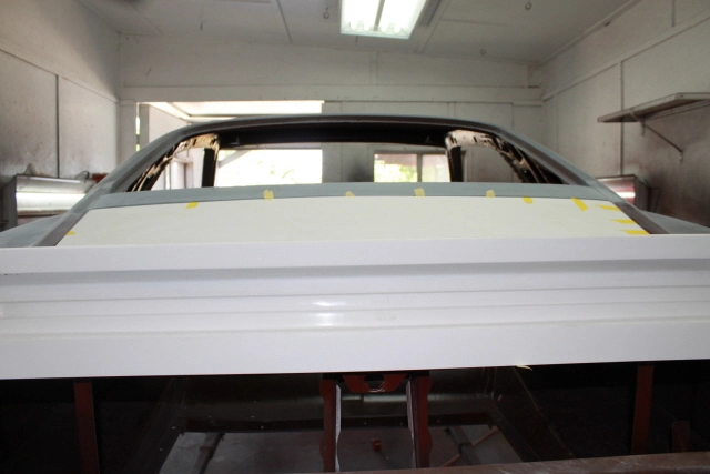

found the nut plate fore the trunk hinge. they were right, it was in the last place i looked . the lid is on, fit is realy good. may need a little sanding on the bottom of lid and end caps to even heigth. wont have any problems with this stuff. installed the snubbers first as that is were it will stay when finnished .i also put the latch and striker in to make sure it fit when latched. waiting on a door hinge rebuild kit .the doors and front end fiberglass will be next. cant wait having fun now.

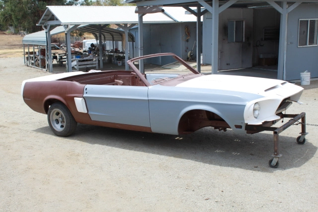

a friend of mine just gave me a rusted out 67 convert, says it was a play boy pink car. all the convert structure is good ,every thing else is kind of see through, invisible?
comes with a pink and a marty report .if its free gime .found a 67 coupe for $500,
fairly decent but just the body and doors . i see a 67 shelby convert .i got a new project wooohoo , help:chair:

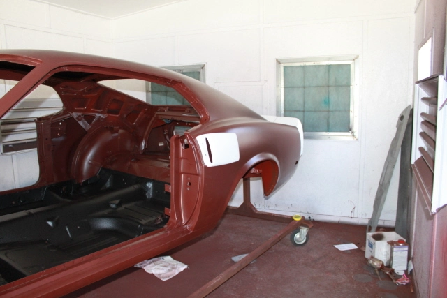

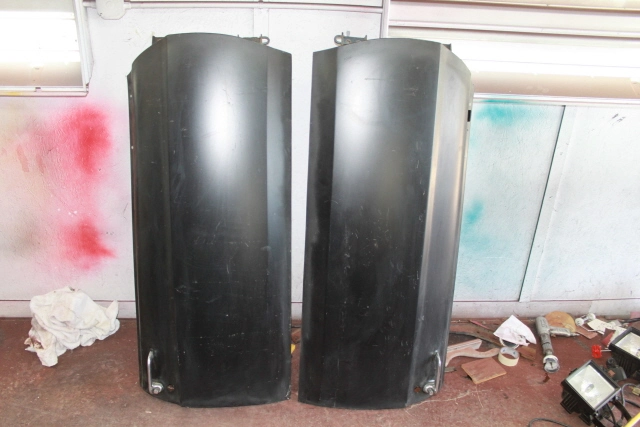

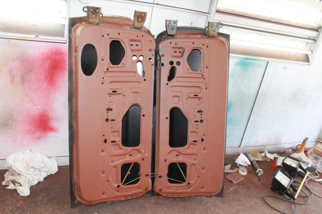

wound up re skinning the doors, had bondo and not a very good job. once again some idiot with a drill drilled it before bondoing it. looked like bonnie and clydes car after the shoot out:uzi: , blasted and epoxy primed the shell inside and out first .still waiting on the hinge pin and bushing kit. wow the gaps look great on the lid and end caps. didnt get the body work done this week had to work,was suposed to get the week off but you know how that goes. went to get more epoxy primer, guess what, disscontinued in california ,again ! soon we will have to paint with latex house paint.this is realy getting old.

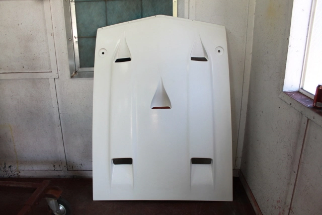

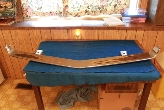

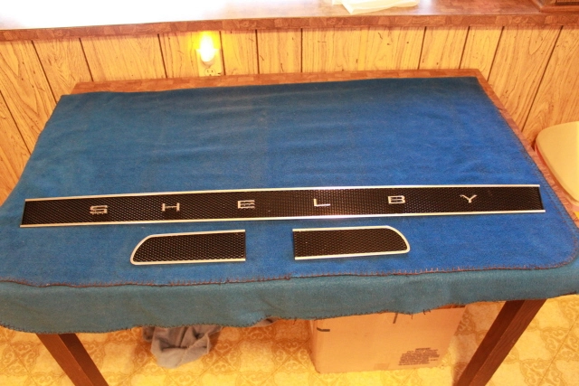

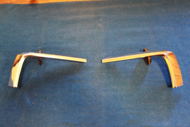

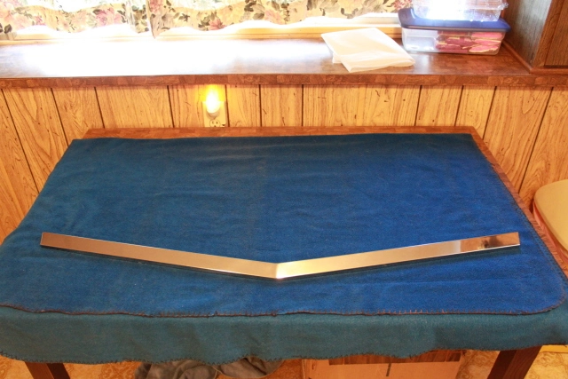

ah, christmass in june. some of my parts made it in to day. front bumper,hood peak, fender eyebrows and the trunk and end cap webbing .dont realy want the shelby leters in the webbing, want to do somthing a little different here .you wouldnt believe how expensive it is to do a 69, front bumper alone was over $500. didnt order the grill yet $$$$.

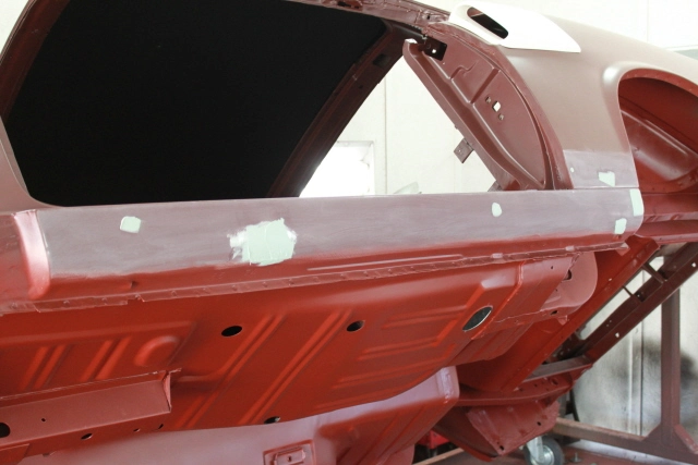

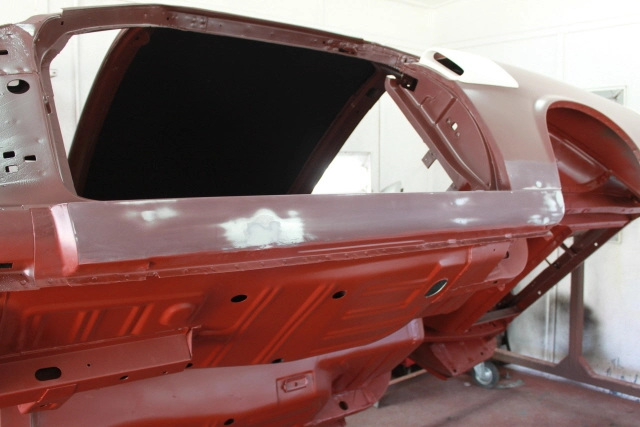

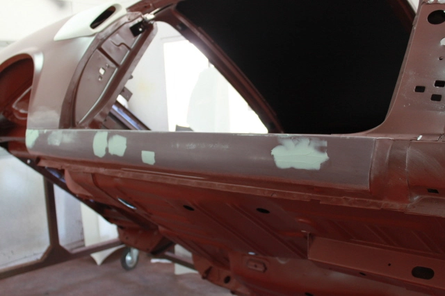

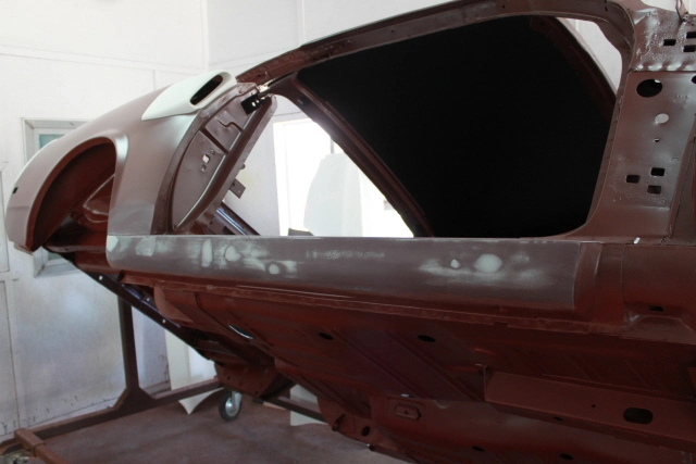

finaly got some me time. no one telling me what to do.just me and my hoss. got most of the body work done this morning, all in the rockers. had several small dings mostly from the inside, must have been assembly plant dings no other way they could have got there. simply ground them off with a flapper wheel .very few out side dents and very small, just took a few minuets. i dont like to use bondo but some times you have to .still have one small ding on the roof,
and block sand and its time to come off the rotisserie. my primer is gone and not available any more. i guess i have to use what ever replaced it ,color isnt the same.
and doesnt look as good.

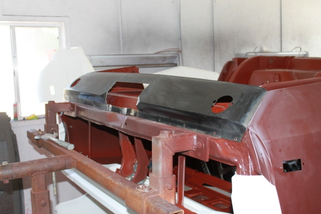

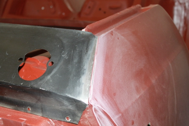

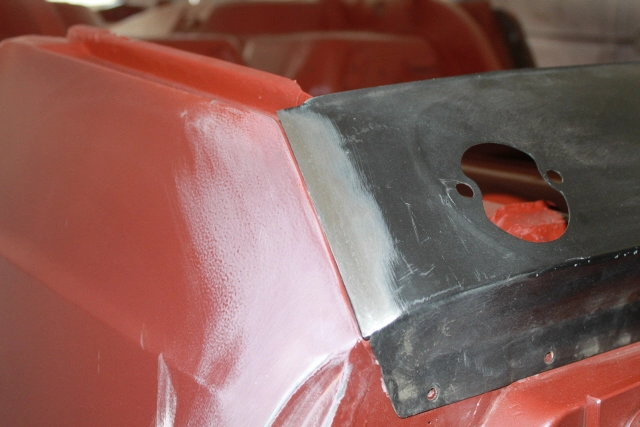

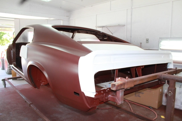

it was a perfect weekend ,locked my self in my shop,kicked on the exhaust fans,cranked the radio up, a little Rascal flats some Brooks and Dunn,even had an Eagles cd. fit the rear valance had to extend both sides about a 1/4 inch and that was a ford tooling piece, blocked the roof and both quarters this baby is flat ,that epoxy primer is as tough as cast iron, arms hurt like hell but it feels good, i am making progress, yeah boy

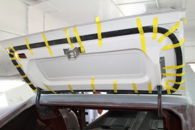

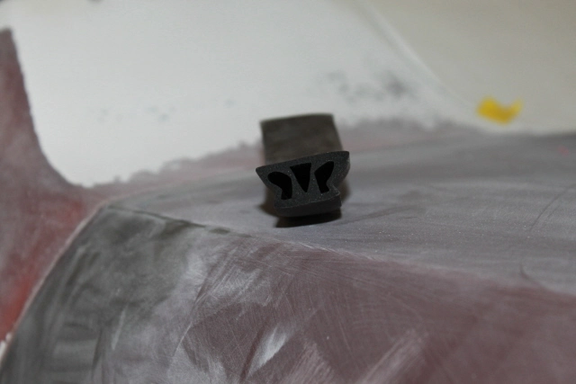

taped the trunk gasket to the bottom of the lid ,wanted to see if it still fit when closed. perfect fit. the 69 gasket is a little softer than the 67-68 and its hallow so it compresses easier .i think it will work on the 67-68 lid as well. i will try it on johnnys car .
did some more block sanding sanded across the end caps while bolted in place for a perfect fit and i will sand across the lid and end caps for a flush fit. its ready to come off the rotisserie, i just need a set of u bolts and mounting plates for the rear end. stang -aholics is going to lend me an old set for now, but there closed till monday.

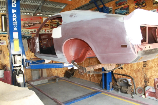

well after a game of shuffle the mustangs,had to push the 68 out to use the lift.

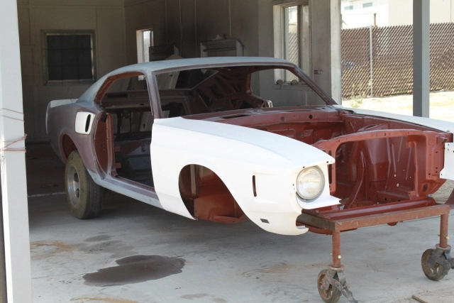

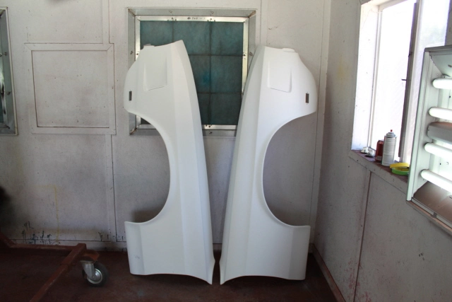

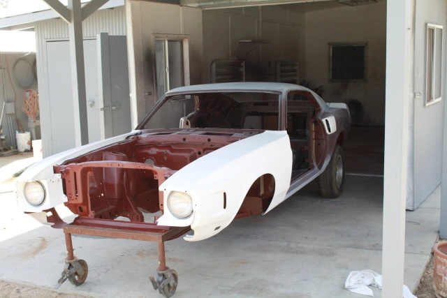

i got the 69 off the rotisserie. bolted an old rearend and leafs under it so i could roll it. now i can bolt on the tail panel .still no door hinge pins and bushings, so cant put the doors on. i just had to set the fenders on. guess i can at least finnish up the back half now.

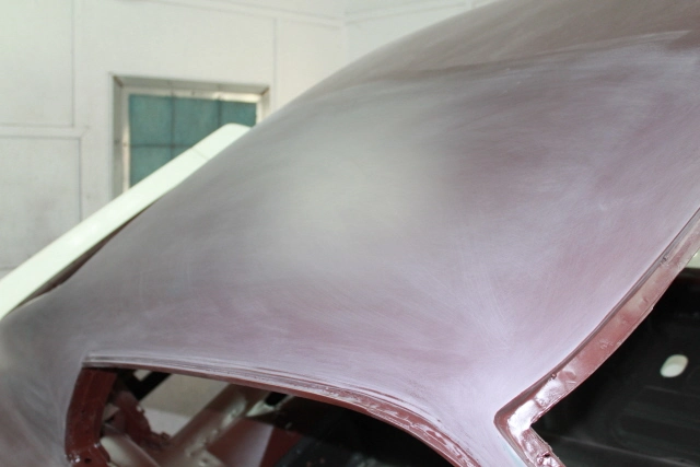

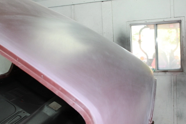

roof is finnished,blocked it 3 times .when i first striped the roof i must have removed a couple pounds of lead at the roof seams ,they are strait now.
