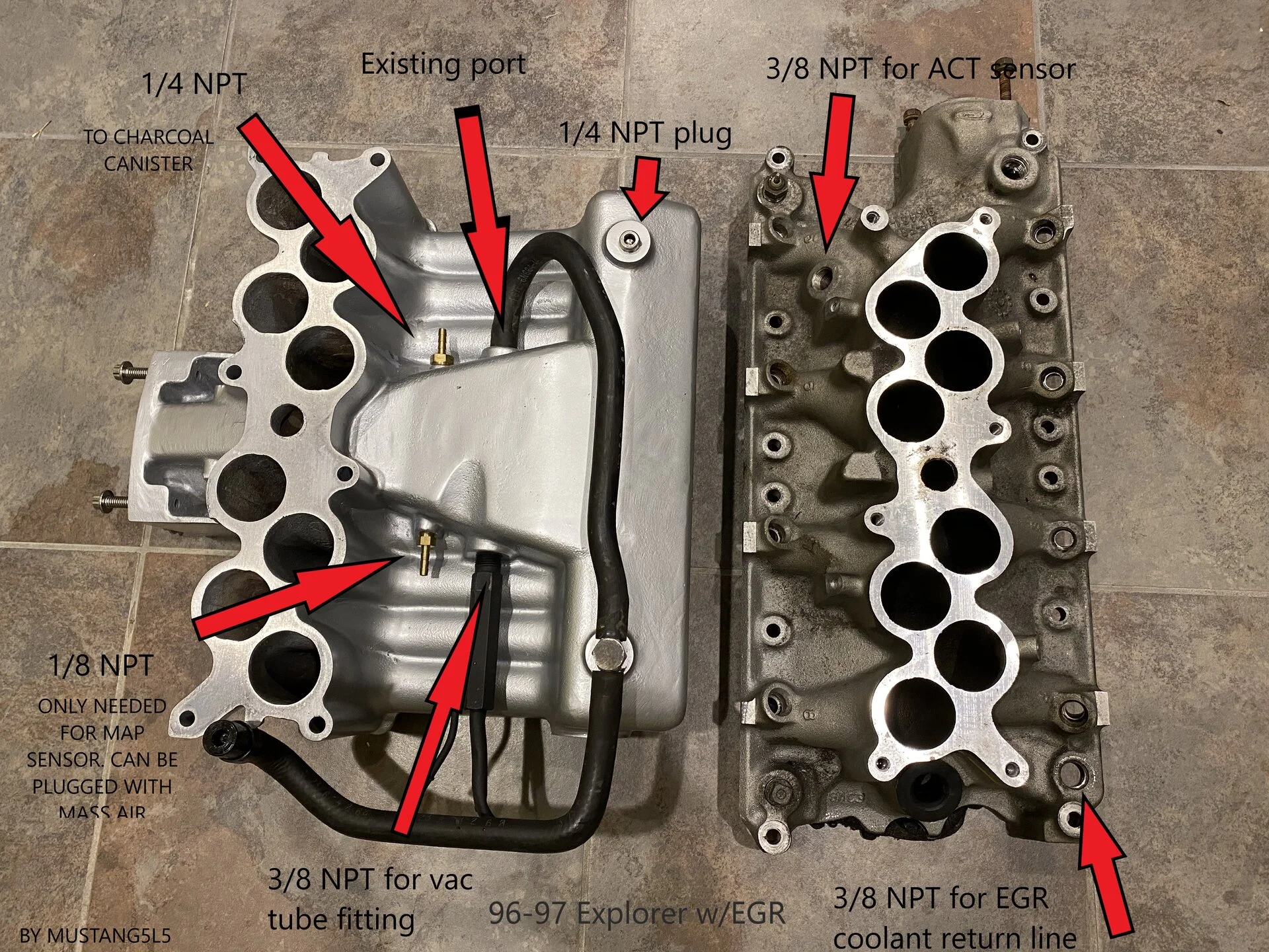

to answer your question, tap the ACT and rear pass coolant boss for 3/8npt, and then pull all the vac ports off the upper and drill/tap for NPT to tube connectors and the vac tree pipe like this
Do all this first then send it to get ported (with fittings removed)
Keep the EGR, especially if you are using an untuned a9x ECU. Not much to gain by deleting it. Often times people have issues with the way a car runs when they start deleting stuff.
Edit: the brass fitting on the left above the vac tree is only needed on 86-88 speed density cars to connect to map sensor. Plug this if mass air
