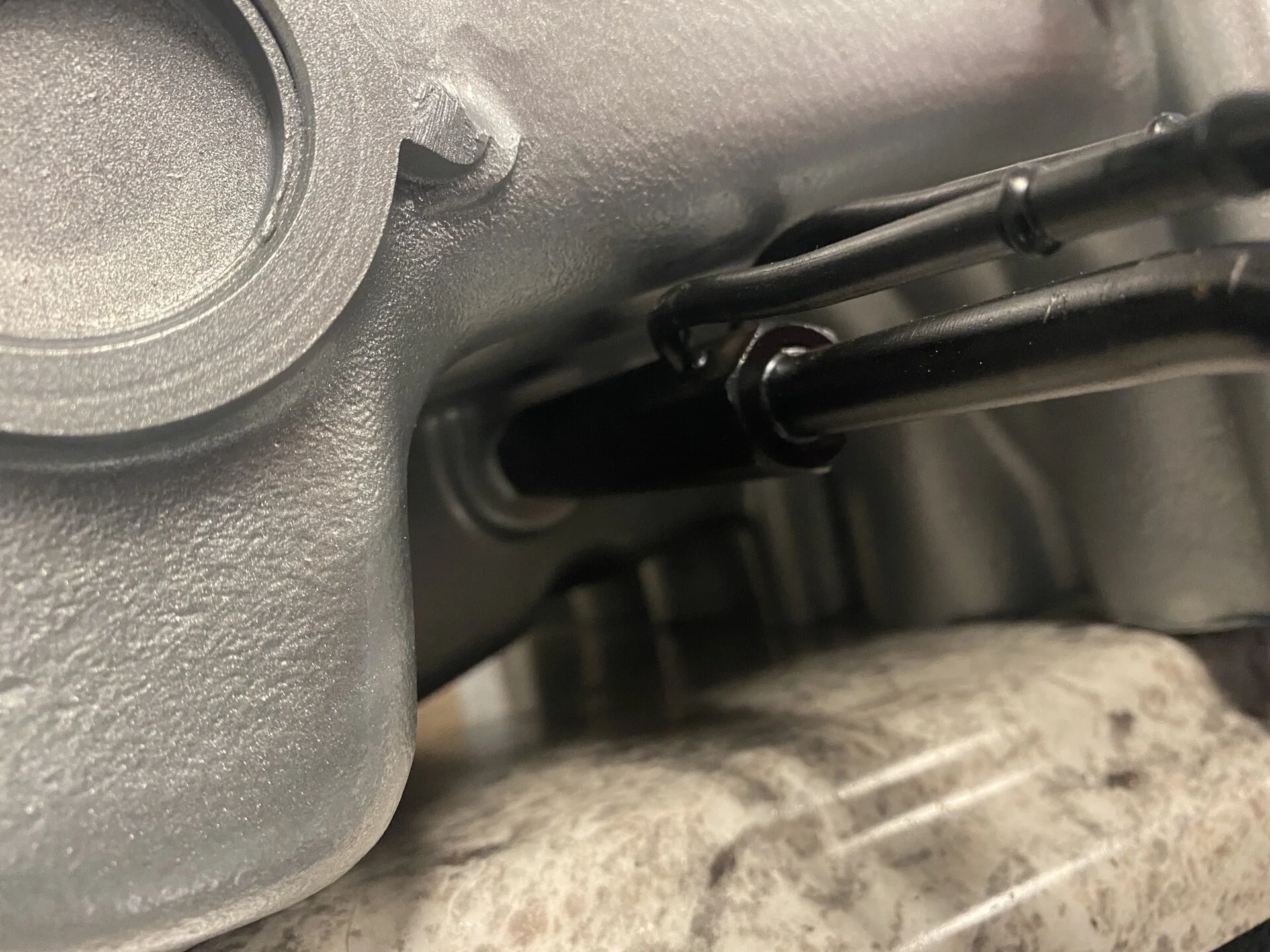

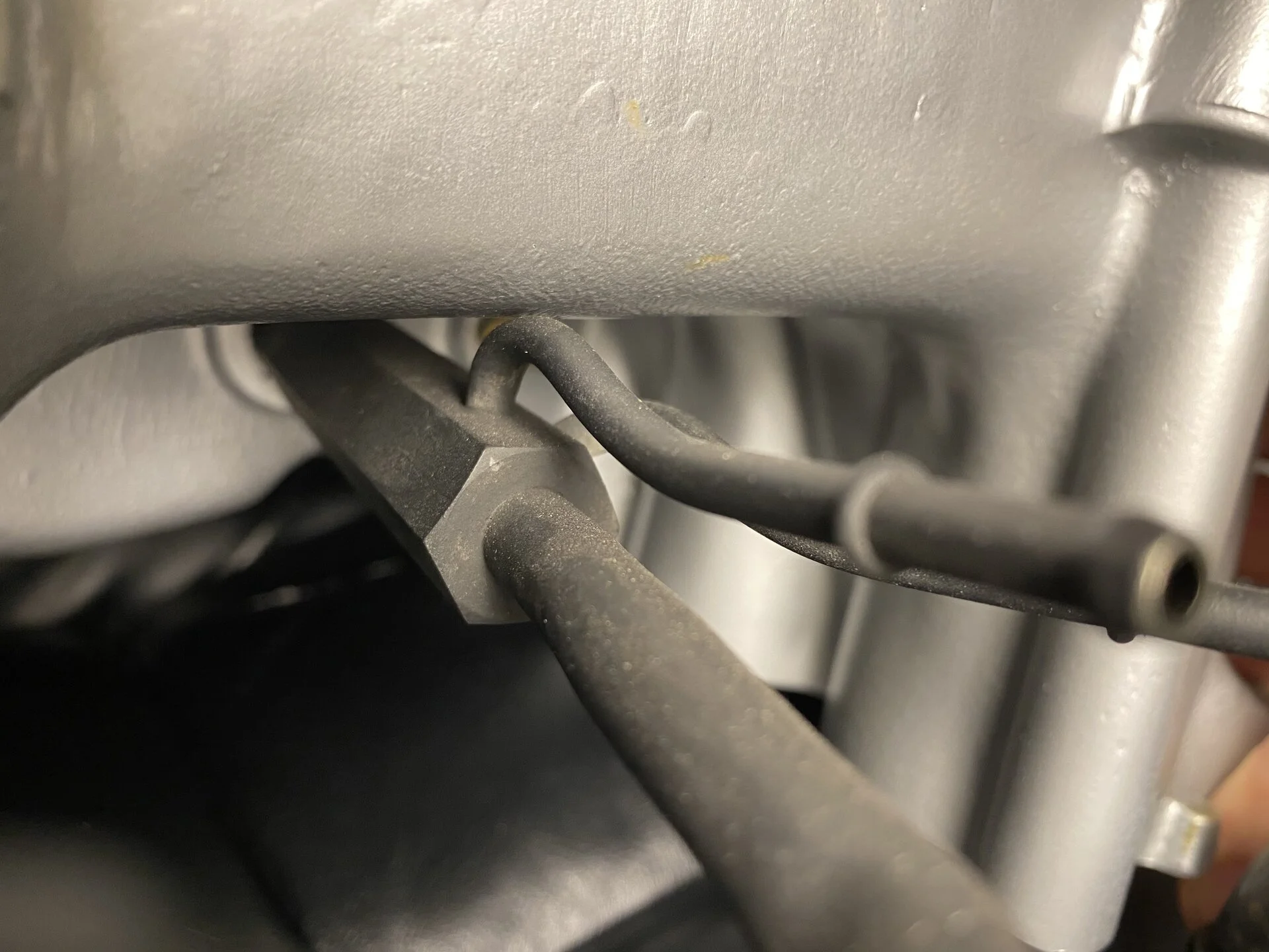

Better pic

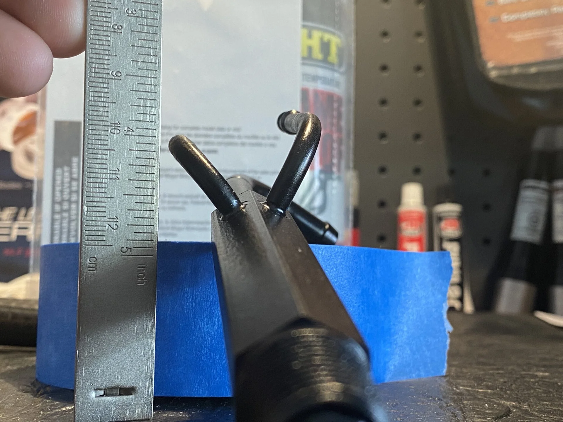

Mike, question - in this pic of your vacuum tree, where did you get it? I ordered a LMR piece but the two smaller lines hit on the upper as I turn the threads? Did you have to bend these lines or do you have a different model? I also saw some of your reference pics that have an aluminum one? Regardless, mine does not fit and before I do anything I wanted to ask your advice to see before I go breaking something! Thanks!
that’s just an OEM 87-93 HO intake vac tree. The silver one in other pics is from some other Ford vehicle and I later swapped to this one in the above pic.
yes, it’s tight. I did gently bend the tubes to give me clearance to screw the vac tree in. Didn’t need much.
I assume you’ve drilled/tapped for it otherwise I would say when you run the drill in, to “cheat” away from the manifold a bit to give you more clearance.
Here’s how close mine get, and I did have to bend a tad
Yeah, I should have cheated a bit but as luck would have it I drilled and tapped dead center of the original hole without having the vacuum tree in hand! Lesson learned. Your pic has much less of an angle than what I have, pic attached for comparison. I will have to be careful in bending without breaking but I think I can do it. I may search some of the local salvage yards to see if I can find a back up, just in case! I would have a pic with the intake but it is getting clear coat right now. Let me know your thoughts and then I will get to bending! Thanks as always! Your project is looking awesome as well!!!

If you have an issue I do still have the tree from post 15. It sticks way out, so not sure if it will cause any clearance with the firewall or anything behind the engine, but i'd sell it off cheap if you need it.

Ok I got it, just a little massaging with the vice with breaks to ensure I did not stretch the brazing and crack the pipe. She fit, just need to align the source outlet correctly and I am done till I get heads and I can finish the porting on the lower.
