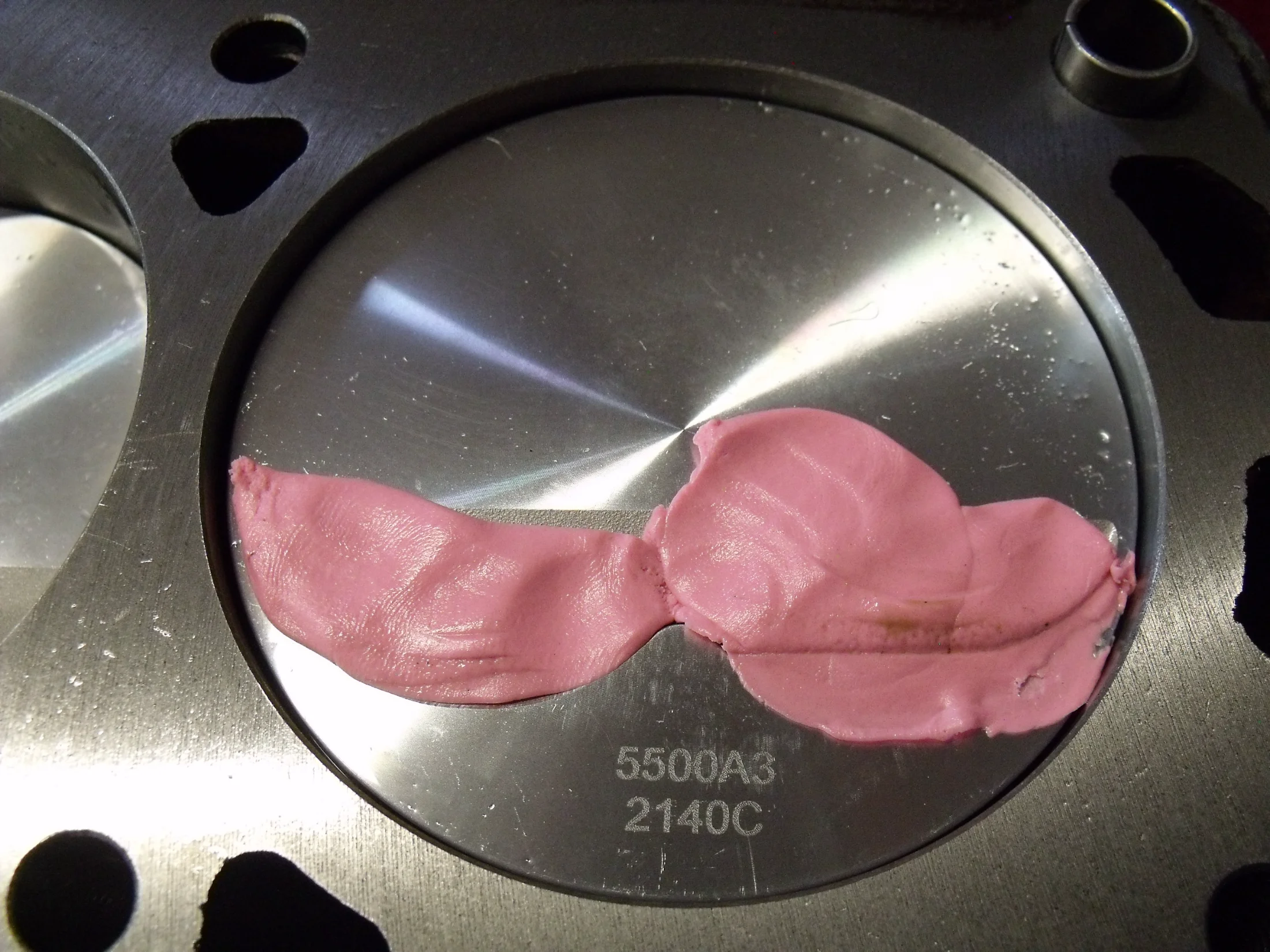

Sure they can.
If the camshaft does not have to much overlap or duration at the wrong time, they can easily be used.
They put the disclaimer of checking piston to valve clearance so people just don't put a big thumper cam in it and then wonder why they bent some valves.
Keep the LSA at 113/114
Keep the duration at .050 less than 235* and you should be golden.
There are a ton of cams that fall into that range.
You can have a .650 lift cam with 185 heads on stock pistons if the LSA and duration are kept in check.
It is not how much lift you have, it is when is the valve open in relation to the piston.
