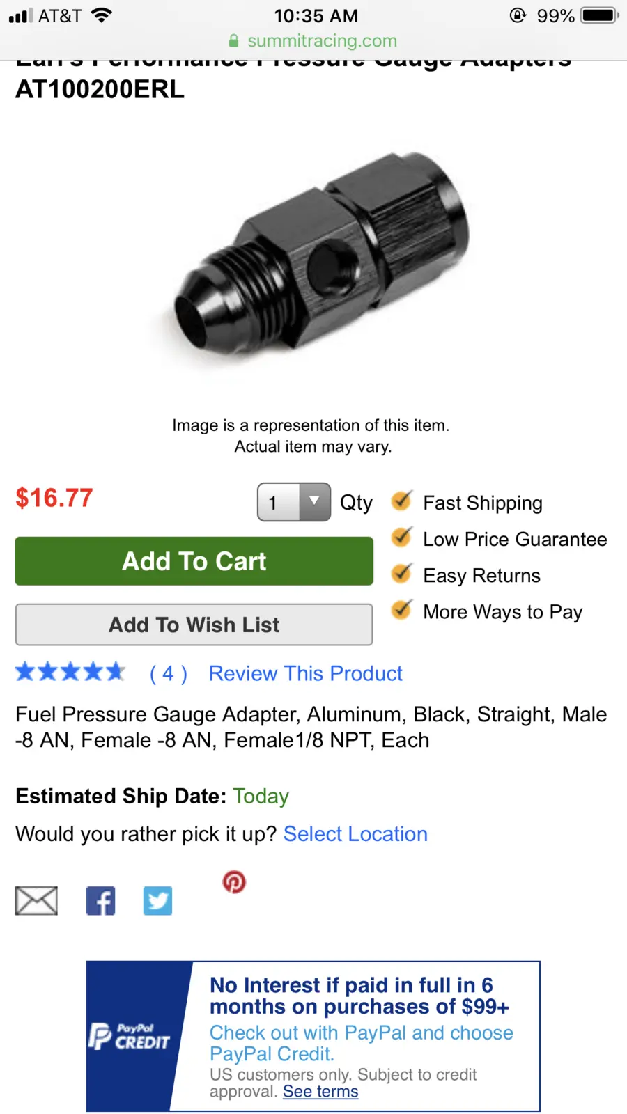

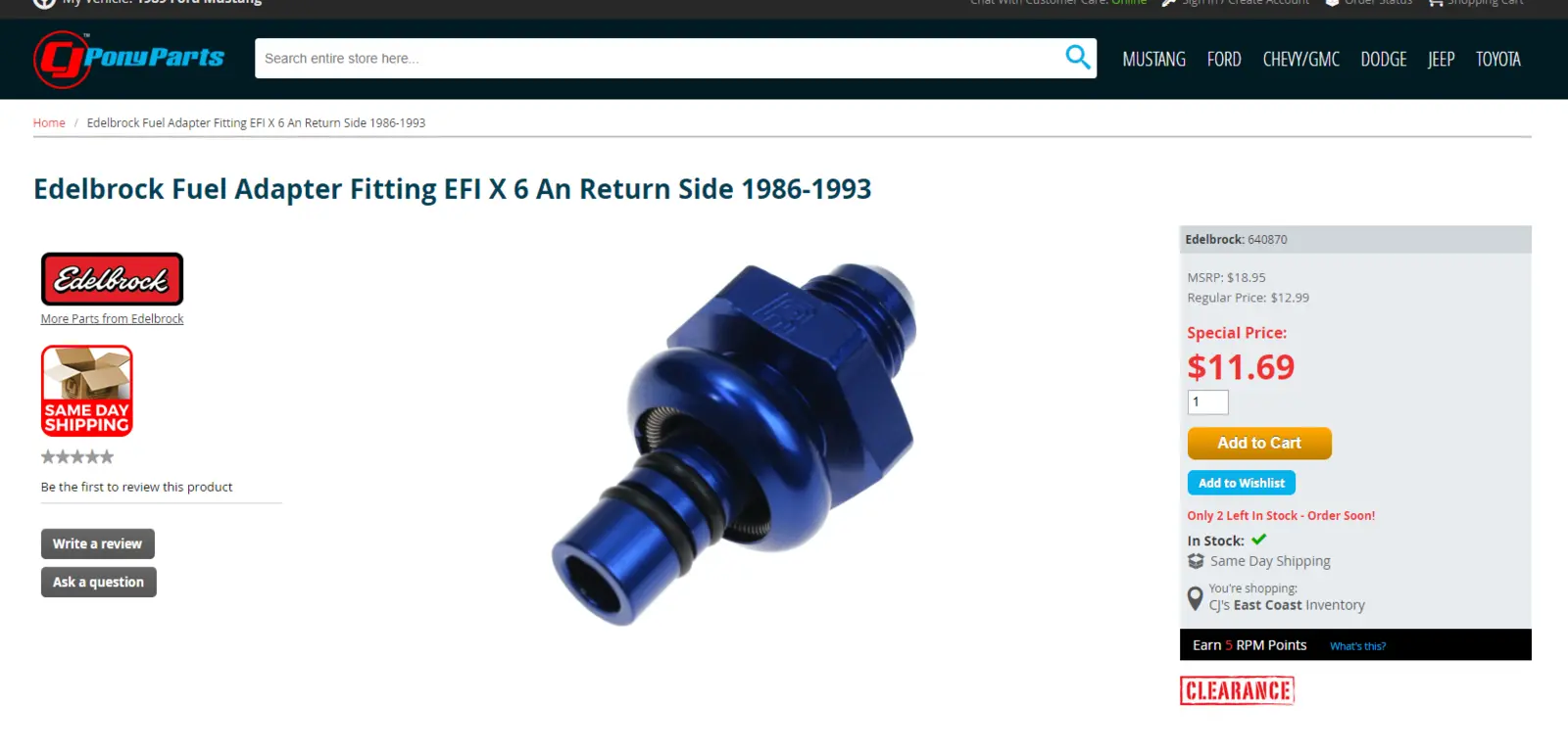

If you use -6an to go from the rails to the adapters to the stock lines . This may help you out .

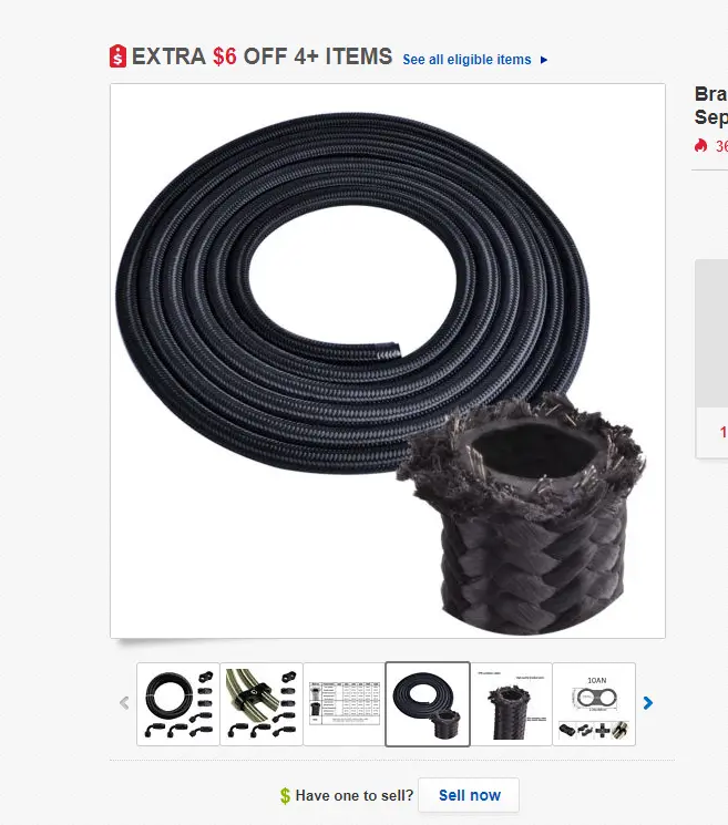

IMO buy this line as well its way easier than the silver stuff.

your stock fuel line connectors look like this they are reasonable. proly would need 10' or so of line depending on where you mount your regulator
Much . I just did mine all with vibrant red stripe with the black
Reactions: Driver460sz and Anti_Hero0932
