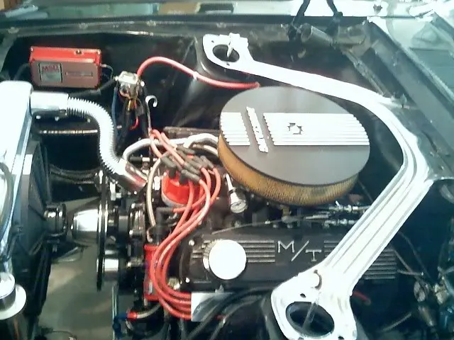

The cam phone pic didn't turn out real good and have some cleaning to and a few more hold downs. also thinking about putting a black wire loom on the hot cable on passenger side shock tower. Also the export brace is off by about a quarter of an inch going to have to figure out a way to squeeze it on or spread shock towers a bit. Any help for these problems are appreciated.

1/4 inch isn't too far off for the brace. For mine I was able to loosen the bolts at the firewall and that gave enough play to line up the brace and shock mounts to the bolts through the shock towers. Once I got the nuts started, I tightened the firewall bolts.
jack the car up by the center cross member, that'll give you all the flex you need. Friend did it on his 69 Mach, worked perfect :nice:

i for one have always hated the split loom stuff, don't do it, just get a black cable if that's what you're after. if jacking the car up by the crossmember doesn't work you may have to get a port a power after it, that's what i had to do.
Jacked up by cross member still not there so I unbolted the back placed the right side on and bolted down then took a come a long with strap instead of cable and sucked it up just enough to bolt down other side then bolted down the back. It's on Thanks guys.
