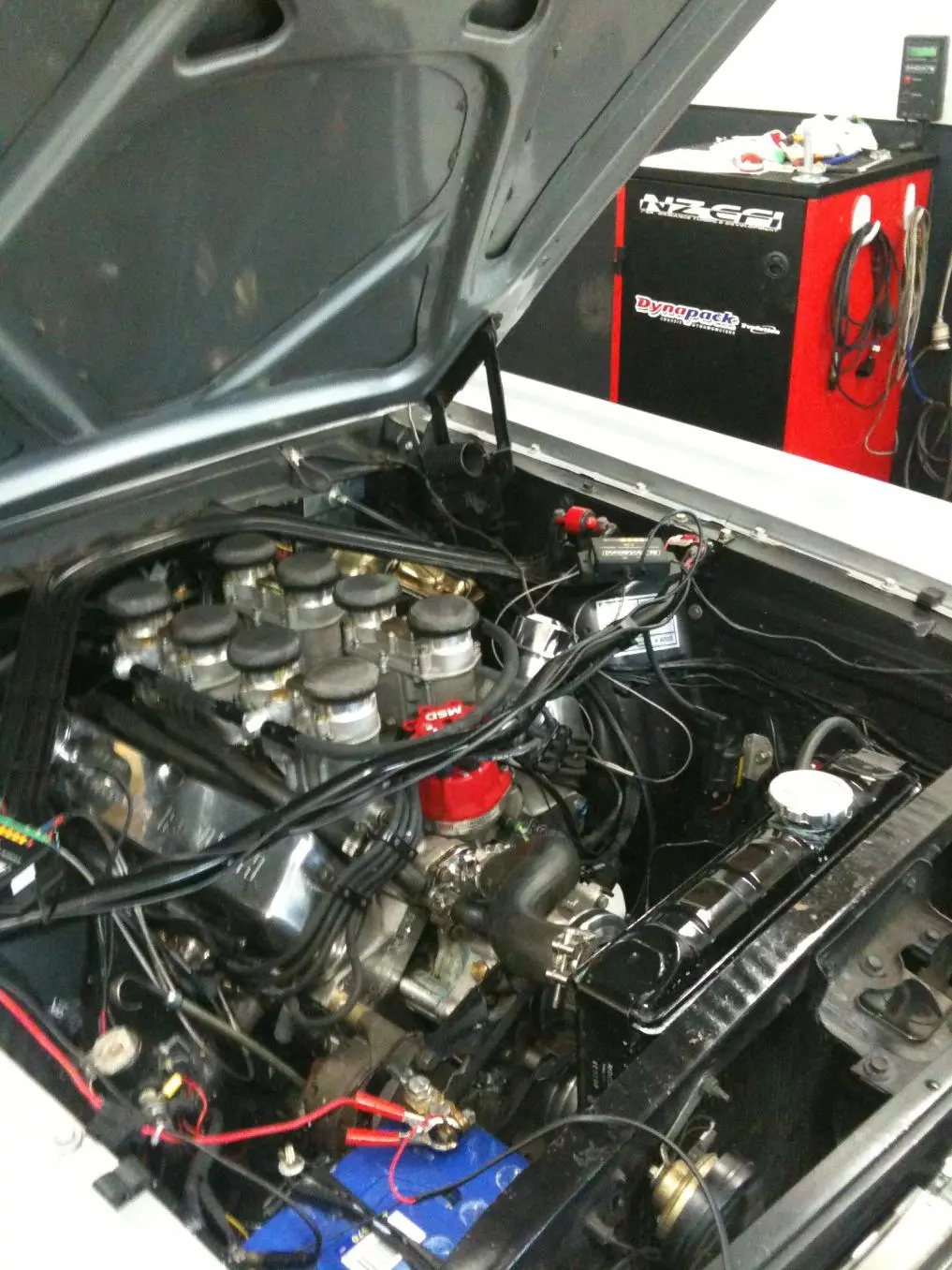

My '66 Fastback has a Roush 342 stroker with the Dynaflow TB injection setup. It makes 408 rwhp and 470 ft lb torque. Has a T5 and LSD 8". 600 lb front springs and Cobra Automotive rear - koni's, leaf springs, Global West shackel bushes and rose jointed under rider bars.
When the torque comes on in 2nd gear it starts wheel spinning and won't stop until I back off (195/14 tires)
The car is not set up for drag racing, it is set up for corner carving, and thats how I'd like to keep it. Any views on what I can do to tame it ?
