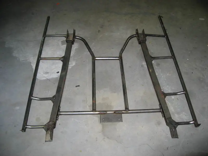

I installed these on my 67 coupe while I was doing a torsional rigidity test. I didn't see any measurable improvement. My car had many other modifications that may have affected their efficacy. I probably wouldn't install them again since they added weight but no sustantial benefit.
This is the full assembly before welding it into the car:
I didn't end up using the center brace as it also added no measurable benefit.
Prbably a better approach is to install the stock convertible bracing.
