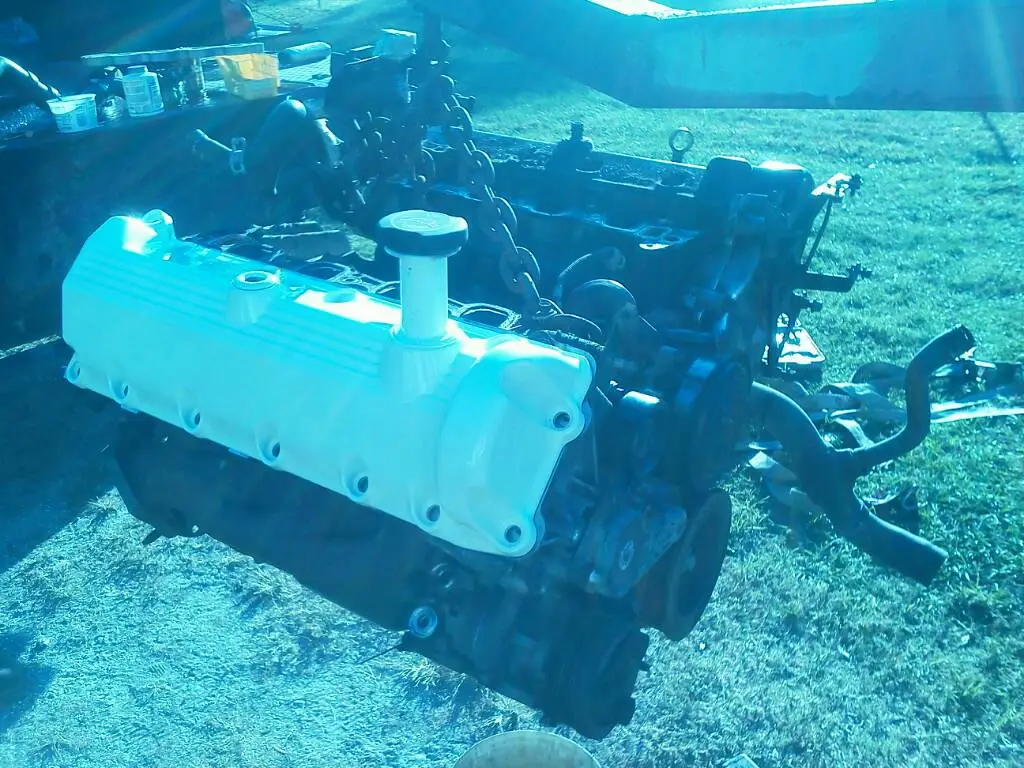

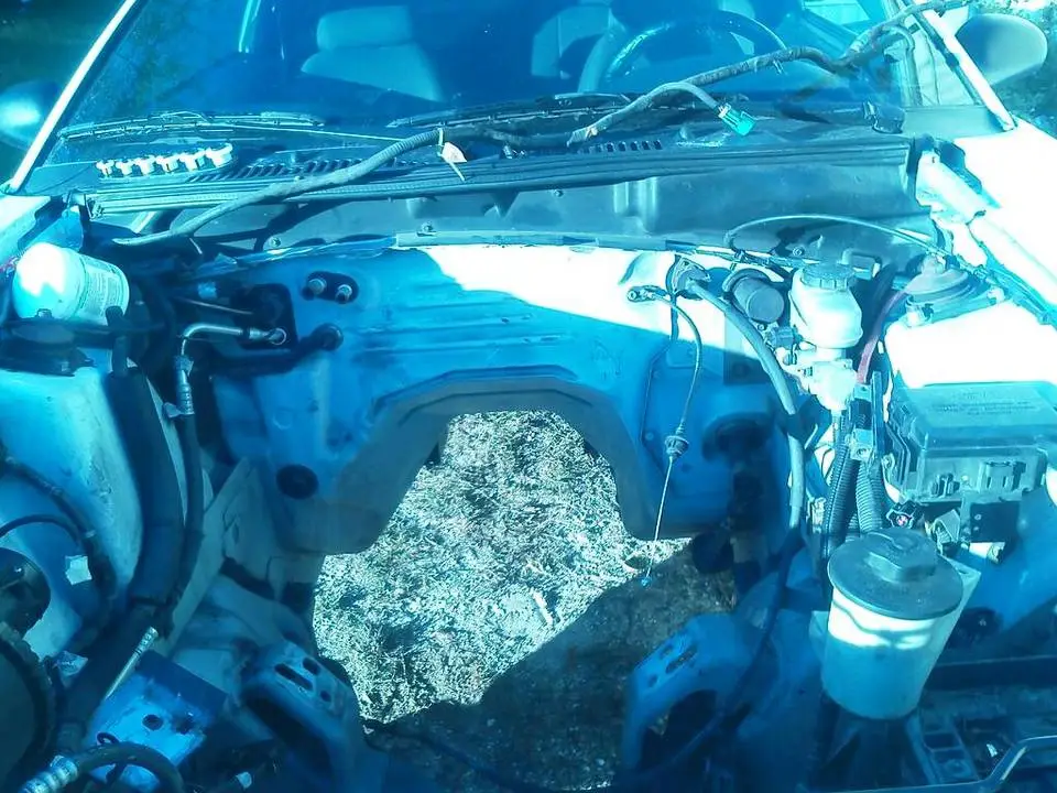

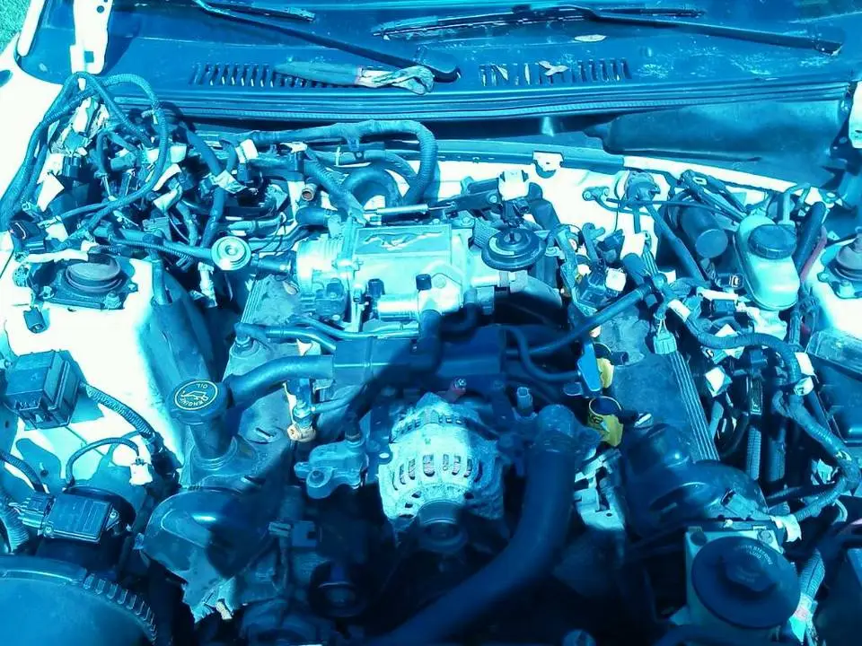

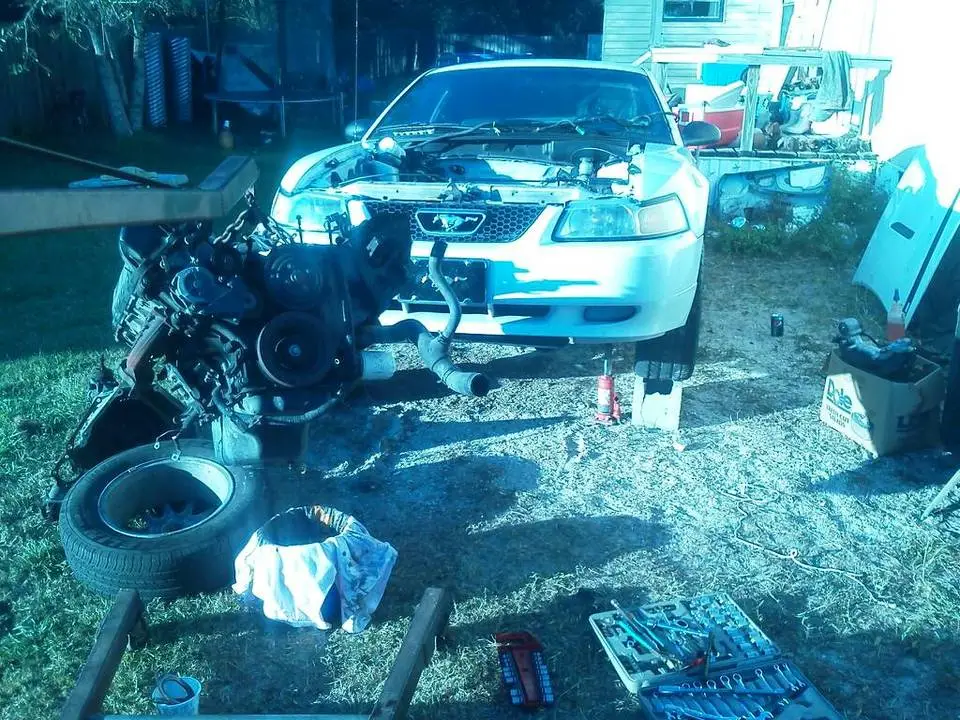

Well finally got some parts and time and gonna do a 5.4 swap on my 99 gt 5 speed.

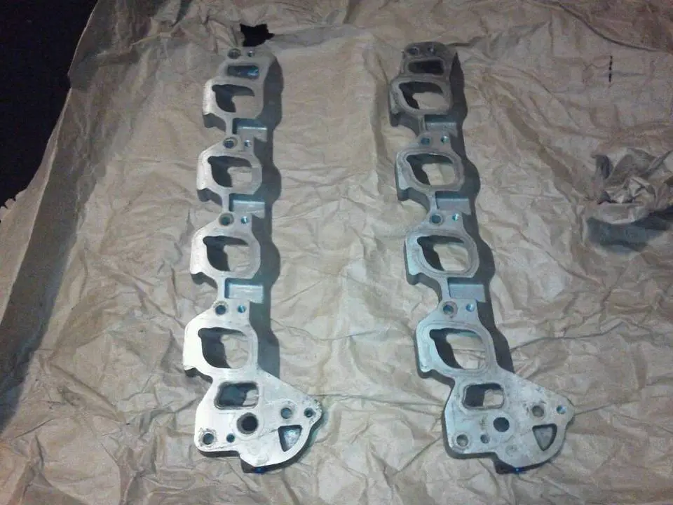

Rather get a intake but 4.6 spacers gonna do for now. Using a 5.4 out of a 01-02 expedition. Got lucky and my car came with the windsor and my cranks bolt patterns are the same.
Started with a stock motor with accell coils and flowmaster cat backs.
Got to here, need a cherry picker and a fuel line disconnect tool.
That damn starter bolt is fighting me something wicked. Any insight on that. More to follow.

I assume the top starter bolt is the one you're talking about? That is a mother F'er. Leave it out when you re-install, it serves zero purpose.
I used somewhere around 2.5-almost 3' of extensions, coming through the front somewhere between the k-member and motor mount. Swivel socket helps as well, you can shine a flashlight to where the bolt sits and guide the socket on if you don't have monster hands.

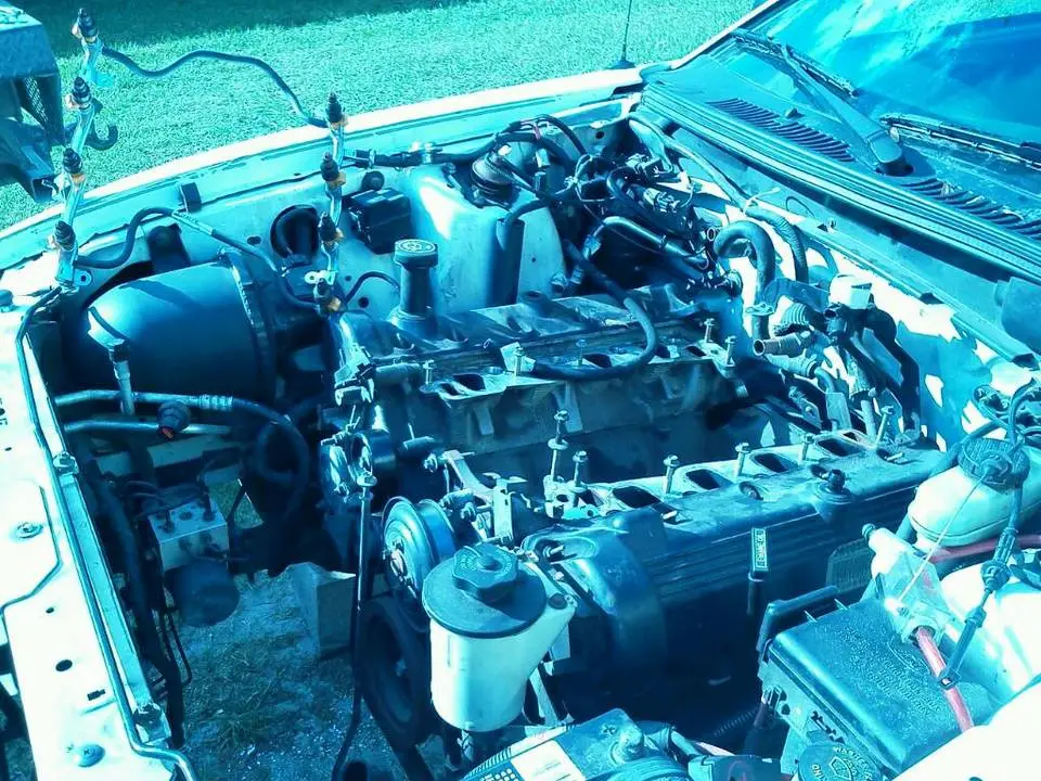

Got it in, had hella trouble getting the damn intake to not leak water, problem is I think it may still be.
I am getting a heavy white smoke out of the passenger side exhaust, higher you rev it worse it gets, no real distinct smell, but I am only using water no antifreeze yet.
Hate these plates, need a 'baller bad. And this dorman intake ain't helping matters either.
yeah, i did clearence the pan. Got either a bad valve seal or bad rings i believe. Smokes pretty heavy from passenger side, very back cylinder i think, not sure which number its called. if its just one cylinder i should be able to pull the coil on that plug to find it correct? just for diagnosing purposes of course.
