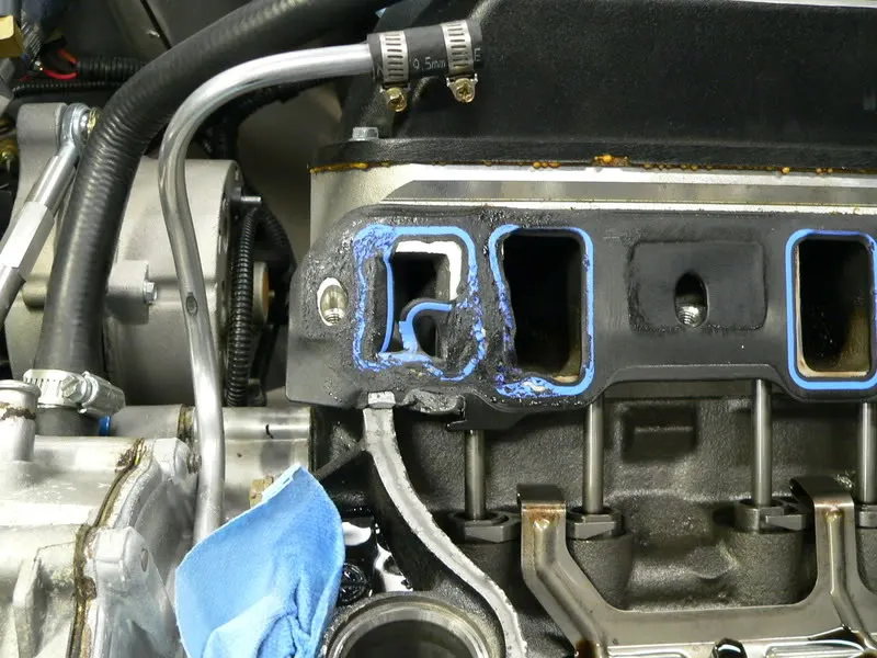

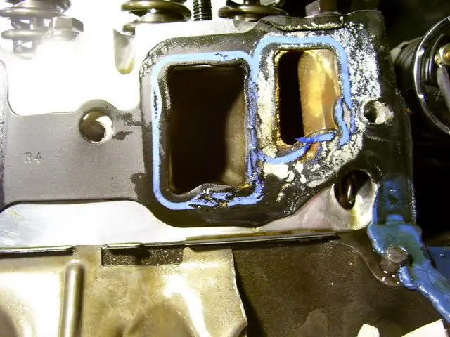

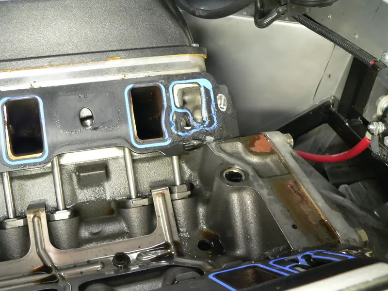

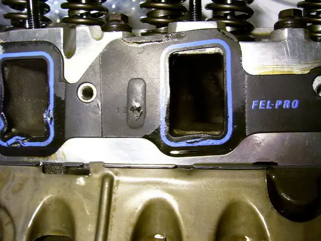

Wait till you've had them in a while and they start looking like this....
