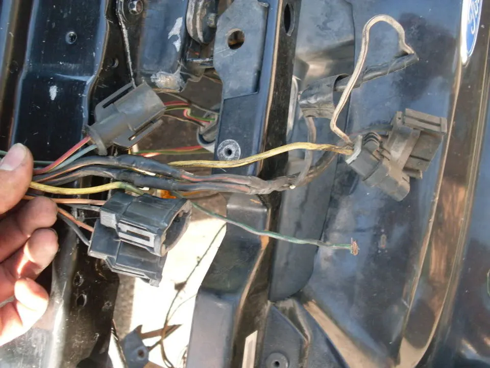

Good info but is there connectors on the headlight harness i call cut and pul the wires out?Cuz i stripped the harness down to teh bare wire no tape or nothin on it.And i laid it back in place in the headlights and theres 2 connectors on each side right by the headlights.Wasnt sure if it was for the fog lights or something cuz my car is a lx.Ill get pics to show you what i mean better.

The 2 connectors with a orange and black wire going to them is what i was think is for the gt fog lights even though i have a lx.Didnt know if ford just used a gt harness for all the foxbodys.
Basicly i guess it would make it easier if i knew what was all on the headlight harness side obviouls headlights but what else?Srry if it was me i would if kept track what was what.But i got the car like this and trying to figure out whats what b4 the engine goes in.

yes, foglight connector, here's a pic of one of the ones on my GT

yeah just pulled that out so only a few things left looking on google if im lucky might run across something.

well what else is on there?beside the headlight sockets and fog light sockets?I cant really see that lol.

know what the other 2 connectors are then?only ones i have left.
yea theyre gonna go to your alternator, see where they plug in

yeah i was thinking thats what those were i started looking at diagrams more showing 2 black and orange wires for the alternator.Ive got a 1 wire hook up but think im gonna go 3g alternator still.
