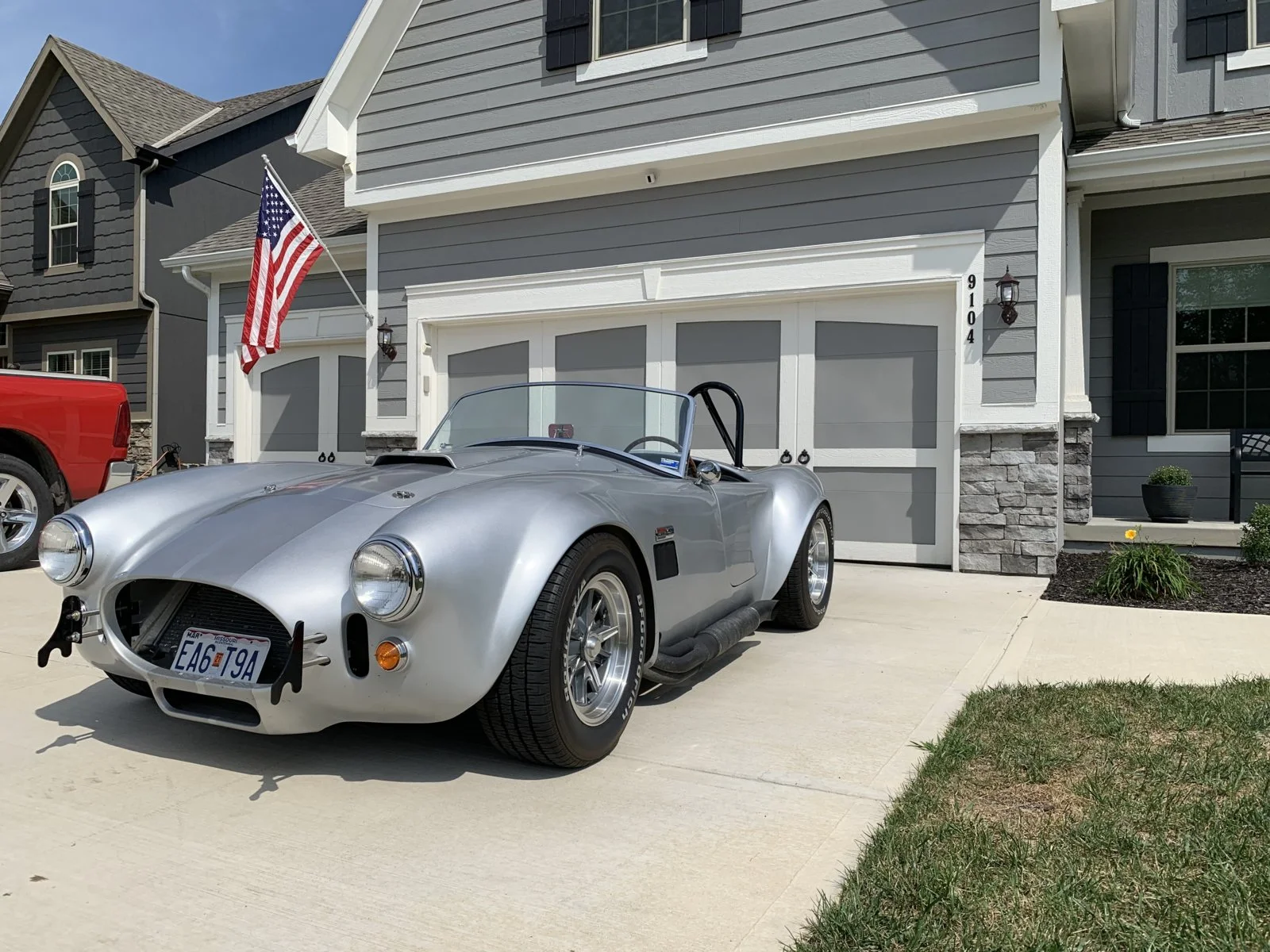

I did add a grounding strap to one of the mounting screws. (My install isn’t in a mustang, it’s in an AC cobra, but all parts are donor from an 1993 mustang). Wondering if I wasn’t getting a good ground.

this is a little different than a cobra kit car!
That was a little misleading, the advice may have been different if this was revealed in the beginning.
