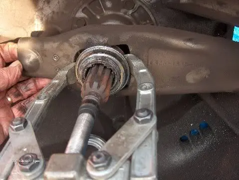

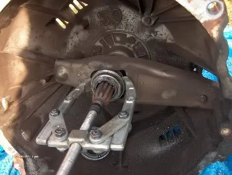

i didnt have grease so i bought a 3 jaw bearing puller from harbor frieght and had it out in a few mins with no mess

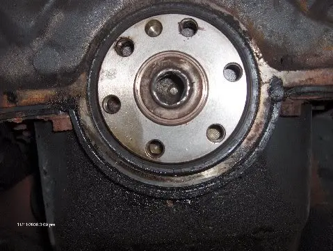

Pics up for you guys:
Me and my grandfather
Taking off the fly wheel:
Small leak:

LOL whats left of tob trany out of car...
Taking out the tob... (grandfather wanted to use his tools.... i wanted to just yank it out...)
Yeah baby im Dirty (lol just noticed the greasy ass hand print on the door LOL):
the TOB comes off a lot easier if you seperate the bell and trans. that way the input shaft isnt in the way and you can just remove the clutch fork without breaking anything else

Yeah, do the grease trick for the TOB. I rented a puller and STILL did the grease trick...
When putting everything back in separate the trans and bell housing so you can put the bell housing in easy... then the trans bolts up easy too...

And i personally would take the trans from the bellhousing to put it back together, man that must have been a pain in the a$$, much easier to seperate the 2 no wonder you where asking for advice on the top 2 bellhousing bolts.
