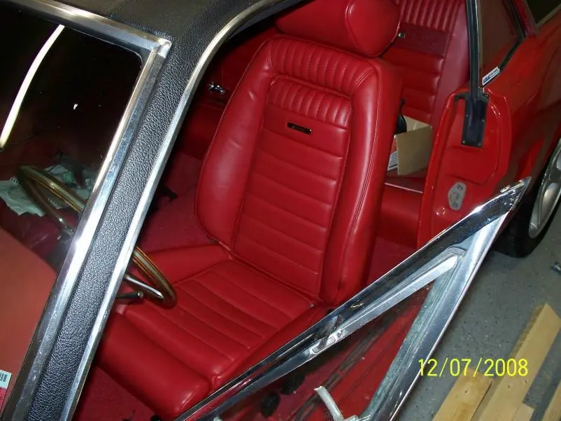

Here is my 65's seats.
Do you have a picture of yours?
