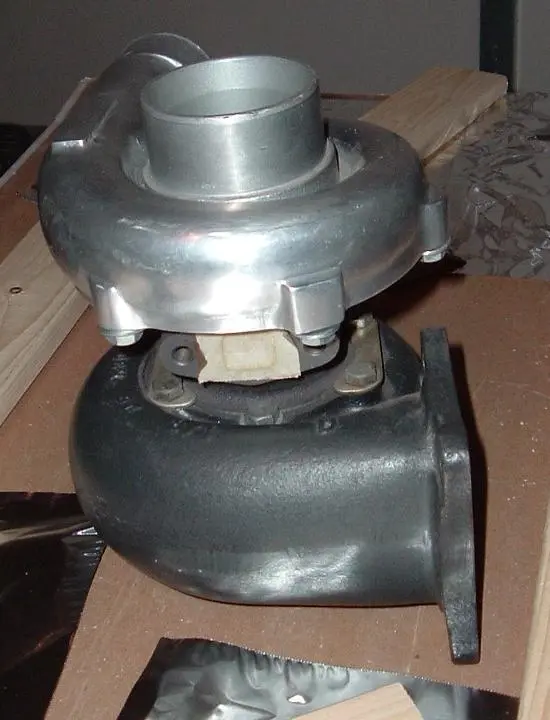

now my plan is to go with a single turbo, but i am working on finding someone to fab the hot side for me. the goal is about 350-400 rwhp with full boost by about 3000 rpms. i'm planning (hoping?) to keep the total under $1500. *edit* since it is a daily driver, i also need to keep the power steering and air conditioning.
here's the turbo ... it is a garrett t-4 h-trim with a p-trim turbine, 62mm on the compressor side, 66 mm on the turbine side. i got it for a good price from a guy on turbomustangs.com. the turbine a/r is 1.30 tho, so i am bidding on a smaller one i found on ebay.

I about crapped my pants when you said your exhaust side was a 1.30. I was just like, good luck with that on any 302 combo. But then I read you were looking for a smaller one.
You shouldn't have a problem with making the kit with intercooler for $1500 but you should hit a hair over $1500 when you figure in bov, wastegate, EBC, etc

yeah ... i found a turbine housing with an a/r of .69 on ebay; won it last night. it should be just right. getting the hot made is the most expensive part. *edit* the .69 was too small. i backed out of that deal. i found a .84 instead :nice:
i just won a .84 turbine housing on ebay for $40! it should spool up by about 3000 rpms and i can hope for 400 rwhp at 14# boost. :D
so i have the turbo for $330, but i can sell the 1.30 housing and get some back.

i think anything under .81 will be too small. i think the .84 is a great compromise for my goals.
Wait, did you buy the 0.69 or 0.84?? If you bought the 0.84, it should work out great.
