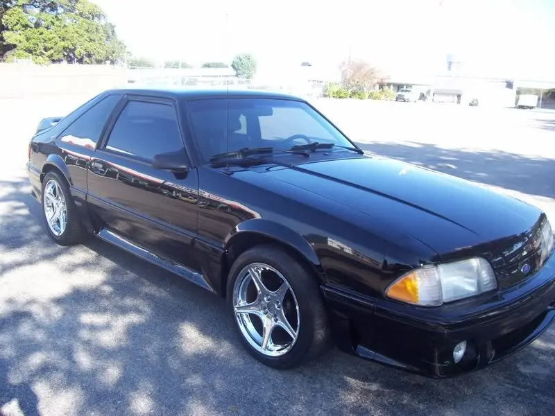

Mine are Saleen replica's. You will need 1/4" wheel spacers on front to clear. I put the spacers on rear as well just to make it look even. I think they were like $160.00 ea.????? Im running 275/40z17 outta rear and 245/45Z17 outta front. Wheels are 17X9 on all corners.
