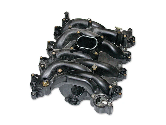

If it were me, I’d go with the ’01 and later GT. Not because one was any more powerful than the other, but with the earlier Windsor engine, you still take the chance that it’s got the all plastic lower intake manifold on it, rather than the later manifold that had the aluminum cross over section in the front. Won’t make a difference from a power aspect, but it could pose a reliability issue at the most inopportune moment. There were also small cosmetic improvements made to interior and exterior of the later Mustangs. I also prefer the Bullitt style wheels that came on the later mustangs, over the aluminum 5-spoke units on the earlier cars, but that’s really more of a personal preference.

anyway to check for the plastic intake by just looking under the hood?
Yep look at the coolant crossover just behind the alternator. It will be either black plastic or aluminum.
Here's the bad plastic crossover:

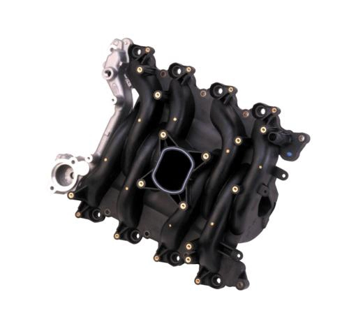

Here's the upgraded manifold w/ the aluminum crossover (notice the silver part in front where the stat goes).

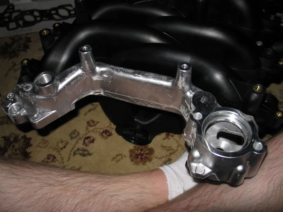

granted this is brand new in the picture, an aluminum crossover intake will have this on the front behid the alternator like n8 said:
sigh, you and your ninja edits n8 :nonono: at least yall can look at my leg hair :shrug:
