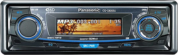

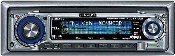

Well the CD player decided to start reading CDs again, when it wants to. So at least I have CDs..sometimes. I'm looking into buying this headunit next week:
OR
