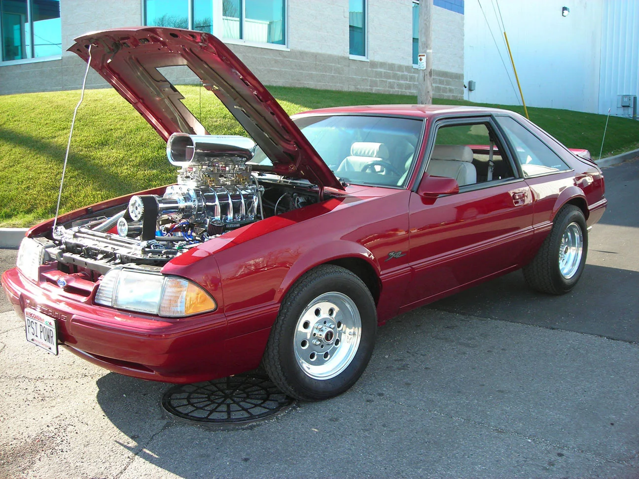

Carb gives you the option of a nice big Weiand blower which I'm all for 100% :nice: You could put this motor on non-roller block too but your cam profile will suck.
Looks like a father and son project to me. :D
Reactions: Adieu
I'm not showing him that picture!
