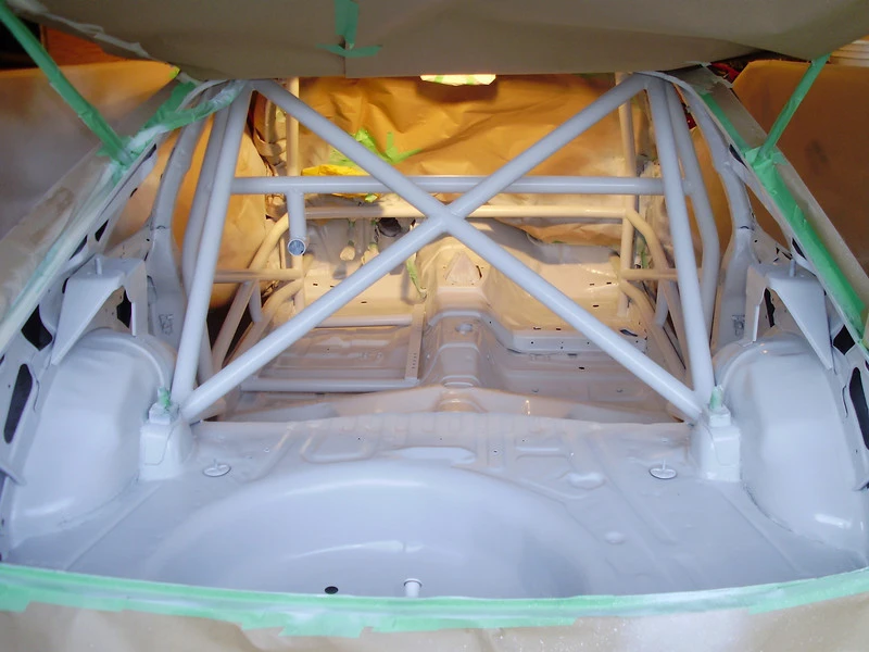

getting the race car back together and would like to clean up the wiring harness. i can see what i think is not needed, but would like a good schematic to be sure. does anyone know of a *free* online source for wiring diagrams for my 1991 stang?
ps... here it is last night... see? no wire :
