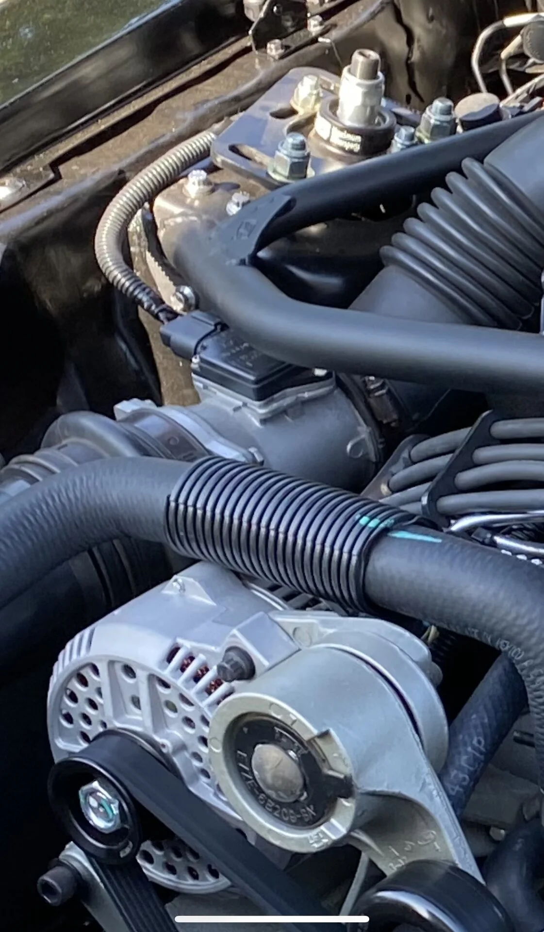

I've never understood how this works since it has that square flange on it? Means i can't use my stock air box... Right?A 94-95 MAF unit would be a compatible replacement as well, and 70mm vs the stock 55mm
That's interesting. Looks factory too.
One more question... Will the factory electronics not work on the 94-95 housing? As in, 89-93 electronics.
