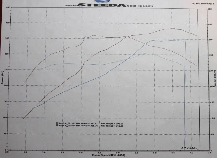

Baseline last month (before mods):
RWHP: 342 RWTQ: 306 :curses:
After CAI and Steeda-modified Tune:
RWHP: 370 RWTQ: 340
After Custom Dyno Tune:
RWHP: 385 RWTQ: 360

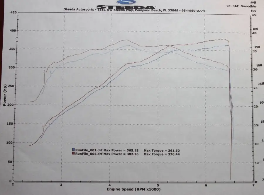

ALL these were done at equivalent Temps and in 3rd gear to compare apples to apples. When doing a final pull in 4th gear, we got:
RWHP: 382 RWTQ: 376
So if you compare the same-gear tunes, we picked up 43HP (+12.4%) and 54TQ (+17.6%), not to mention the response and firm shifts. We didnt touch the shifts yesterday because we're going to wait till I change the gears in a couple weeks to see how that feels first.
THe first graph is the comparison of the baseline and the final after tune. Not only are the peak numbers impressive, but look at the HUGE gap between runs between 4000 and 5500 RPM :salute:
The second shows a 4th gear comparison of 2 different runs, the second being after a few adjustments.

Actually, 4th in the automatics are the closest to 1:1.

If you want the car locked in 4th gear to dyno it, you load that tune first. Going by our graph, and what I have found searching around, the lower gear had hardly any difference in power but lower torque...as we went up, the torque increased. For our purposes, we wanted to see our gains, not so much "what is your max HP" so comparing the befores and after mods in the same gear still have us our relative increases, regardless of the hard number.
