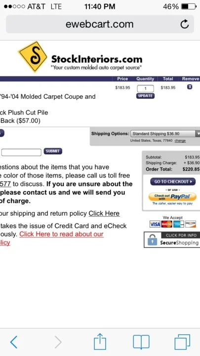

Acc carpet for 100.00 less than LMR.
Actually stock interiors is $26 more if you choose the $57 mass backing option and after shipping is paid.
Cj pony comes is the cheapest place I've found thus far if one uses their 8% stangnet discount. It's the same prices as Latemodel but late model's discount is only 6%. Shipping is free at both lmrs and Cj pony.
