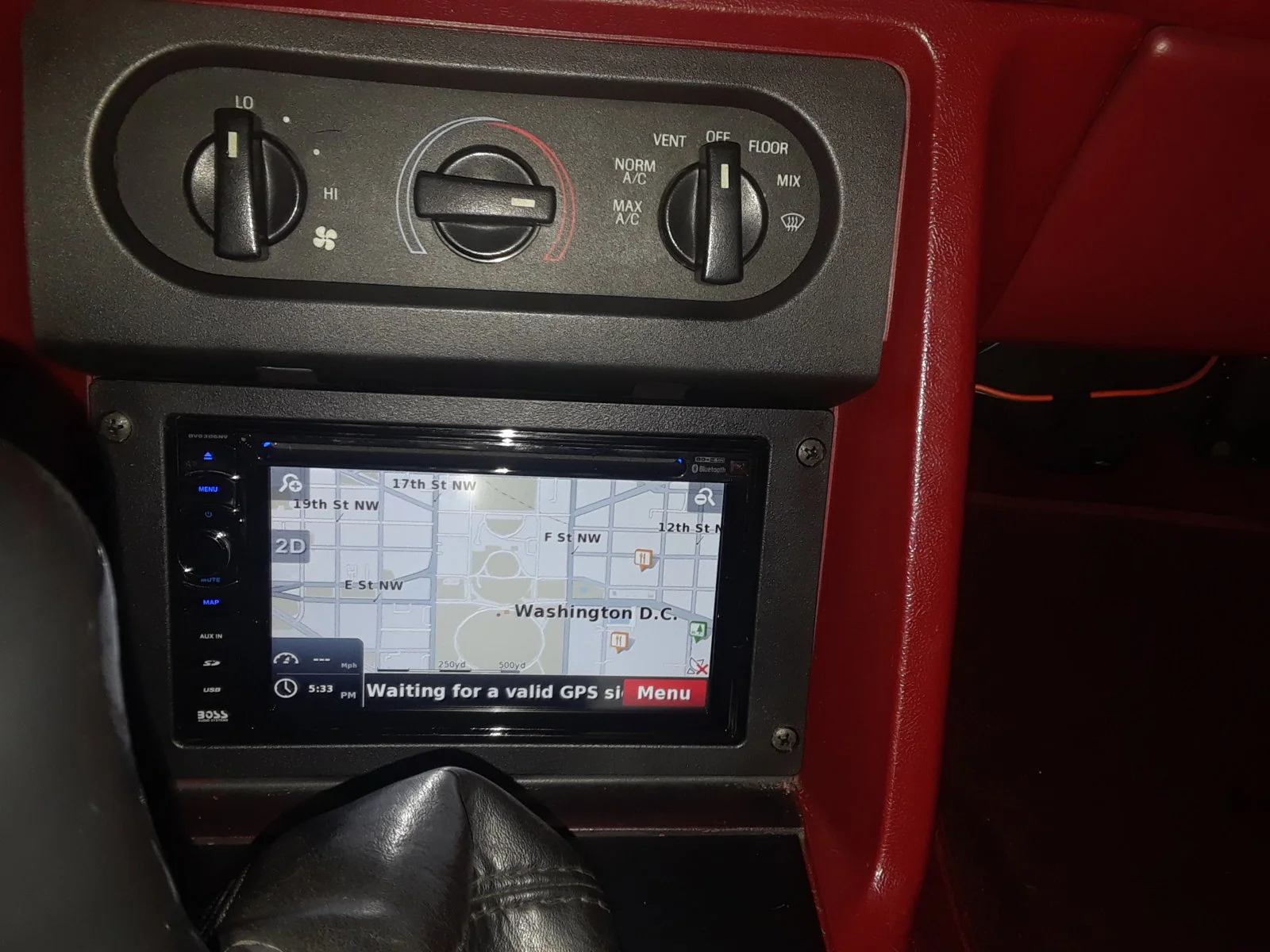

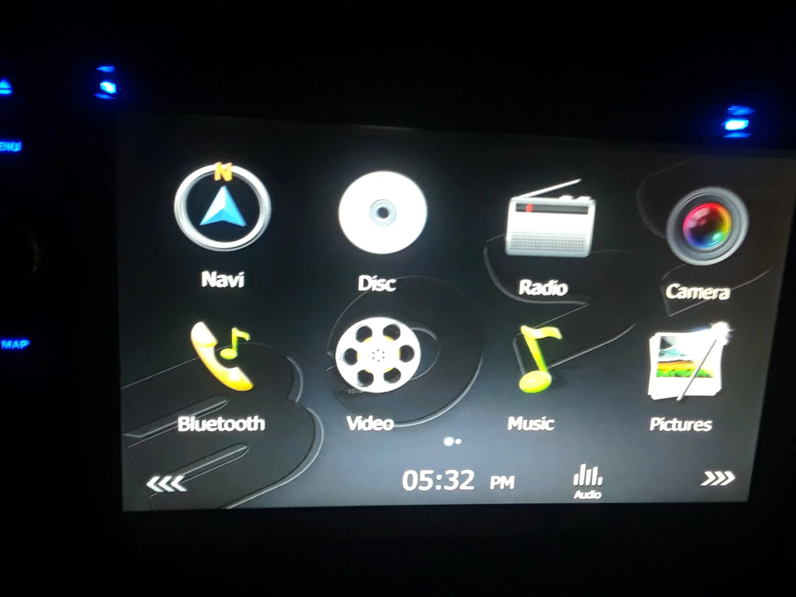

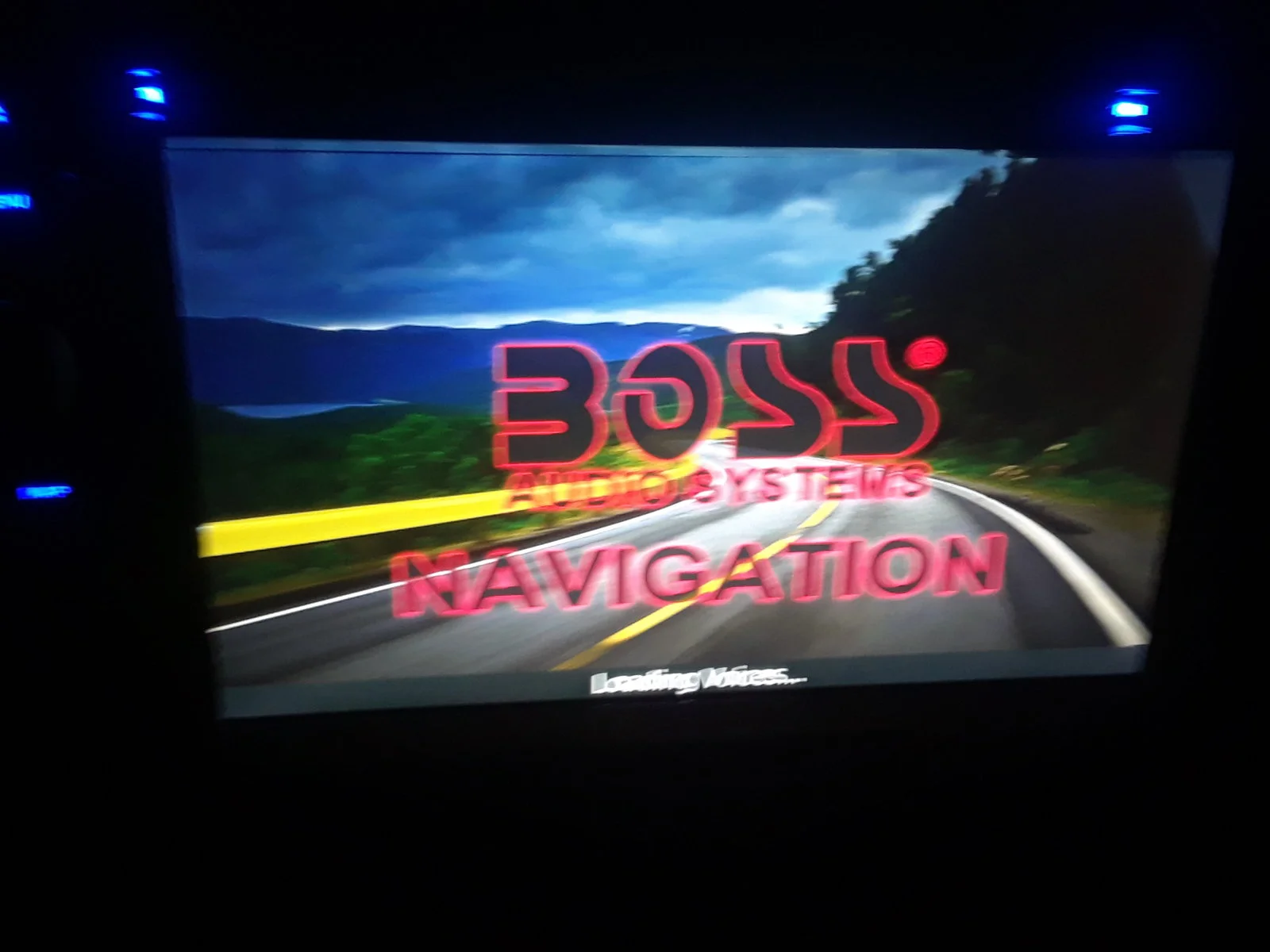

UPDATE: Finding My Way.
Finally got some navigation installed. It's a nice unit (built in nav, 4 channel audio, sub port, DVD port, USB, aux, Bluetooth, SD card support, single CD player, backup camera support, and 320 watts).

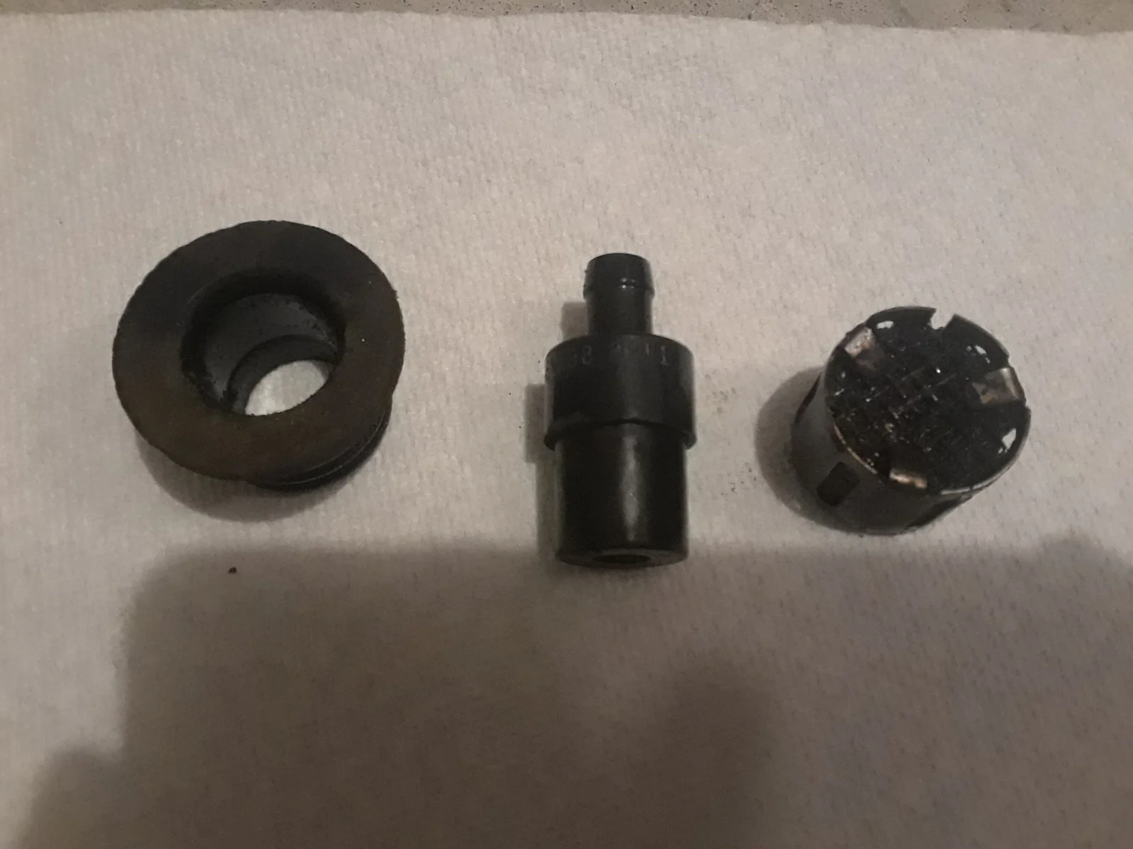

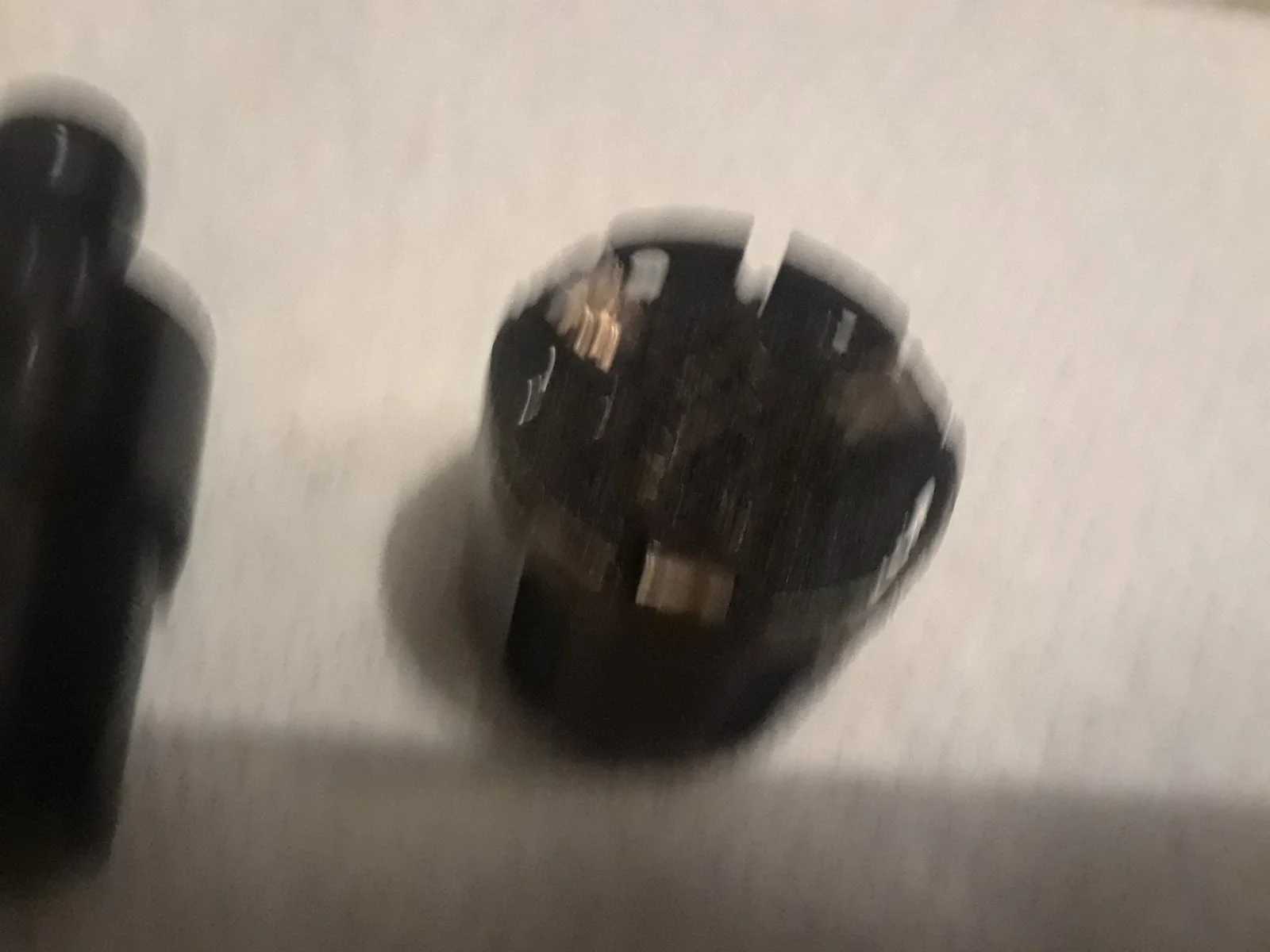

UPDATE: Positive Ventilation.
This is a really basic thing, but I decided to R&R the PCV system (i.e., metal screen, rubber grommet, PCV). As with the fuel filter, I didn't know when or if it had ever been changed. The car isn't burning any oil and has no evidence of blow-by in the MAF or intake tubing. I figured it was easy enough to change and [is] a maintenance item.
The vac hose to the PCV seemed that it had not been touched in years (if ever). The PCV was motorcraft. Was it original? I don't know, but it did still work (i.e., still rattled). The grommet seemed okay, but I changed it, too. Then, I got down to the screen. After seeing it I think I knew why the PCV was still working: not much at all, if anything, was making it through the metal screen! It was slammed full of sediment. Take a look below.
After changing the above items the car runs noticeably smoother. It also idles at a more normal RPM (850-900). Before it used to hit 1000 or 1100RPM at idle and hardly ever went to 900.
