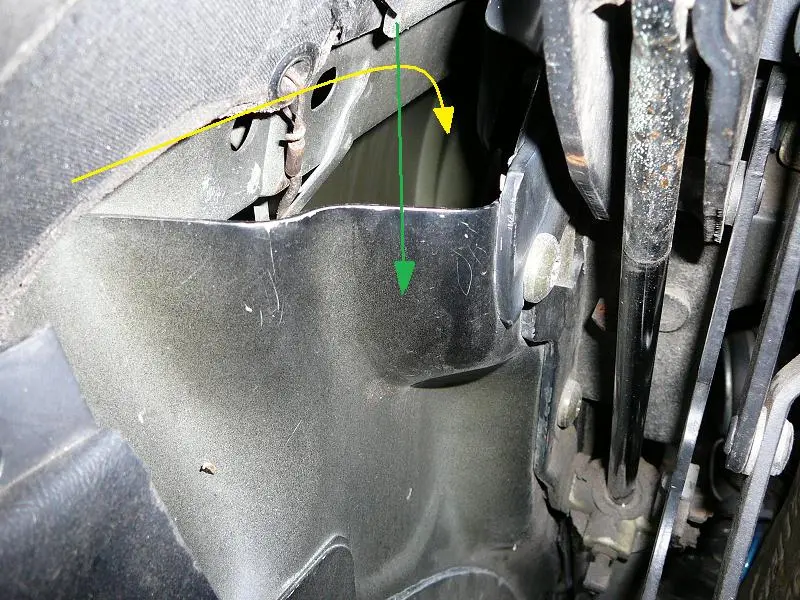

in this pic of the area you are talking about from the inside, any water is supposed to stay on the yellow side, which is designed to route it back to the outside.
in my case, there is a drip that comes down on the green side. that water collects under the back seat, and if there is enough, it spills over and collects in the floorboard behind the front seat.
i rigged up a ghetto thing with a cut up top from a plastic butter container to get the drip to go to the correct side, but it is not permanent and i have to remember to take it out when i put the top down and put it back when i put it back up.
