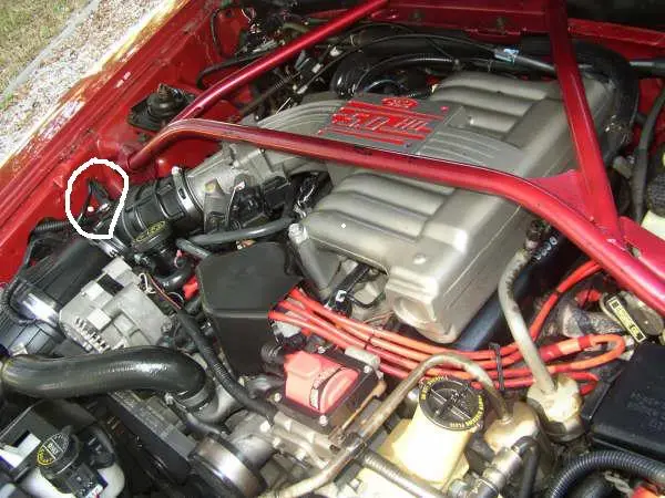

On your air inlet, there's a sensor behind the MAF sensor. It screws into the air inlet. That's the IAT.
bill302
Nov 2, 2005
2,131
46
alabama,gadsden
Jul 21, 2006
  • Jul 21, 2006
look in the white circle....
