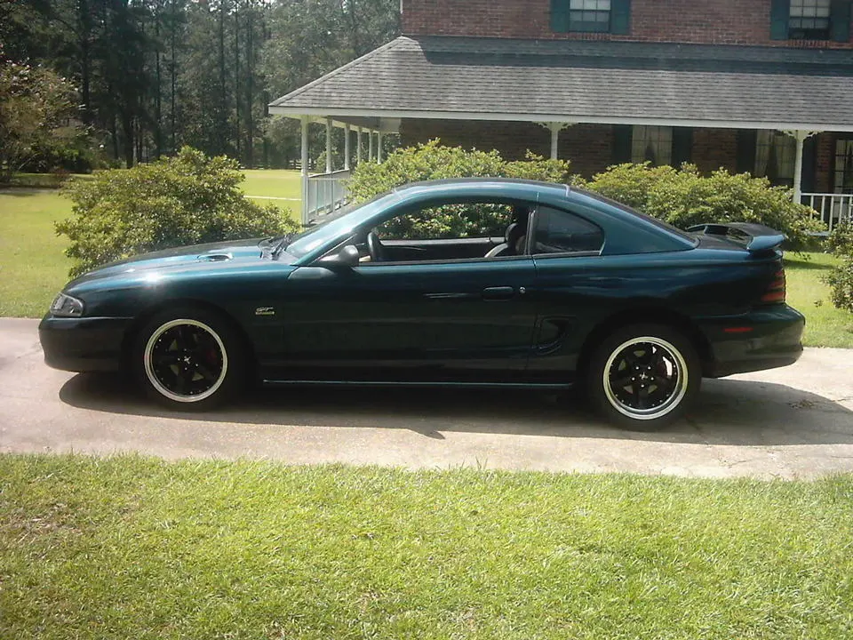

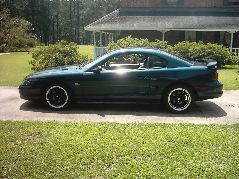

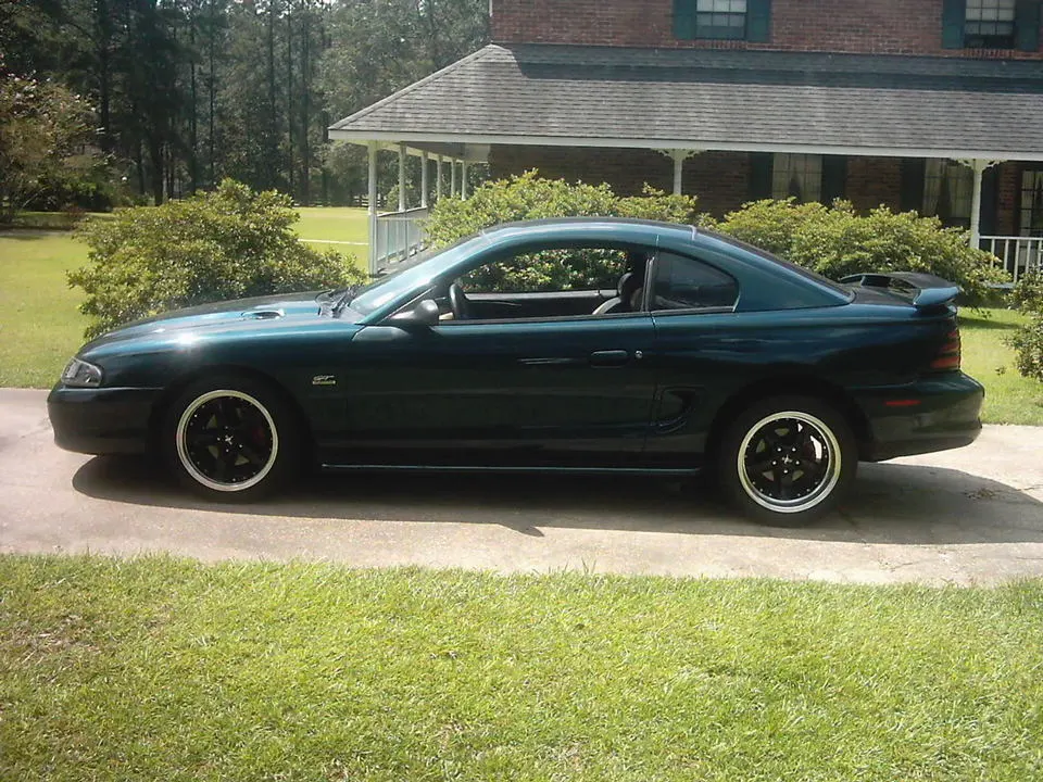

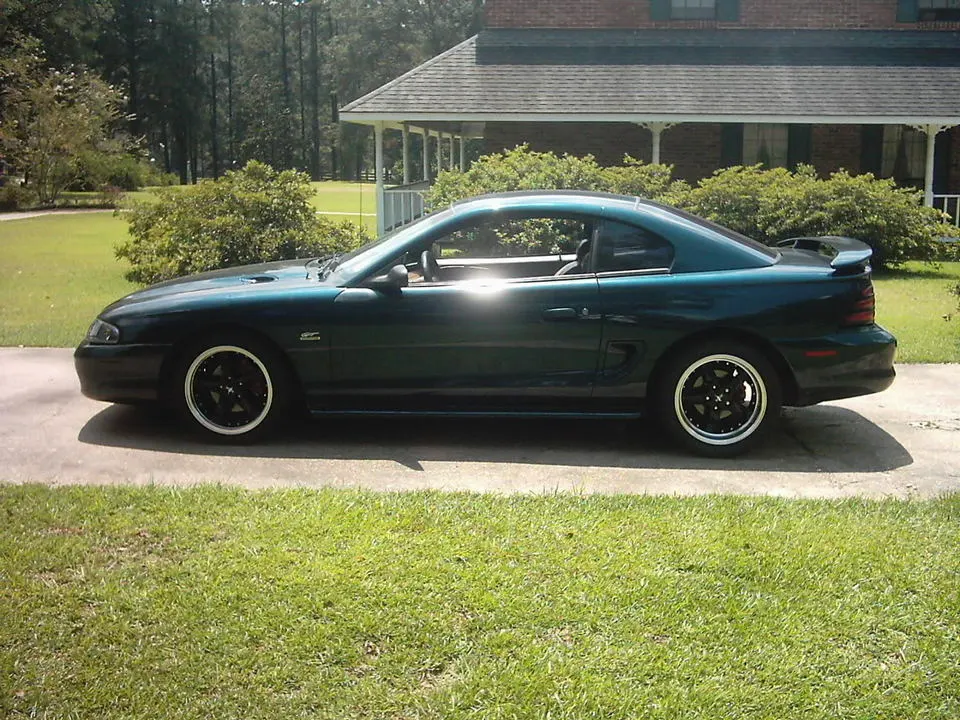

Just the front lowered. Didnt like it.
And all 4 corners lowered. LOVE IT.
I havent really ridden around yet but the ride should be better than stock.

Its about time! :D
Big improvement! The ride should feel alot firmer. Take it around some tight bends, you'll be amazed at how well it will stick to the pavement (just don't go nuts on public roads).

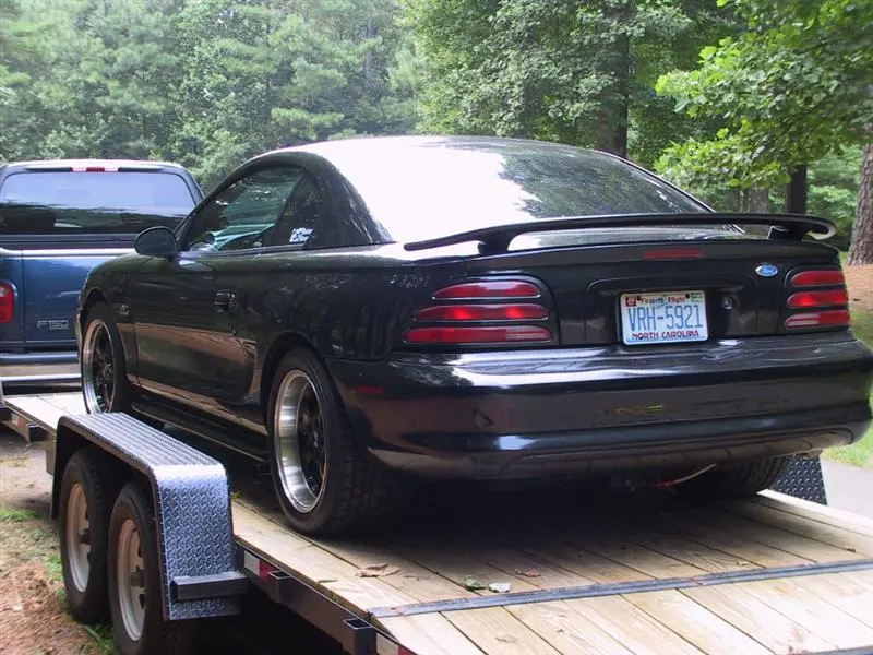

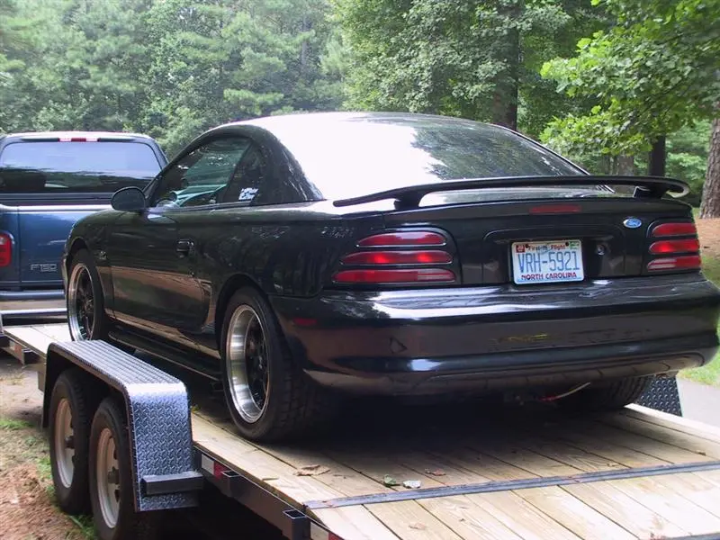

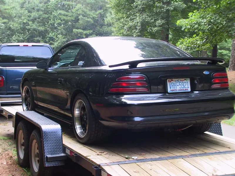

now I just need a 347 and to paint my car black.
