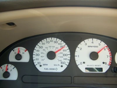

I Took a few pics of the speedo the first one is me in 4th does the speed and tach look right... and the other pic is me in 5th..... :spot: LET just say I WALKED AWAY FROM EVERYONE :nice:

On a additional note, your Tach should be more accurate. Going off your RPM's of 5800 in 4th with 3.73 on stock tires with a T-3650 tranny You should be going 118MPH. At 3900 in 5th you should be going 130.5 MPH. I would say your spedo is a tad off ~6-8 MPH at those speeds.
