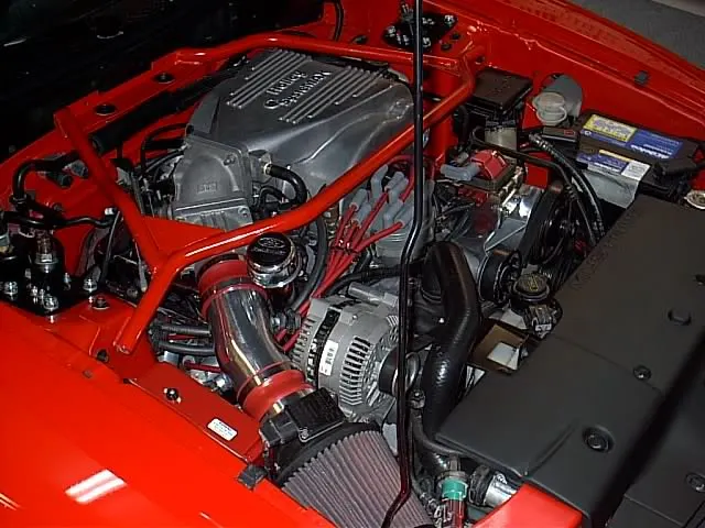

Since you have a CAI (not sure which) you could do what I did (see pic below). I used half the kit and ditched the 90 degree bendy part.

Dammit Joe, You make me jealous with your engine.:nice:
I looked at Brenspeed and see what your talking about CAI not working, I don't like the look of the heat box that comes with the inlet, meter, etc. You set up looks nice. I like the way my filter is in the fender well, I prefer that over the box but performance is more important to me. I agree with both of you regarding the injectors, I was just hoping not to have to pull the intake.
