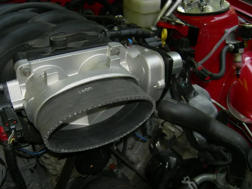

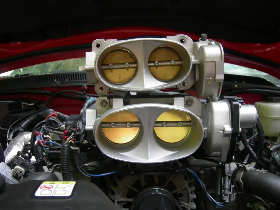

I just installed the MSVT TB on my '05 GT a couple of days ago. It's the twin bore 60 mm Tb that came on GT 500's I think. There was a little bit of "adjustment" to make it fit but I got mine from CJPony Parts for $129.00 shipped.
EDIT: LINK >>>---> http://www.cjponyparts.com/product.asp?pn=TB100
You can see the difference in size, not only the bores, but the mouth is larger requiring some creativitity to couple it to the CAI... I am still shopping for a decent coupling.
EDIT:
The coupling for my CAI easily fits "INSIDE" of the new TB, instead of OVER it. (EDIT) So I had to make an adapter to make it fit the K&N intake tube. I installed a JLT yesterday and the coupling stretches enough to make a good fit.

Casey4s, I'm not trying to be a smart-ass but wouldn't your coupling method create the same air restriction that you are trying to eliminate with the bigger TB? Could you use a GT500 CAI instead? There also seems to be a gap in the top right of your coupling that will cause unmetered air to enter the TB. Remember, there will be negative pressure there, so there will be nothing to prevent the coupling from collapsing.

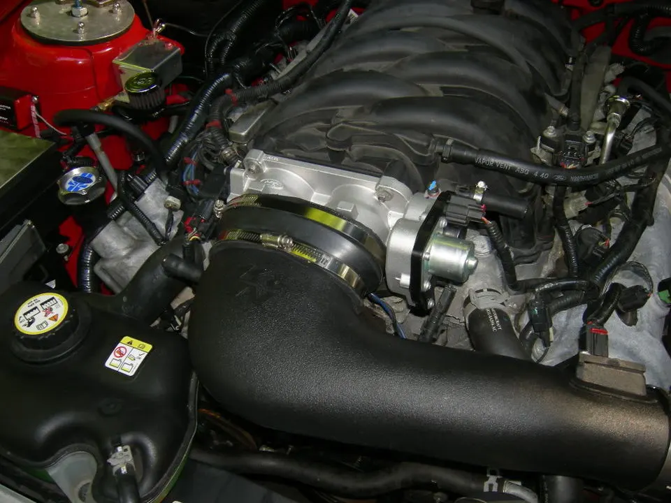

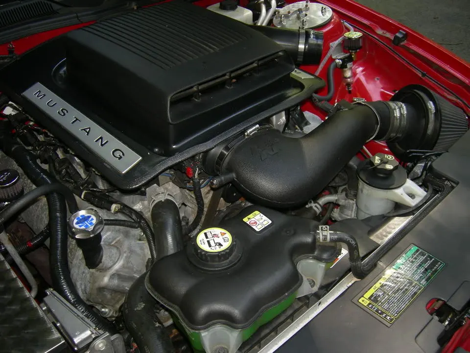

That photo was just to show that the CAI coupling was way too small for the GT 500 TB.
What I did was this...
No leaks but not as neat as I'd have liked though.

That looks much better. Any noticeable performance difference with the new TB?
