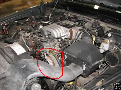

I want to install the alternator where the AC compressor would normaly be.
Can I run the alternator like this in a fox ? VVVVV I am trying to gather some info.
I have been searching for hours and cant find good info on moving the alternator there like a crown vic or grand marquis.
Any help is apreciated
FWIW, the '90 Town Car I had with a 5.0 had TWO belts on it, so I wouldn't count on things lining up right with the alternator mounted up with a Panther bracket. Can't remember right off hand if the water pump was standard- or reverse-rotation, though... :scratch:
I put a set of belts on one of those at my shop the other day and they are a standard rotating w/p....or...well...it runs backwards from a mustang....yea, which is standard....? You get what I'm trying to say tho....lol:D
