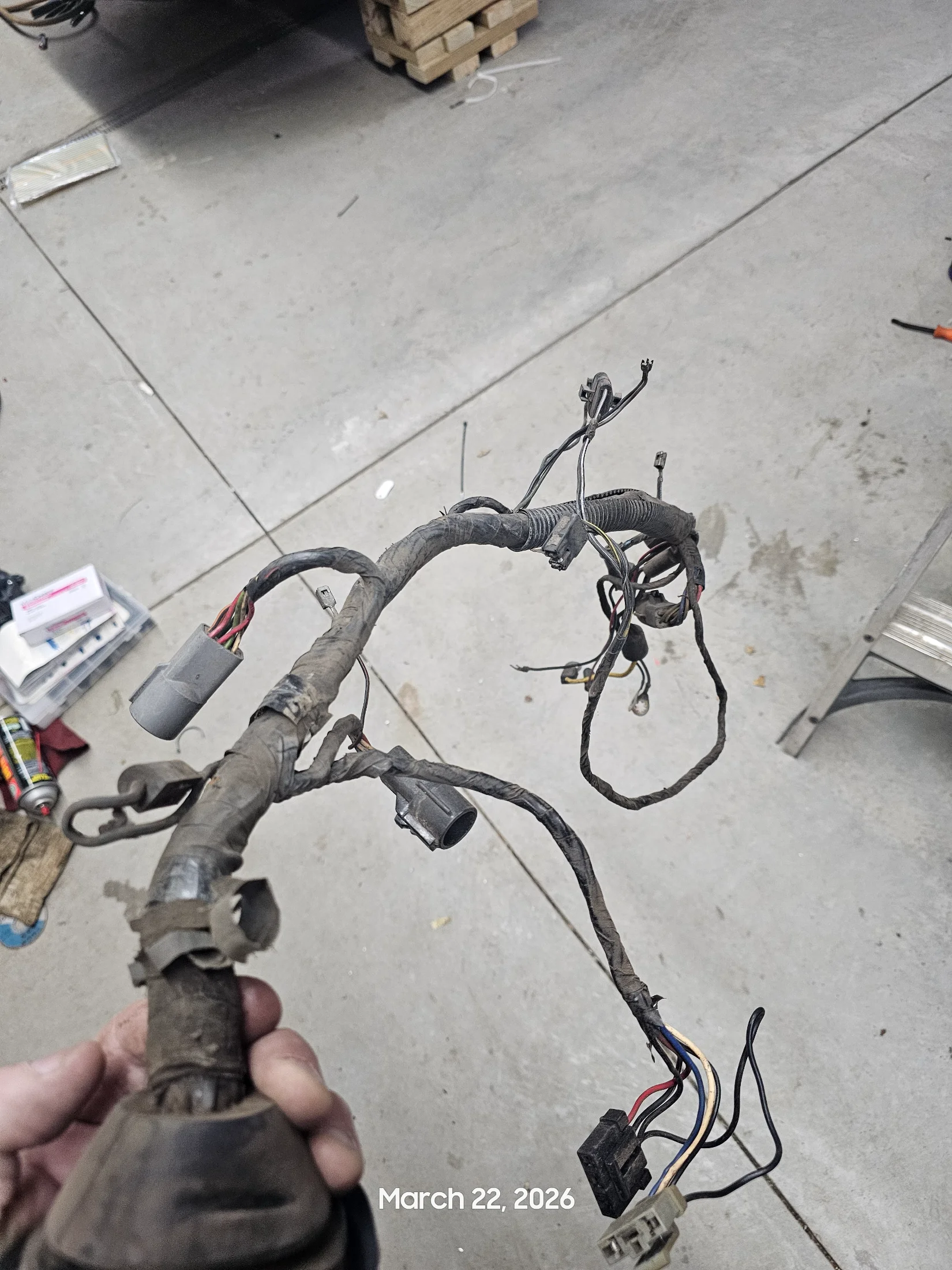

I just did the heater core and I'm having a weeeeee bit o' trouble getting the dash back in. Harness tape has rotted and the attachment sites are all failed. Have new tape and plenty of zip ties. Need a good image to reference how the harness is supposed to sit.
I have some more questions including a chunk cut out of the harness... I'm not too worried about it. Must have been cut by a previous owner and I drove it that way for years. But still...
I'm gonna spend today redoing the tape and marking where the wire clip things used to be.

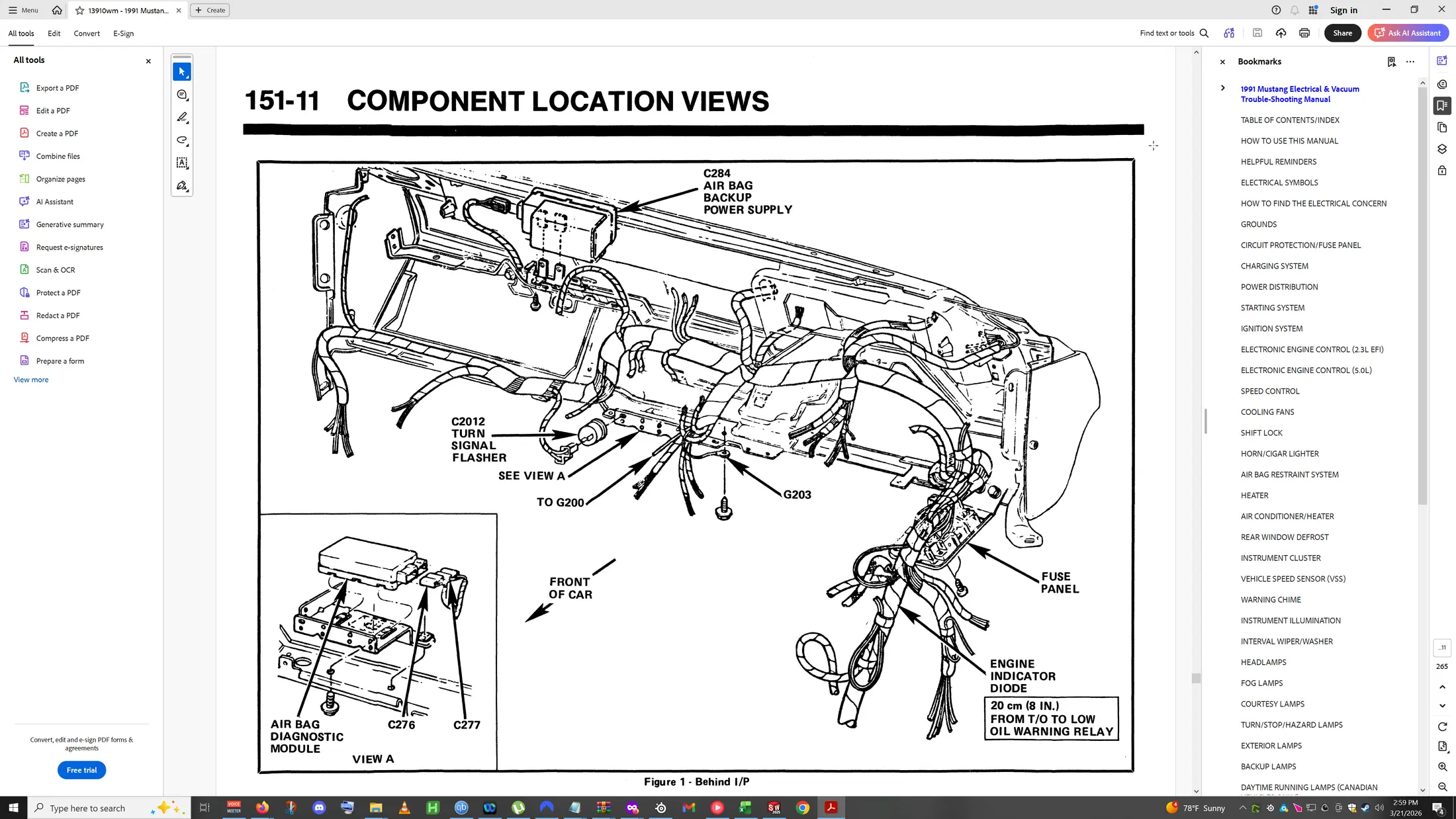

Thanks for the direction. I went a head and acquired one for the $20. It'll undoubtably be helpful all over the car. But in this particular case, it's not giving me the image I hoped for.
I'm looking for one that shows where the harness attaches to the firewall. The best I can find in the guide is showing the harness and the dash. Not useless, but not as useful as hoped. I could still really use an image showing where on the firewall the harness is expected to hang from.

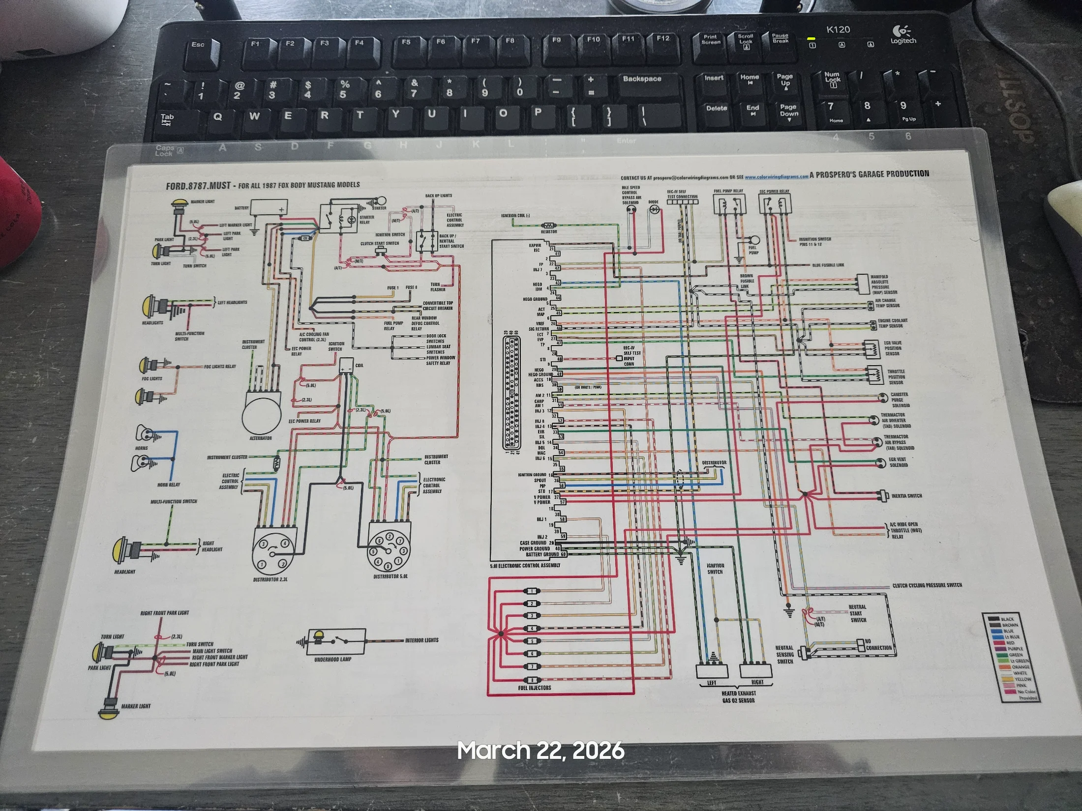

Also... Can't stress this enough. Look for full color wiring diagrams on Ebay for your make and model. I picked up several sets for different years. They're all laminated 11x14.

Diagrams seem pretty accurate? I found them 11x17 laminated, but for $34 bucks it better be good.

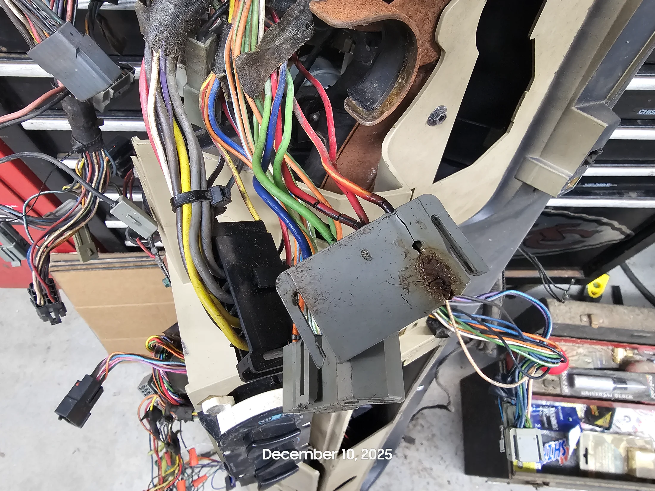

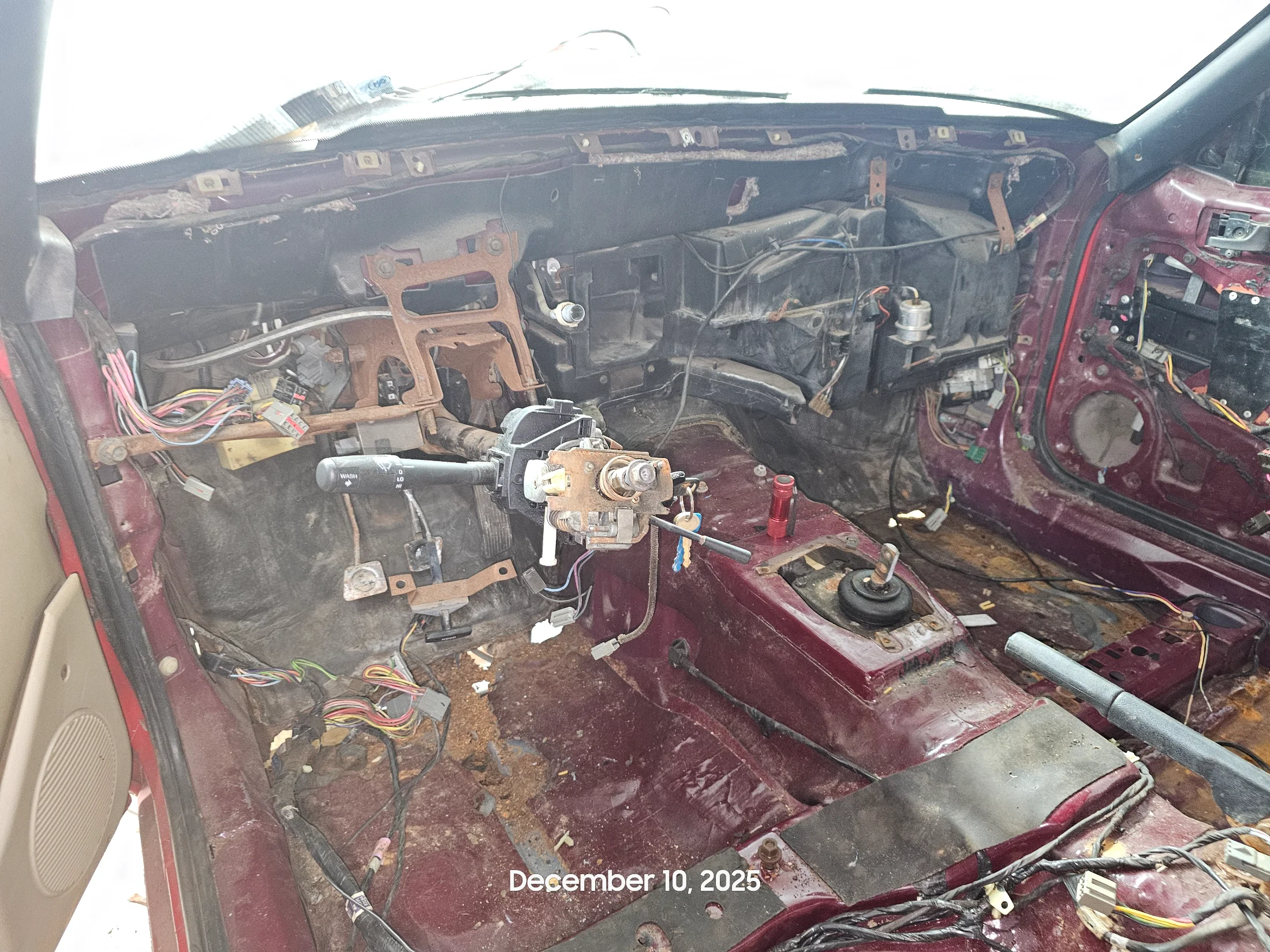

Just pulled the dash from my 87 a couple months ago. There was a small bundle that was attached along the top side near the windshield. I wasn't really keeping close track of where everything was either, I've had the dash out of my II, all of the wiring in that turned out to be pretty self explanatory, I expect the GT to be about the same. But there are a pic or 2 more that may help on my vert thread if you wanted to browse around there, but this is right after I removed the dash. You can see the wires that I'm talking about here, but they are not part of the dash harness.
You may be right about the size. I have a post around here somewhere with images of mine but they are here:
11 x 17 COLOR Wiring Diagram for Ford 1990 Mustang (Fox Body) US Spec 7 pgs | eBay
Make & Model: Ford Mustang (Fox Body Style). YOU WILL GET A DIAGRAM - NO MATTER WHAT. Prospero's Wiring Diagrams presents 11 x 17 - Bigger than other wiring diagrams. The Quick and Dirty on Our Wiring Diagrams.
www.ebay.com
Just search for the year you're after.
Also: They split up the years on those diagrams. They're not all molded together with tiny little notes that say, "this year only" in the fine print.

I have a 5 foot snake I'm trying to thread back through the dash. All the attachments to the dash had failed so I thought that was how it was supposed to come out...

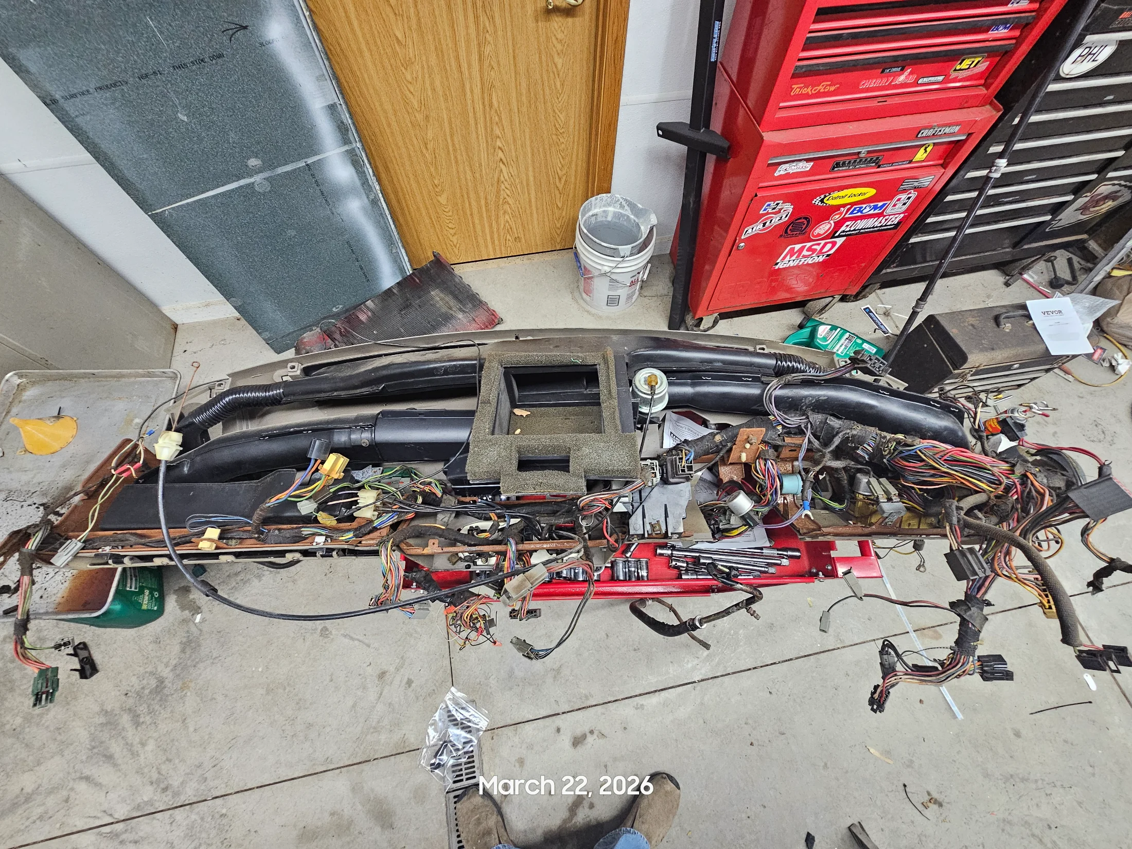

The harness is still attached to my dash. You could probably reinstall it and throw it back together, I wouldn't think it would take more than an hour or so to do, which would only be an extra hour added to what you have going on. I mean we all f*** up, unfortunately it's the best teacher.
Anyway, here's a quick pic of the backside of mine for some reference.

Took a quick look before I lose light. I don't see how I'm supposed to get that disconnected. My bundle seems to go straight into the fire wall.
View: https://youtube.com/shorts/pMAB-betW6o
If I can get it out I'll try to get it re attached to the dash. I just don't see a clip to undo. Can I get a look at the drivers side of the bundle from the side?

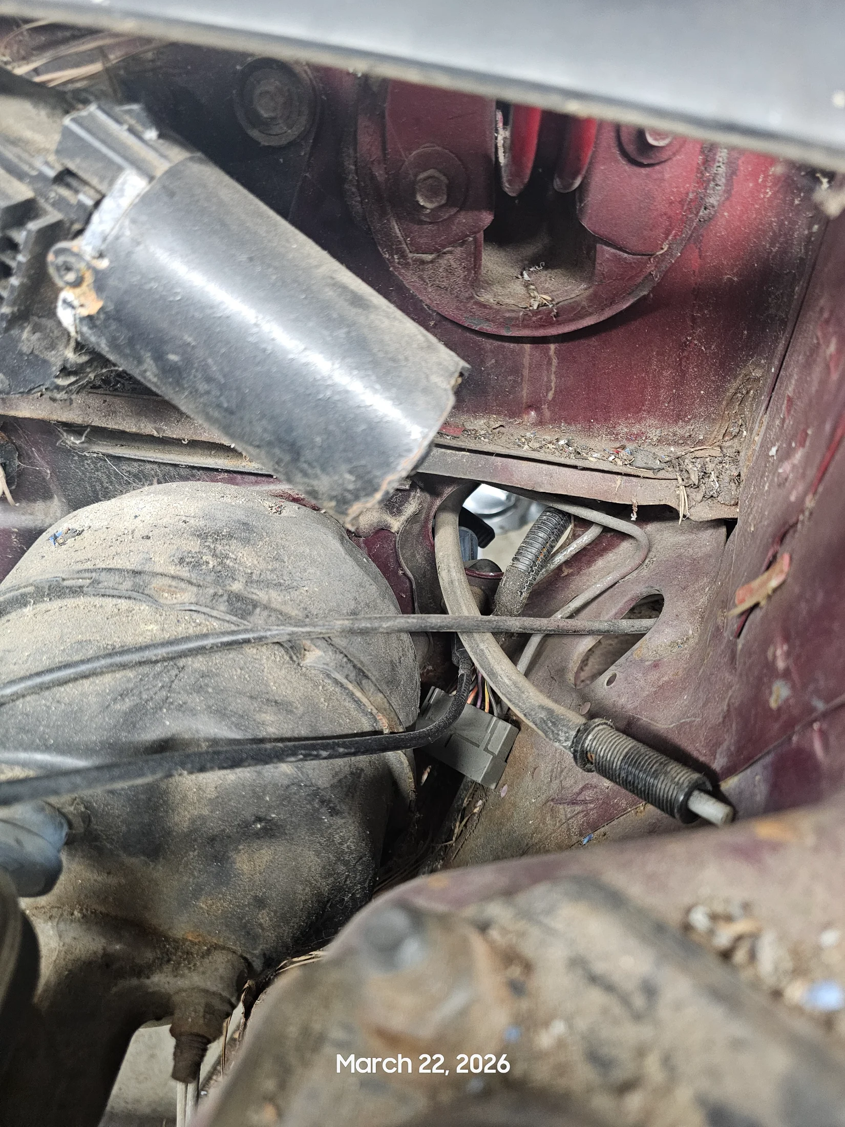

There are a few connections in the engine bay, then the harness runs through a large grommet through the firewall.

That section of the harness runs between the brake booster and the fenderwell. I have a few things sticking out of it to keep them out of my way while I work in the car, but here's the location:

Oh, and this is the size of the diagrams that @Noobz347 is talking about. I've not really used them yet, but they are pretty damned nice additions to your tool arsenal.

Look how pretty they are.
The first set I bought was for my 86. I liked them so much that I bought a set for 89 and a set for 91-93.
Trace a line with a grease pencil across multiple pages... They work great.
