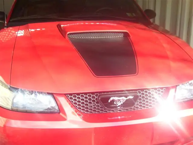

I did paint (using black satin fusion) the chrome around the stock horse honeycomb grill pic below....
