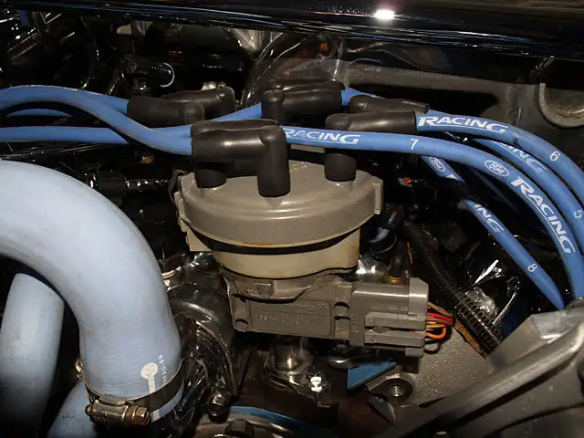

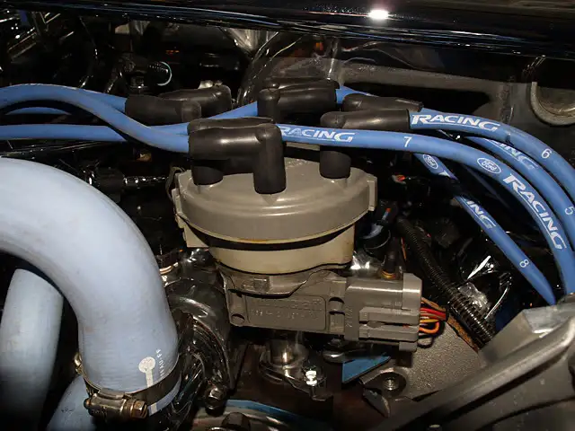

The fix is to rotate the distributor two teeth counter-clockwise. It should end up looking something like this:
Note the orientation of the distributor control module.

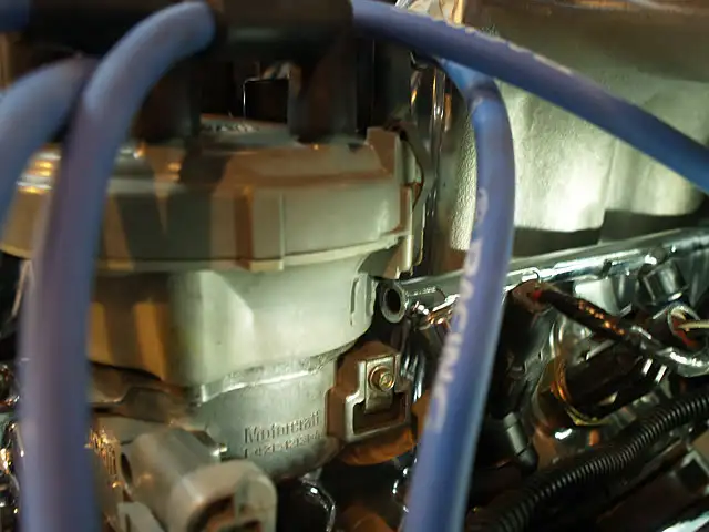

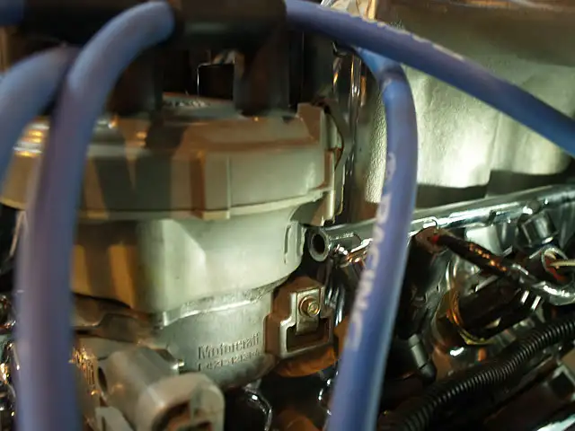

The problem with this is that now the boss on the bottom half of the distributor cap will be trapped inside of the driver's side fuel rail. The fix for this is to grind off the boss to allow the distributor to rotate past the fuel rail.
