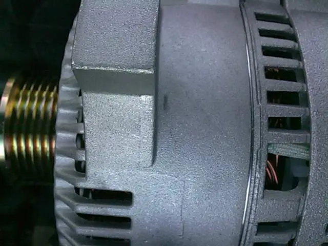

Hmm.. it's the PA Performance 130A 5.0 upgrade alt. The one I had been inquiring about a couple weeks ago, and LRS rep responded. It's here somewhere. In their instructions, PA noted that all that needed to be grinded was that mid section rib that protrudes out. Thats the part that a protruding bolt on the alt will hit (alt body also) . But also, the portion at the top end where the upper mounting bolt goes. To put it simply, the alt is a pinch wider than the top mounting area, so it hits the alt body before you can push it back far enough to meet the bolt hole (it was about 1/4th of an inch off.

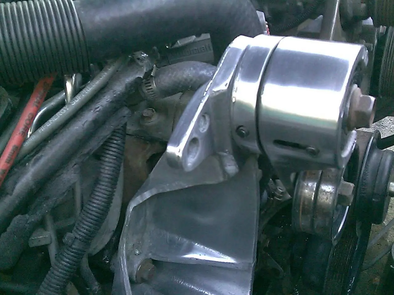

Are you talking about the march style alt bracket? With the stock alternator bracket you should only need to grind the bottom part of it down. If you are using one of the march style brackets that deletes the tensioner you will need to grind the piece that the top bolts goes into IF you are using a 3g alt. They are designed for 2g alt's.

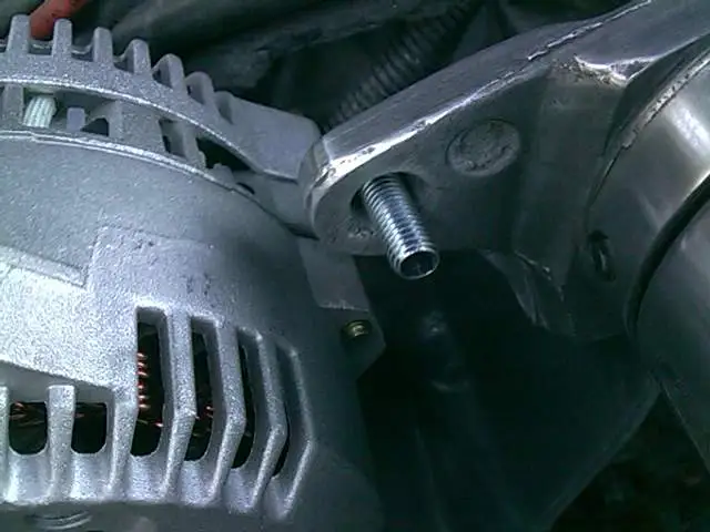

I have no idea what the march alternator bracket is. I never heard of it. Pic below, and yes, thats the stock tensioner pulley.
In the second image, you can see a vertical scuff made from where the bracket WAS preventing it from going over all the way. I just brought this up because it isn't mentioned in PA's documents. First I ever heard of having to scuff that down....was when I found out myself.

And this is the new bolt that fits the new alt on the upper side. Just wondering if this amount of slack will cause any issues later? Such as the alt sliding down more from vibrations and stress over time. If not , then no big deal. Just want to know what others think.

I didn't like the slop I had in the top mounting hole so I went to Ace Hardware and bought a bronze bearing and shortened it to fit the depth of the bracket. I later found that a door hinge bushing for a GM car would have had pretty close dimensions. I don't know why Ford cast the bracket that way.
Mine didn't have slack like that...the whole on yours looks elongated or something.
Another thing i'll recommend is instead of using a bolt AND nut, get yourself a bolt that's big enough to take up the slack and then tap threads into the alternator ear so the bolt actually screws into the alternator. I then put a nut on the back side just for good measure. This isn't really necessary but it's easier to deal with than needing 2 wrenches to tighten it up.
No, it's just the pic. Hole is perfectly round. i don't need a nut. The Alt already has threads in the ear. That's where that bolt came from, with the alt. I think it'll be alright. I'll fire it up later this week after i'm done with the wiring, and get a battery for it. I'll drop it back till it can't move anymore and see if that does the trick. Shouldn't be any vibration noise.
