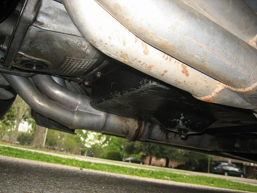

I somehow forgot to post a thread up over here regarding ground clearance with a 4R trans pan on our cars. For those that have done it, did you have ground clearance issues like I'm having?

Thanks guys. :nice: Davis3, I have the stock mount in there, though I do have a spare Prothane mount lying here. I should try to take a picture of it - the entire pick-up cavity is pretty much below my O/R pipe. I'd need a lot of upward movement in the trans to get the pick-up out of harms way.
Wes, as always, thank you for the reply and offer for a picture. I'm not sure if it'd help because you have such a different exhaust set-up. I would ask if happen to know if your pick-up cavity is the low point in that region. That'd make me feel better atleast.

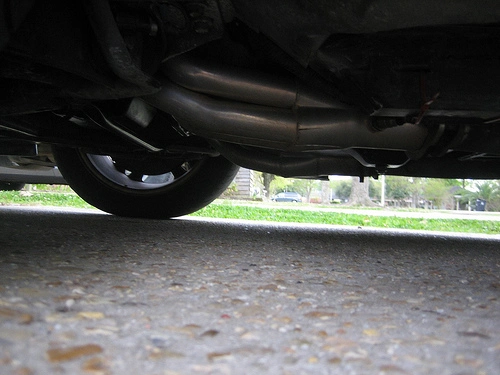

I have the B&M deep aluminum pan. It sticks down a lot further than the stocker, but I have never hit anything with it. I'll get some pics when I get home, because my laptop is not letting me attach files. I would imagine that this thing sits lower than the 4r70W pan.
There are a couple of mine. It is not as low as I thought - the headers will bottom out way before the pan will.

For future searchers, here's the 4R pan with a 94 AODE. You can see why I'm concerned with not having a skid plate or something to kinda protect it. I still haven't had a chance to figure something out.

I'm going to get some 4x4 pan specs and compare. I know my picture sucked but you can see having that hump hanging down aint no good on mine.
