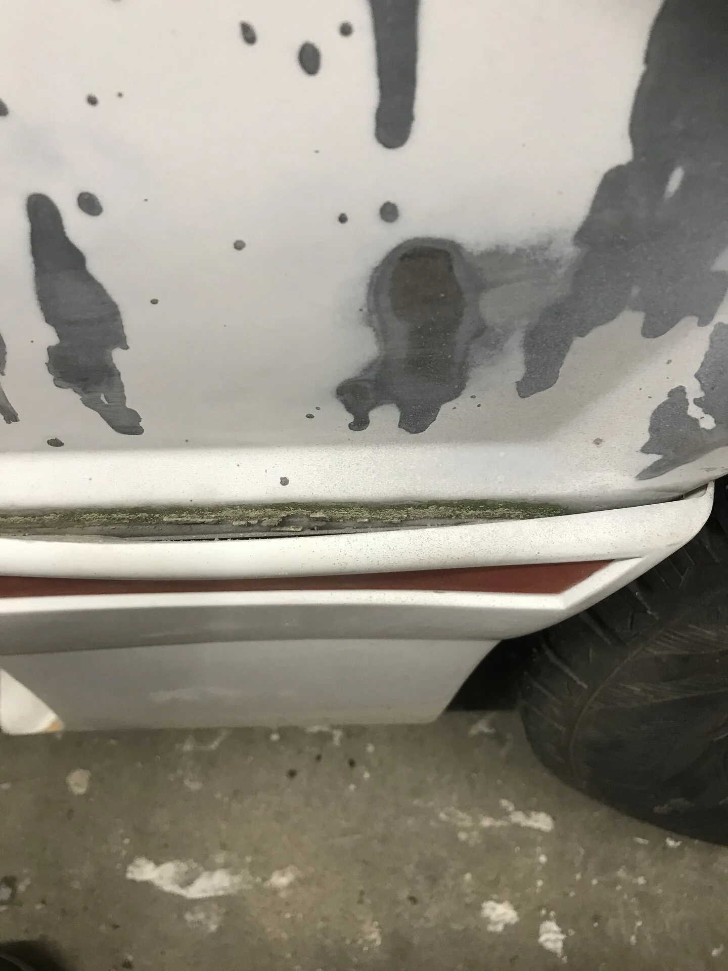

Now this pony has some surface rust issues along with clear coat so, painting is in the very near future. While we taking care of said surface rust, I noticed the ground effects were essentially pealing back from the body. I’ve researched a bit here and know the parts are backed by aluminum pieces and that it is not recommended to remove them...
How do I get them back in place?? I’m uploading a pic of the rear drivers side as an example. I thought at first I’d just use some 3m tape but it just seems so stiff!
Any thoughts?

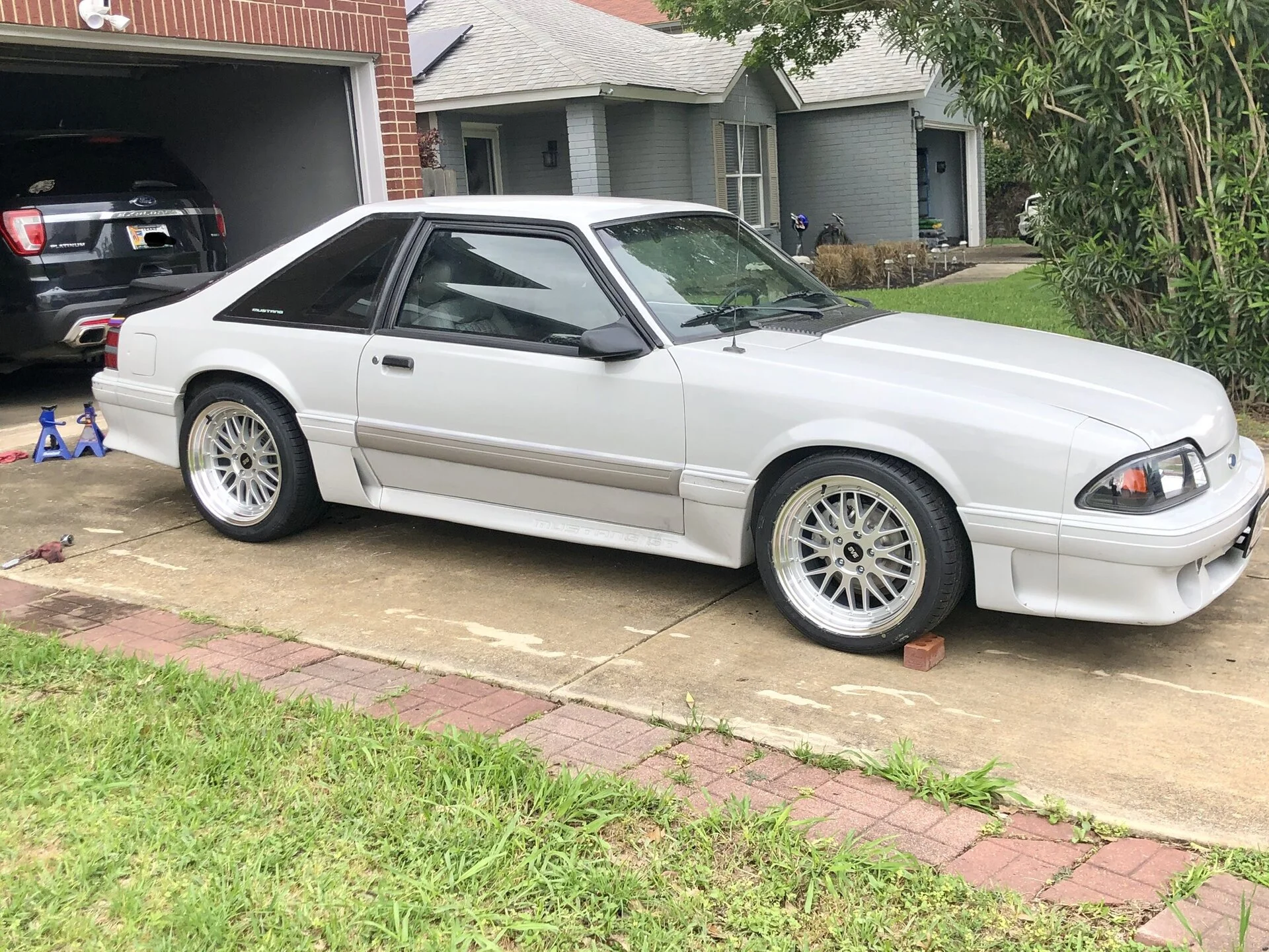

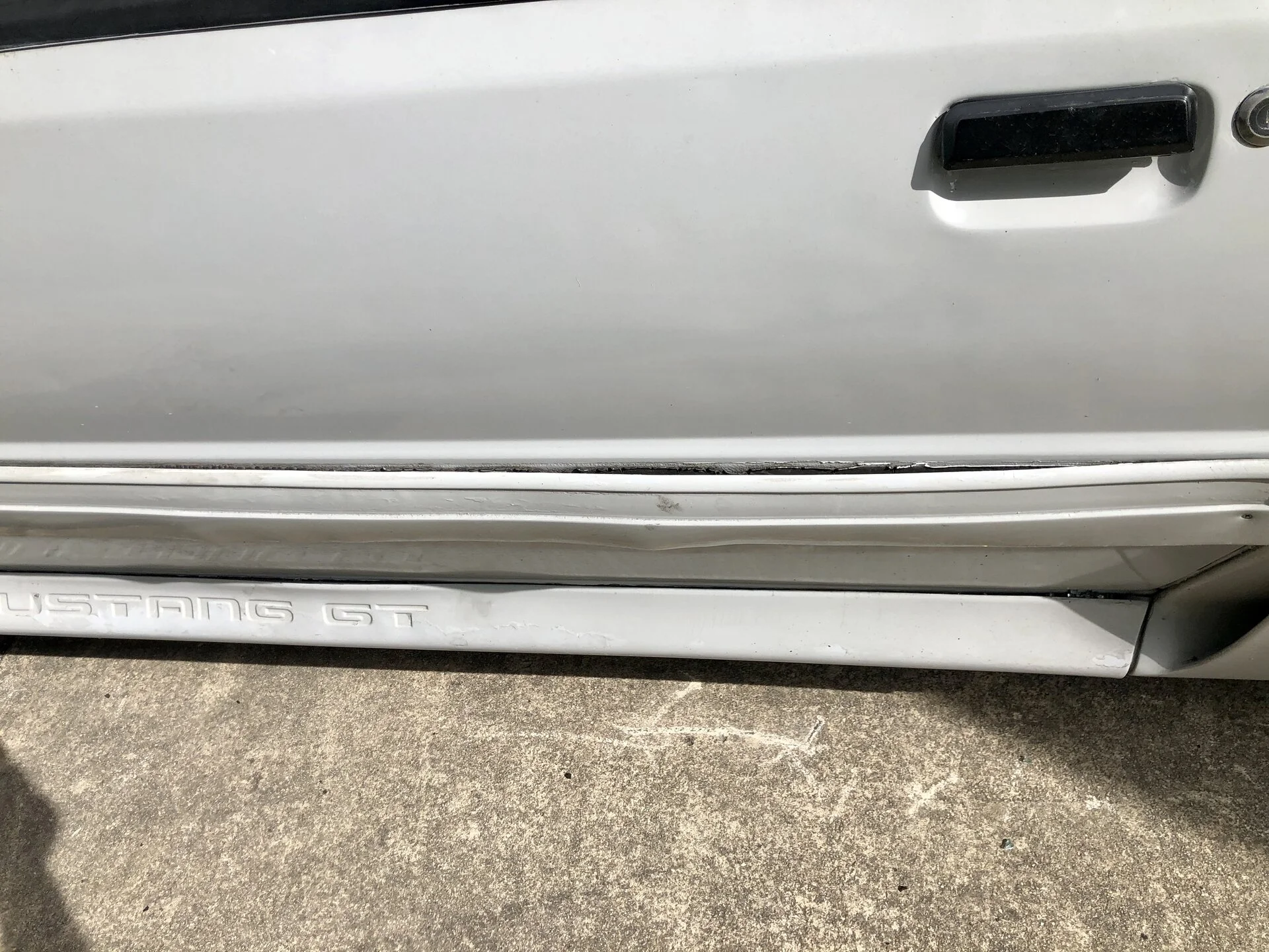

The door moldings on my 87 GT did the same thing. I pulled them off and put the new ones from LMR on. It was extremely tedious getting the 34 year old adhesive off the door, but the new ones went on with no issues, and look great.

In your first pic with the side molding in front of the rear tire, it almost looks like it has popped off the metal strip in the middle.
If you want to try and salvage your existing GFX, remove them and then set them on the ground faced up in the sun for a while and see what it looks like. Doing this you can also check condition of the clips at the same time. Removal of the long side skirt is removing the rivets/screws along the bottom then should be a screw or two in the wheel well. The panel you showed should come off with a little up and forward movement. The clips are vertical at door jamb and horizontal just below the body line.
When I reinstalled my GFX after painting I had to install them 3 or 4 times to get the skirt properly behind the clips. If your clips are rotted, I recommend the kit from LMR. Very complete and great looking parts.
Wow some awesome suggestions already! I’ll try and see if the heat gun will get back in place And hold with 3m tape. If not and the clips aren’t rotted, the sun is a great idea too.
