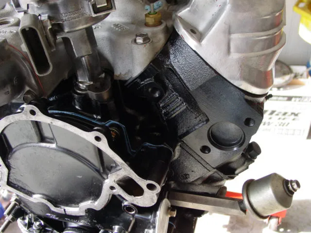

TC93 Well-Known Member Sep 11, 2000 2,075 1 57 Ellerslie GA 31807 Feb 13, 2006 #3 Feb 13, 2006 #3 On the front & back(where accessorries bolt to) of the head near the intake side there will be 3 or 4 verticle bars. 3 bars are normal GT-40's and 4 bars are the P's.. Here is a pic of GT-40's with 3 bars. Attachments DSC01769 (resized).webp 41.1 KB · Views: 247
Roland69 Sergeant Tangnet Sep 17, 2005 2,867 3 58 Port Elgin, Ontario Feb 13, 2006 #4 Feb 13, 2006 #4 3 bars=GT-40 4 bars= GT-40P's
