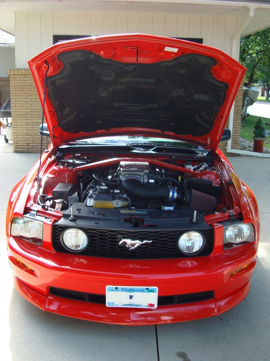

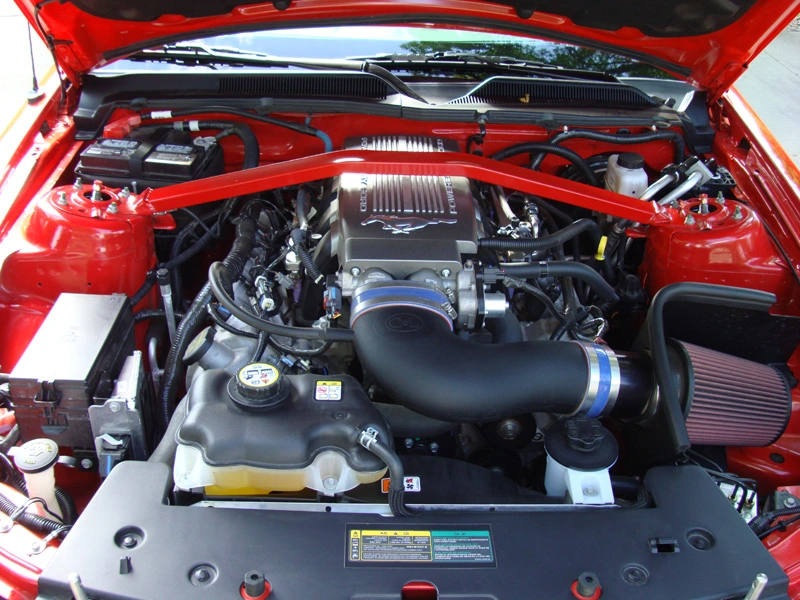

Here is a picture of my engine bay.
If you look at the end of my strut bar, in the middle of my strut towers, you will see some red caps. I take them off and inside there is the allen key. I can adjust the front there.
The rears are a little more difficult, way in the back of the trunk, they make extensions to make it easier.
