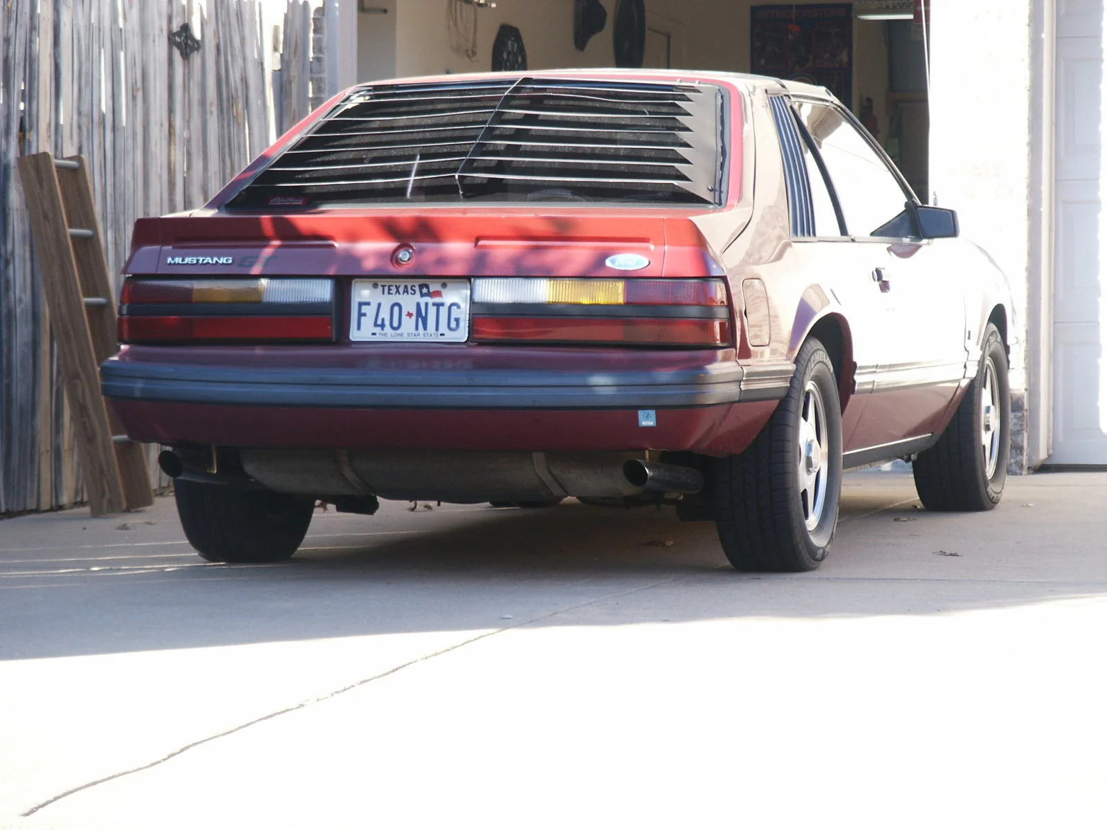

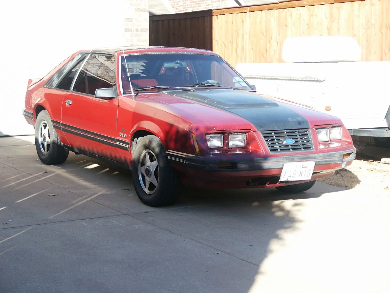

Agree 100% with FoxChasis above. Here is what my '83 GT looked like before I painted it. Faded GT sticker on hood (black center portion). GT sticker on both front fenders just above the 5.0 badge and a GT sticker on rear hatch spoiler just to the right of the Mustang badge.
