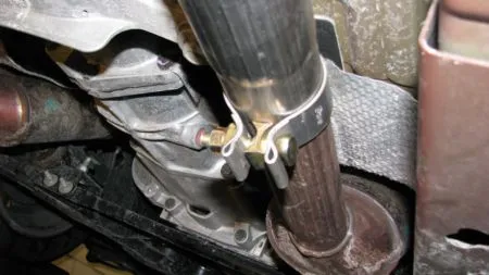

I did this same modification in December. I have a BBK CAI also and went with the Pypes True Dual Exhaust Cat-Bak w/X-Pipe and Stock GT mufflers. Swapped the stock single outlet valance with a Roush Dual. My local body shop swapped me the new single outlet valance for the labor to make the swap. Well worth it since the "old" valance had no value to me. The exhaust install was simple. Cut the stock "Y" pipe according to the instructions and it's a bolt on. Everything fit perfect.
Sounds great. Not "yappy" in the neighborhood, but sweet when you stand on it!
