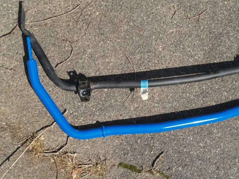

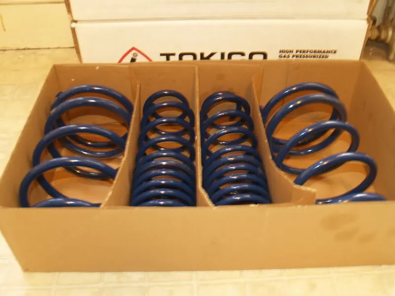

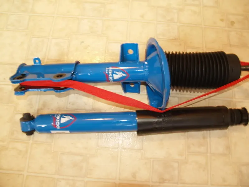

and for the hell of it my suspension parts.
i still have to do the panhard bar and rear sway bar. im waiting on rear end link for the sway bar. i havent had a chance to really test the suspension. i just got it done yesterday and its been raining since.

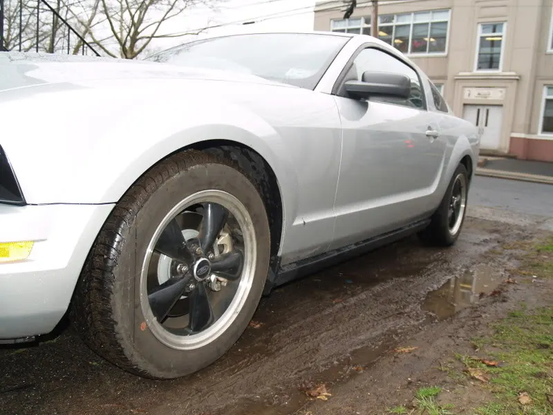

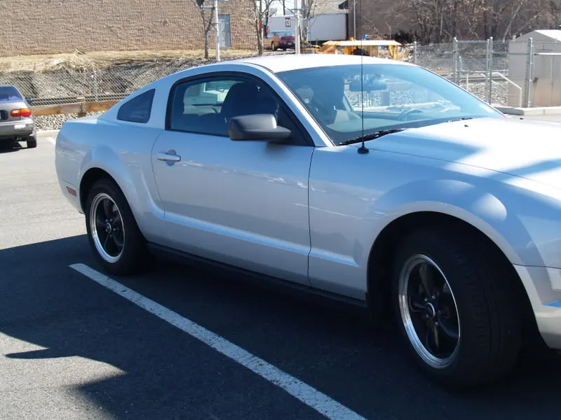

totally forgot while im at it. before and after shot of the ride height.
before
after
i think its a perfect drop not ridiculous, but almost all the wheel gap is gone.
