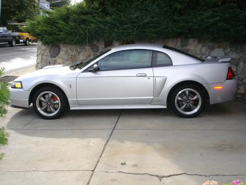

That's what i did. I got the Mach 1 brakes which were plain black but i painted both the front and rear red to match
Looks really good. Did you use the spray on caliper paint or the one you brush on? Any problems with flaking or discoloration?
I did the rotors with spray on since they came bare for some strange reason (OEM 99+ Brembo rotors). Since they were new, i didn't know where the area the pads would make contact would be, so i painted about 1/2" into the swept area. When i tested the brakes the first time, it wiped the area clean but made a jagged "tear" where the line of paint meets the bare area. I tried to trim it a bit but i don't like the result. That picture shows the good rotor, but the other side has a few tears i don't like. One of these days when i'm bored i'll tape a solid line off now that i know where the pad contacts and spray it again.
As for the calipers, i used the duplicolor brush on kit. I did the rears on the car and they came out fine, but I did the Mach 1 calipers off the car since you need to take them apart to really paint it right.
The first coat came out a little wavey, so i sanded them smooth and did another few coats and it's much better.
I had my stock GT calipers painted for 2 months with no probs with flaking.
Just be carefull when putting the wheel on. I accidentally hit the caliper with the inside of the spoke when mounting the wheel and put a chip in it. I touched it up but it's not as smooth as the rest. You won't see it unless you get close.
I've sprayed the brakes with water and done about 100 miles of driving on them. No probs with paint flake yet, but i think it's too soon to tell
