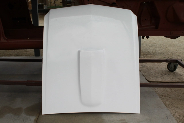

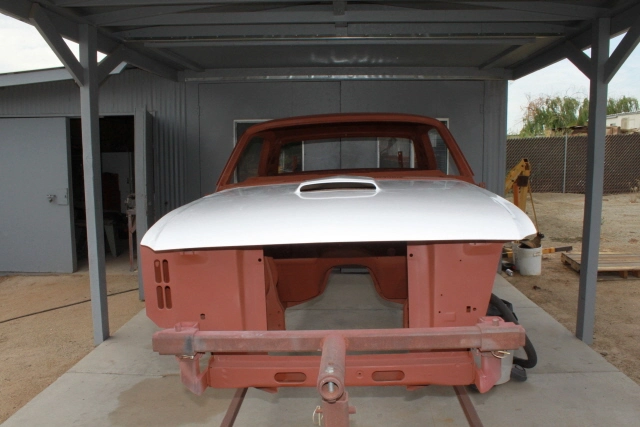

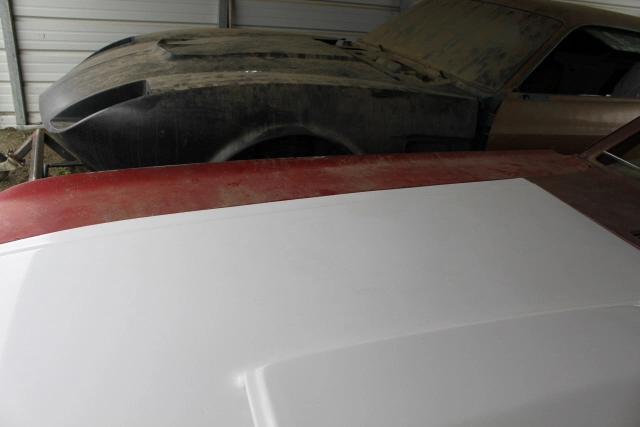

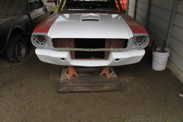

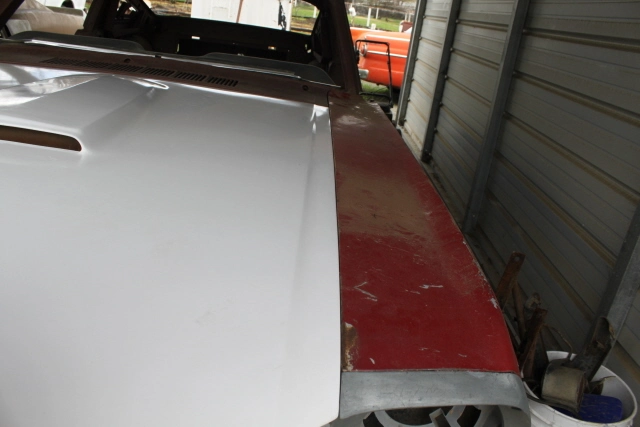

the last couple i have bought were from stang-ahloics. they are very heavy made and fit quite well. i have used about 5 of them and no issues.never had to use any bondo just a good block sanding. just recently bought one for my nephews 64 1/2 and a buddies 65 fast back along with a R model valance. they follow the fenders very well.
they are fiberglass top and bottom. i have had bad luck with the ones with metal under structure .fiber glass and steel expand differently at different temps and sooner or later the bond will fail .the hood in the pics is just setting in place not bolted and it looks great

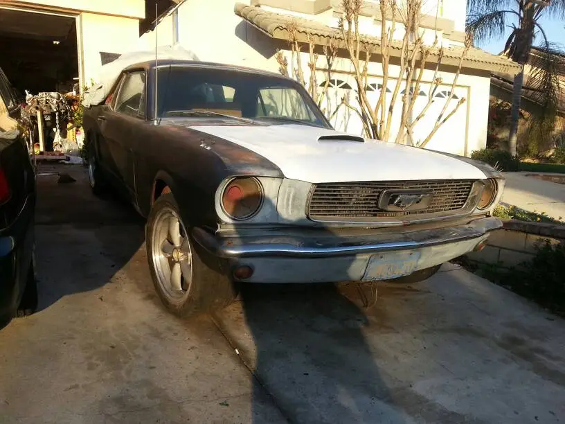

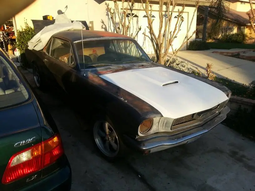

I got lucky found a local guy who makes them..picked it up brand new for under $300 New..fit is great
