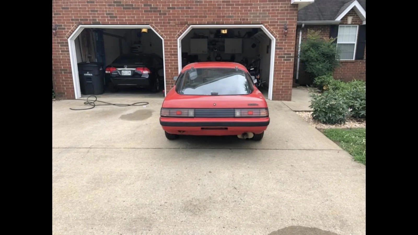

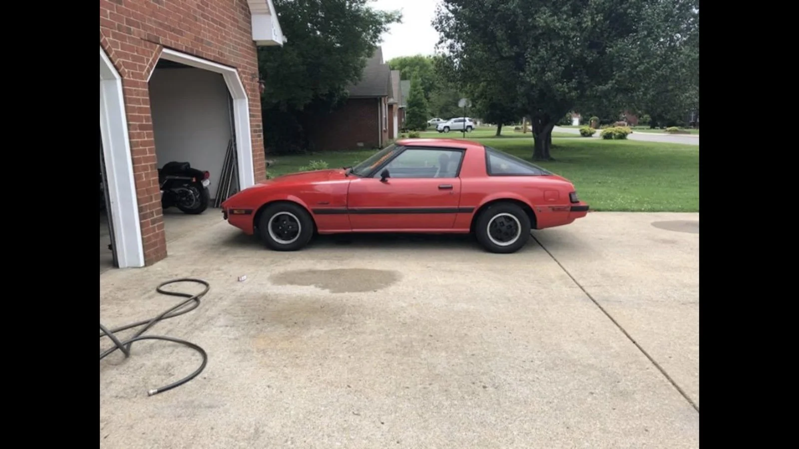

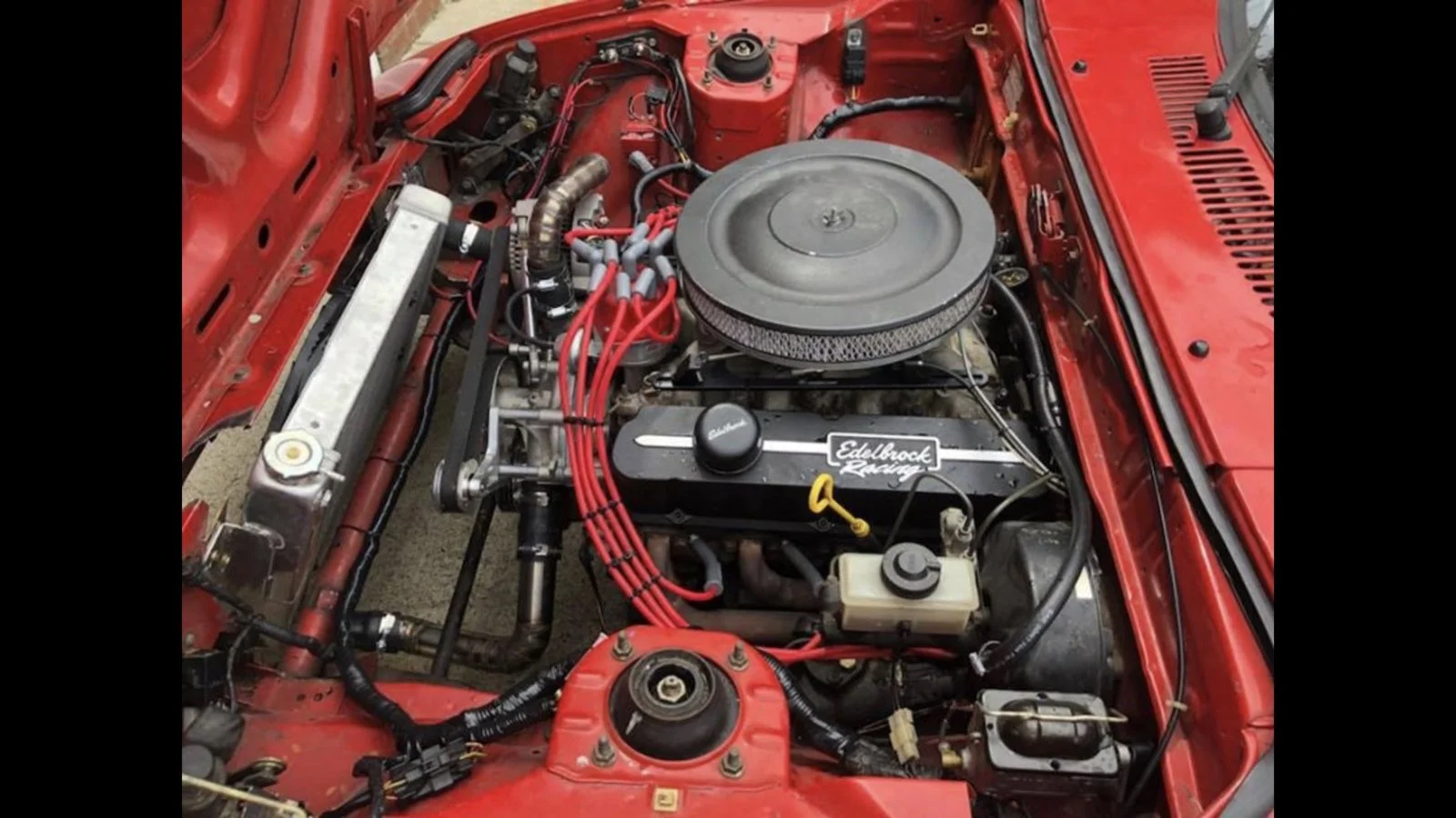

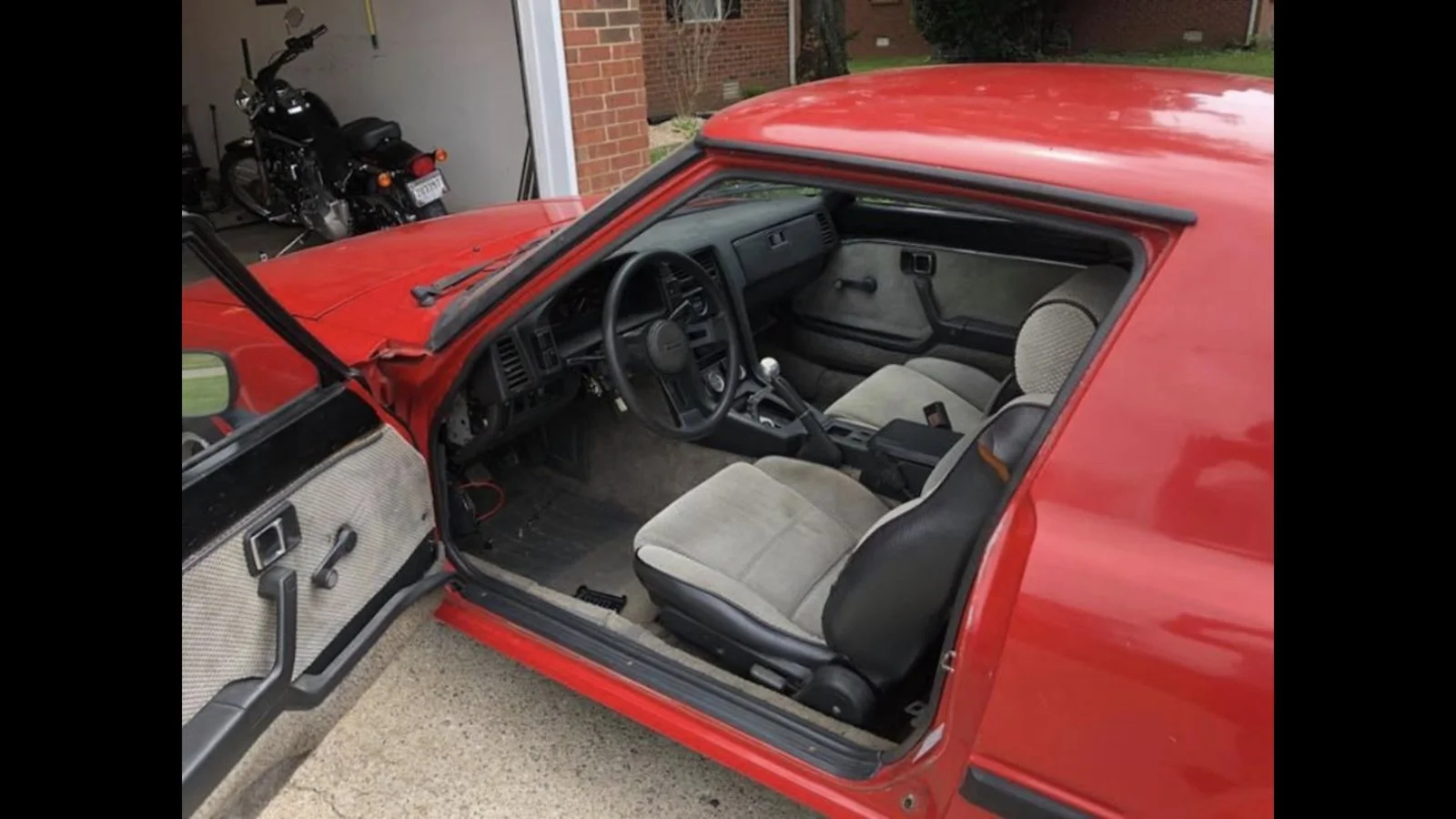

Here you go guys, my buddies and me call it the frankenmazda 5.0 Like I said it’s just a non HO paired with a tremec t5. I have a 8.8 lsd/5 lug disc brake to go in it with the gt40 motor. I should be able to start the new build after the new year
