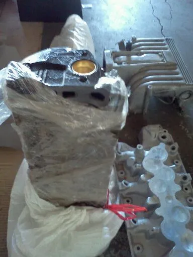

I found a set of rebuilt gt40 heads 3 bar and the upper and lower as well.
I'm paying 450 for them?
Tips on doing this setup?
First time dealing with the gt40 setup and didn't want to run into some stupid problem!
Can I assume regarding the heads that "rebuilt" also includes a valve spring upgrade as well? If not, count on sinking another $100-$150 into the heads for a set.
