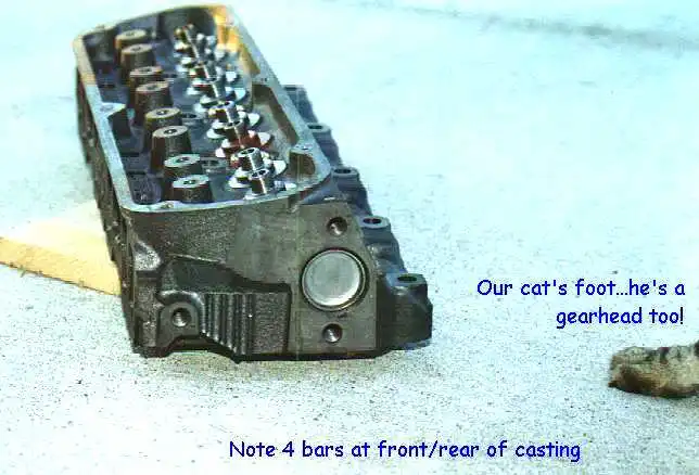

ford racing and mac both make p specific headers. i have mac equal lengths which i definately dont like. i had to beat some pretty decent dents in them to make them morw as well as use a 90 degree plug boot on the 3 and 7 plugs and accel wire sleeves to keep from burning them up monthly. if you look aT the ford racing p specific header they just changed they way the last 2 primaries go into the collector in order to be able to run a standard plug wire without them touching the header. kinda sux you have to pay an extra hundred dollars for a simple fix like that but i have every intention on switching to a p specific header as soon as my wallet allows. also if u can get a hold of 93-95 cobra heads. GT40 not gt40p's the spark plug angle isnt changed and therefore requires no special headers. look for the missing P designation and 3 bars instead of 4
