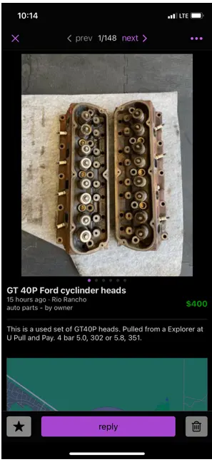

I posted this in another thread I had and that's probably confusing to someone who hasn't ever opened it before, so I started a new thread. Anyways, I saw some GT40p heads on Craigslist this morning for $400. I'm thinking with the upgraded springs that will have to be added to that price and whatever a machine shop charges to go through them that it may not be worth it at $400. I seem to remember something had to be done with the headers when installing these. What do you guys think?

If those are off the truck, i wouldn't pay $400.
The upgraded springs alone are $150-200ish
The spark plug angle makes header application tricky. Typically you just need to run 90* boots on two cylinders. I forget which ones.
Pretty common upgrade, i just don't think i'd pay that for them. I know prices are up on everything, but pre-covid i had a set for sale for $100 and couldn't move them.
Save a few bucks more for some aluminium heads, the Ps work good with the upgrades but not much room for spark plug boots, shorty headers clear better than long tube headers.
i've had a set that I bought new years ago, I'm using them on the Junk Pile.
P heads I wouldn’t pay more than $250, unless they come with rockers and have aftermarket valve springs already installed. If you can talk him to $250 I’d slap some valve springs on them and put them on a car. Tfs makes a drop in set.
5L5 is correct in you have to use a couple 90* plug boots and terminals, so keep that in mind. Bbk Long tube headers are what I used on a customer car, and I had to use 2 or 3 of them. Not a big deal if you’ve got a plug terminal crimper.
Standard gt40s go for around $400, but the p’s are less valuable.
